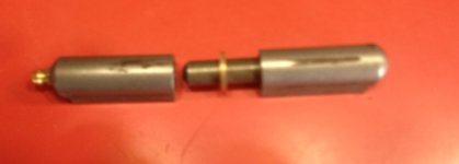

Anyone ever use this type of gate hinge?

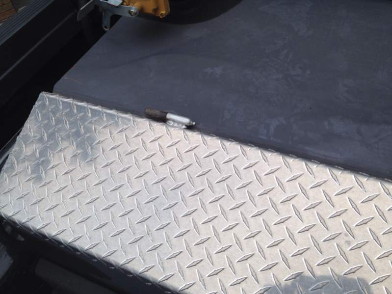

I've used weldable hinges but not for gates. I would imagine large ones for that application might prove cost prohibitive. Lots of other options available.

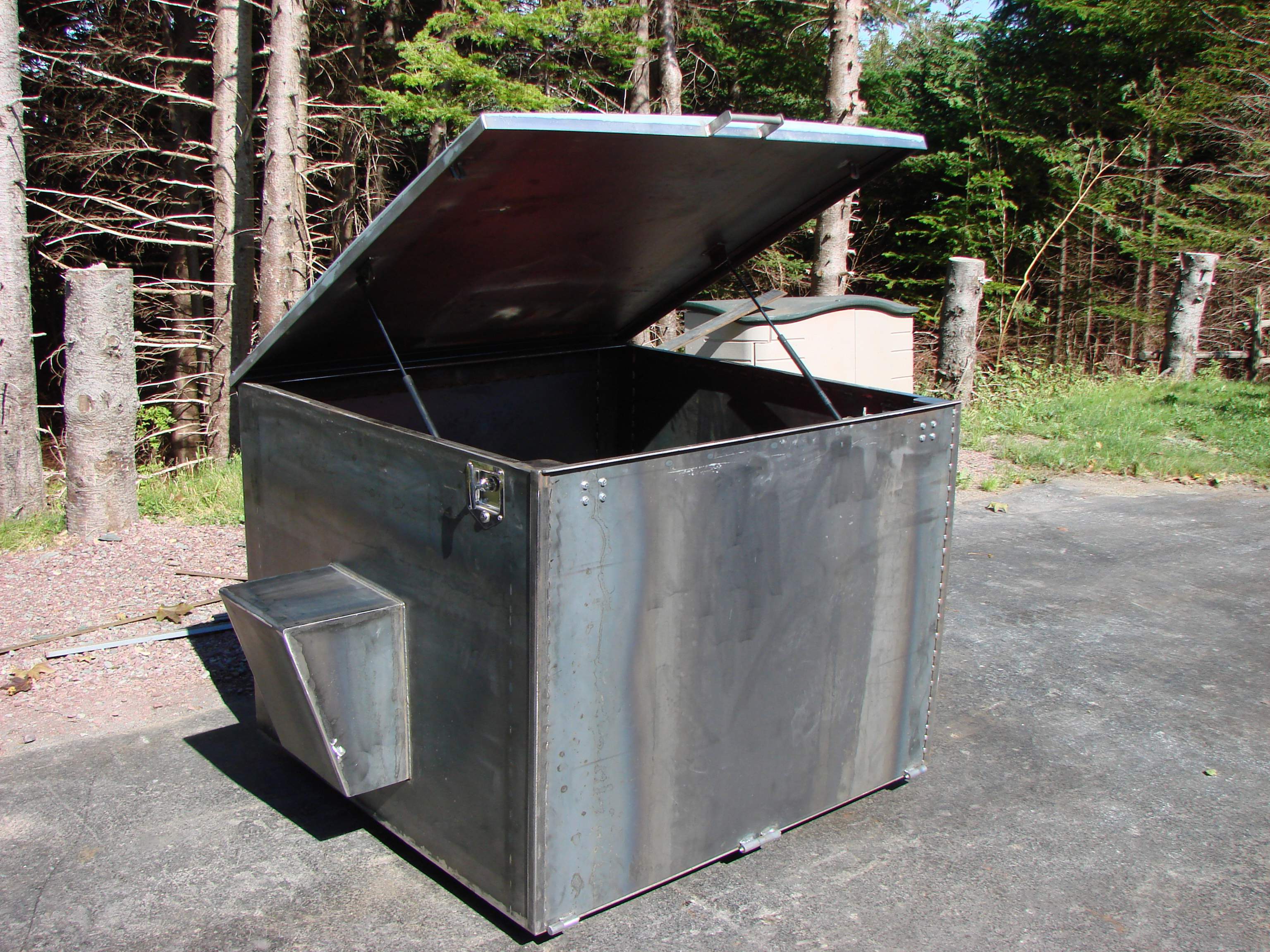

To attach an aluminum checker plate tool box lid to my steel fuel transfer tank I purchased one aluminum hinge and one steel, then mismatched them.for welding.

If you do use this type be sure to keep it well greased/lubed.
Have seen some where opening a gate or steel door that has been not used for a time will tear or ripped the hinge from the weld...
Not a problem if the hinge gets used often.
/ Gate Hinge #4
Used these on my heavy blast booth doors. I think these would work excellent on a gate.
/ Gate Hinge #5
We used those pretty much exclusively on OI gates. What you want to do is match the hinges to the post and hinge end of the gate before you build the gate, much easier to have just one end to deal with than an entire gate.

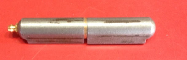

They look similar to these that I use ... They also have a ball bearing
Barrel Hinges - 5"

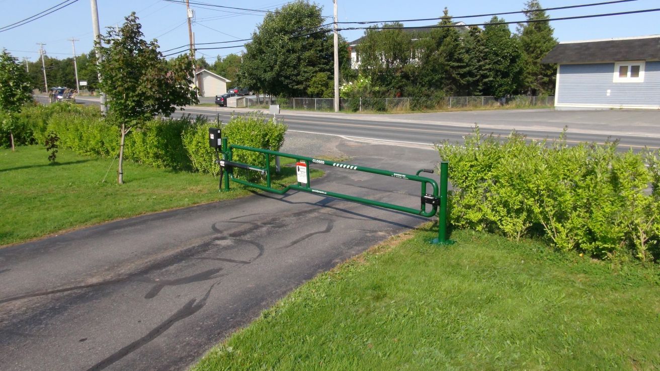

The problem with that type of hinge is that a security gate can just be lifted off the hinge when you only have a two piece hinge. For flat services like a loading dock, one can be turned in each direction to prevent shifting, but on a horizontal gate that is not the case.
/ Gate Hinge #10
My gates have two, the top and bottom supporting the load and the middle one reversed so there is no way to lift off the gate without first taking out the middle hinge.
/ Gate Hinge #11
With a zirc fitting you should be good. Replaced a bunch of those on road crossings because someone installed the hinges without a zirc fitting. I would do like ultrarunner suggested and put the middle one the opposite direction from the top and bottom for security. Like others stated, keep them greased. You can free them with a zirc tool designed to force penetrating oil in them. But that tactic is hit and miss.

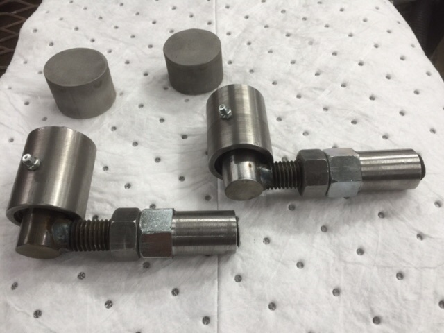

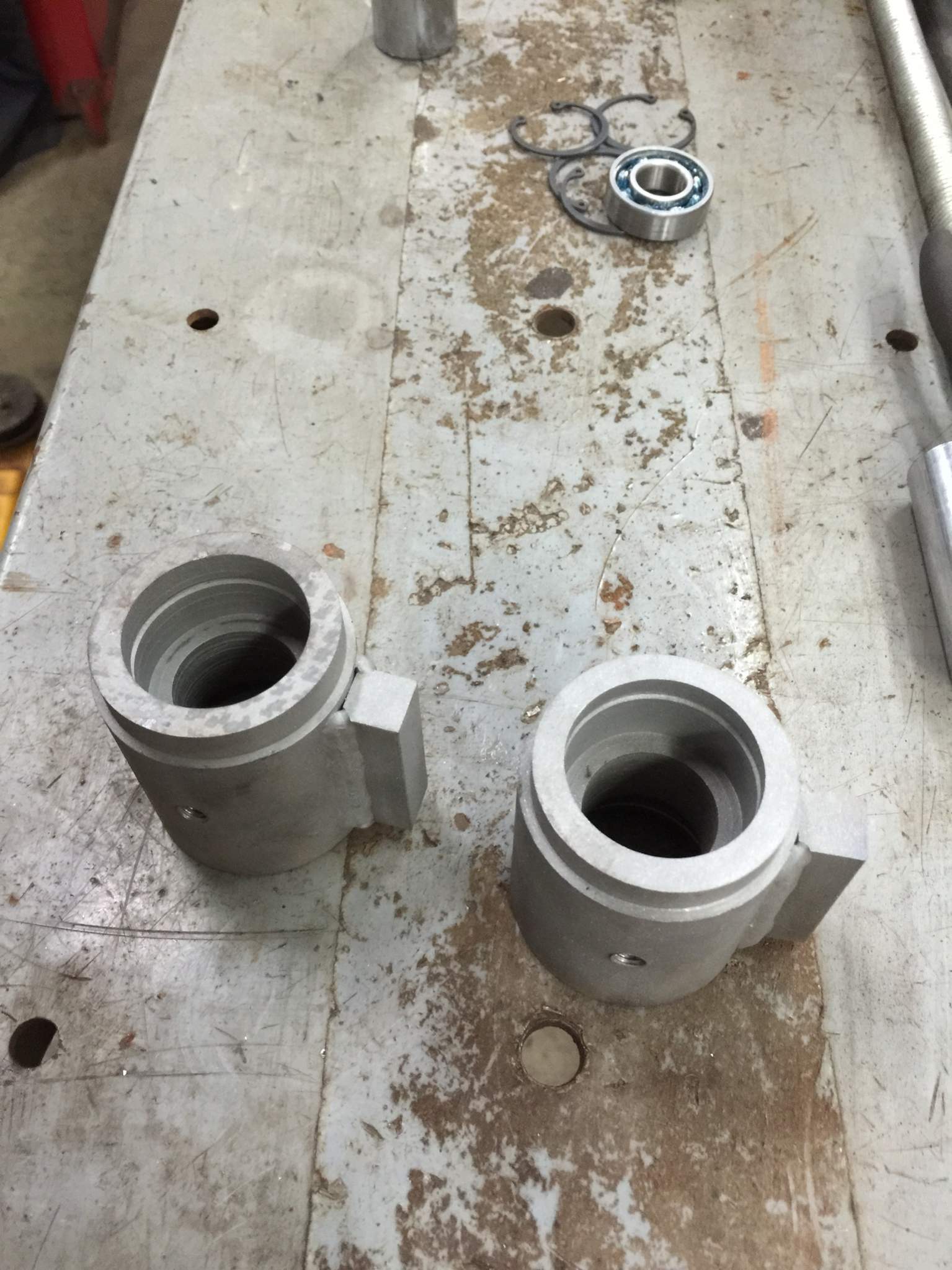

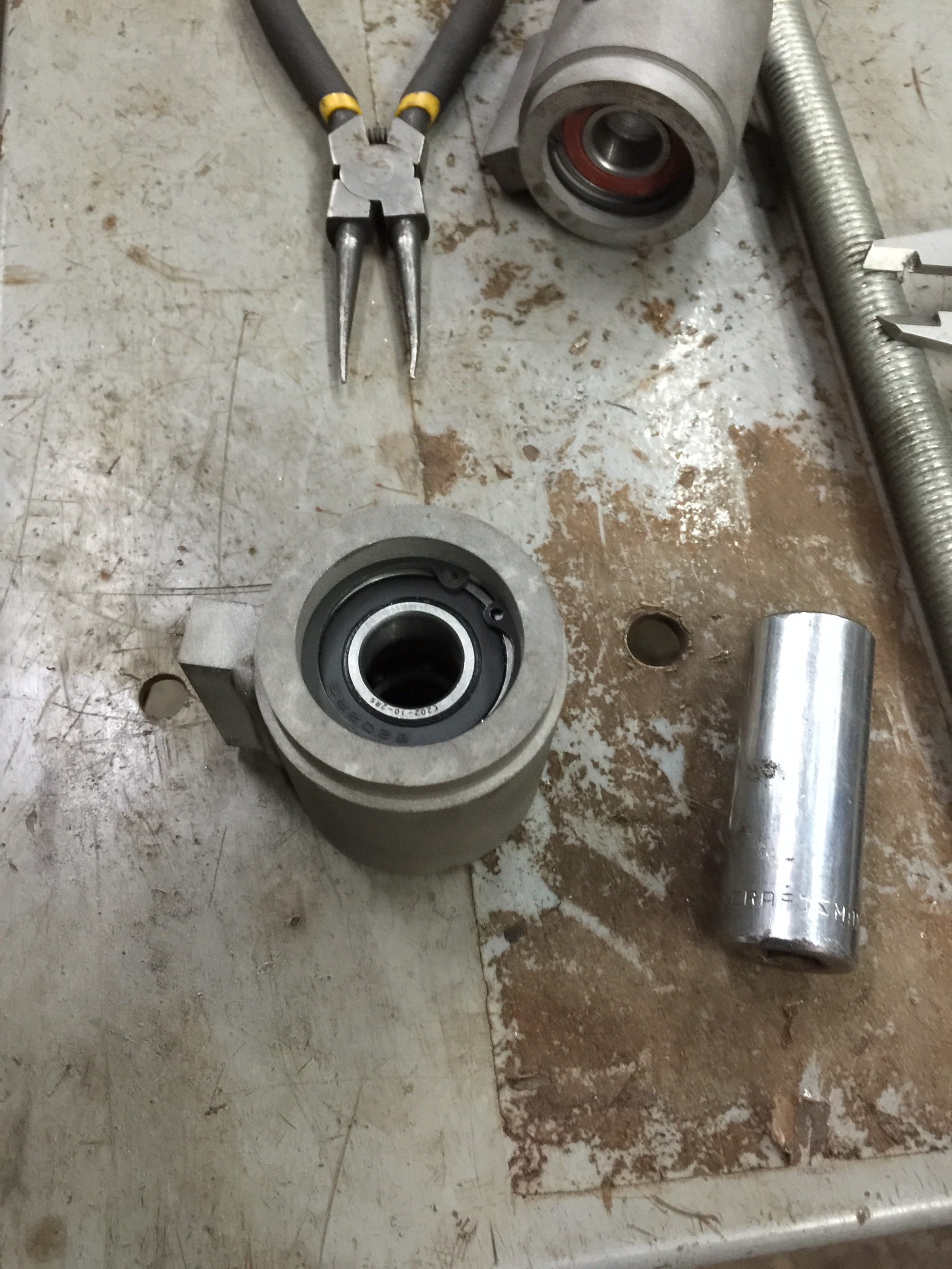

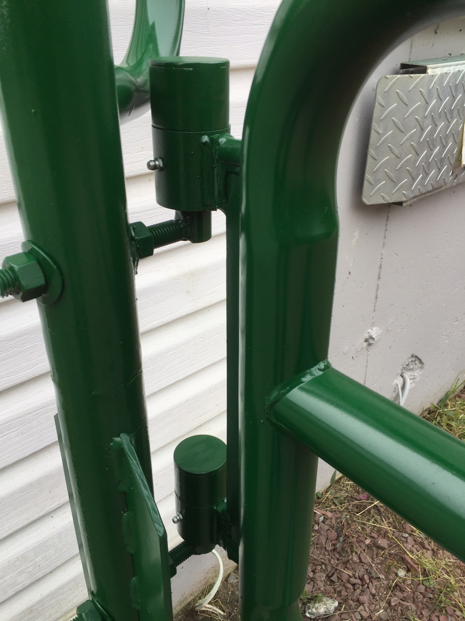

I used those hinges on cabinets that I use indoors. I make my own. Pretty easy to do that if you have a lathe. This summer I put up two new out door gates with auto openers on them and I wanted a hinge that was heavy duty, smooth running, greasable and long lifespan so I build a couple of these. If your gate is really heavy this might be an idea you can use. They are designed so the gate can't be lifted off either. Just something to think about.
Impressive. What's with the two slugs in the third picture?

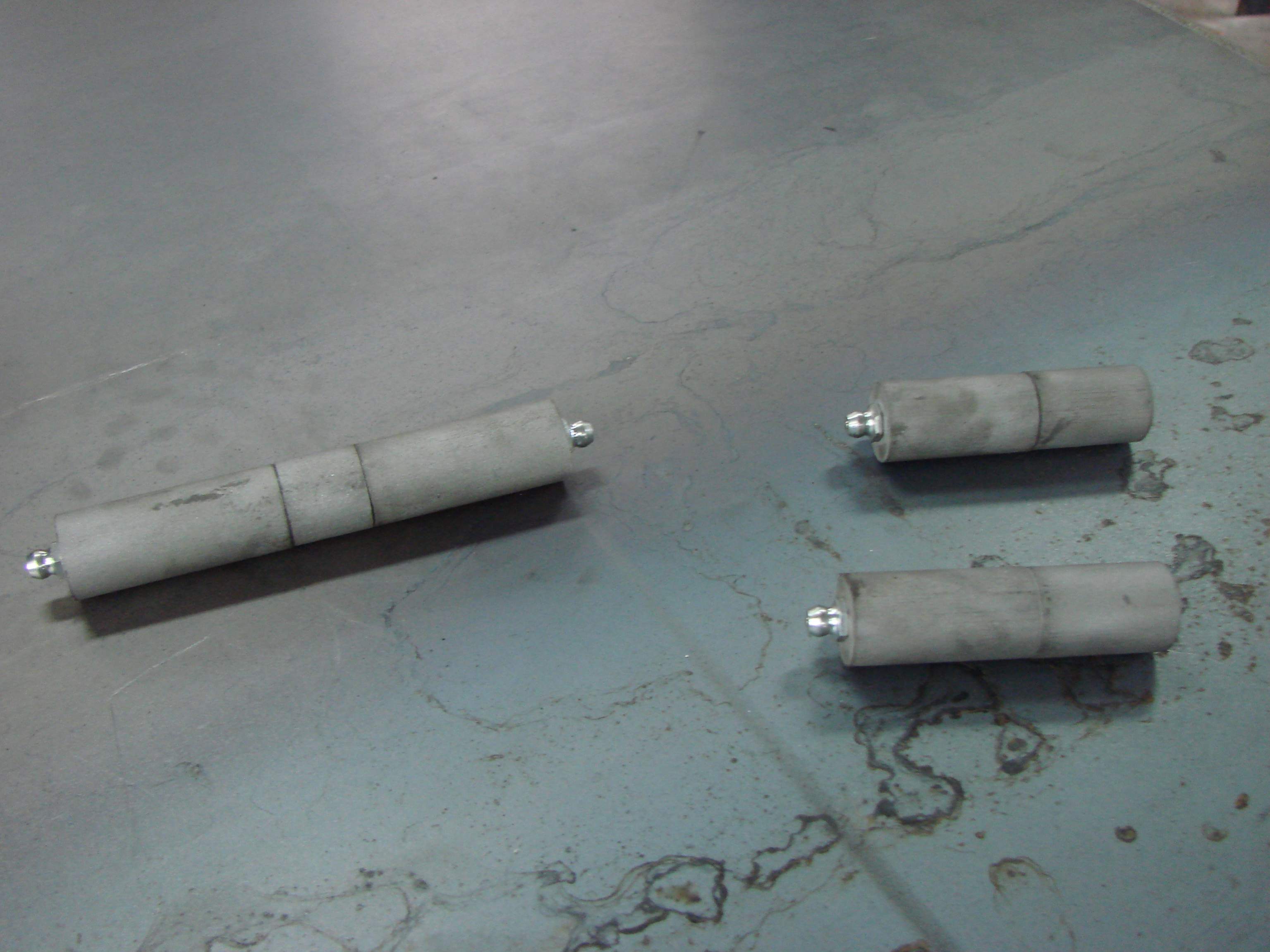

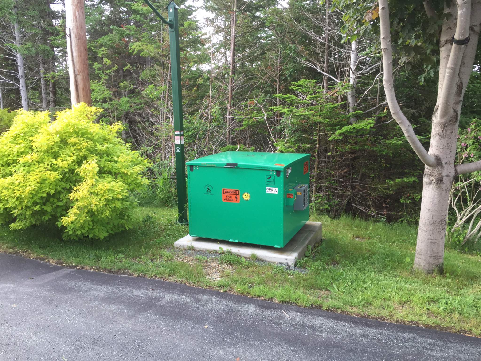

I've also machined weld on hinges as shown in the OP photo. Used them on a generator enclosure I made. Worked well.
