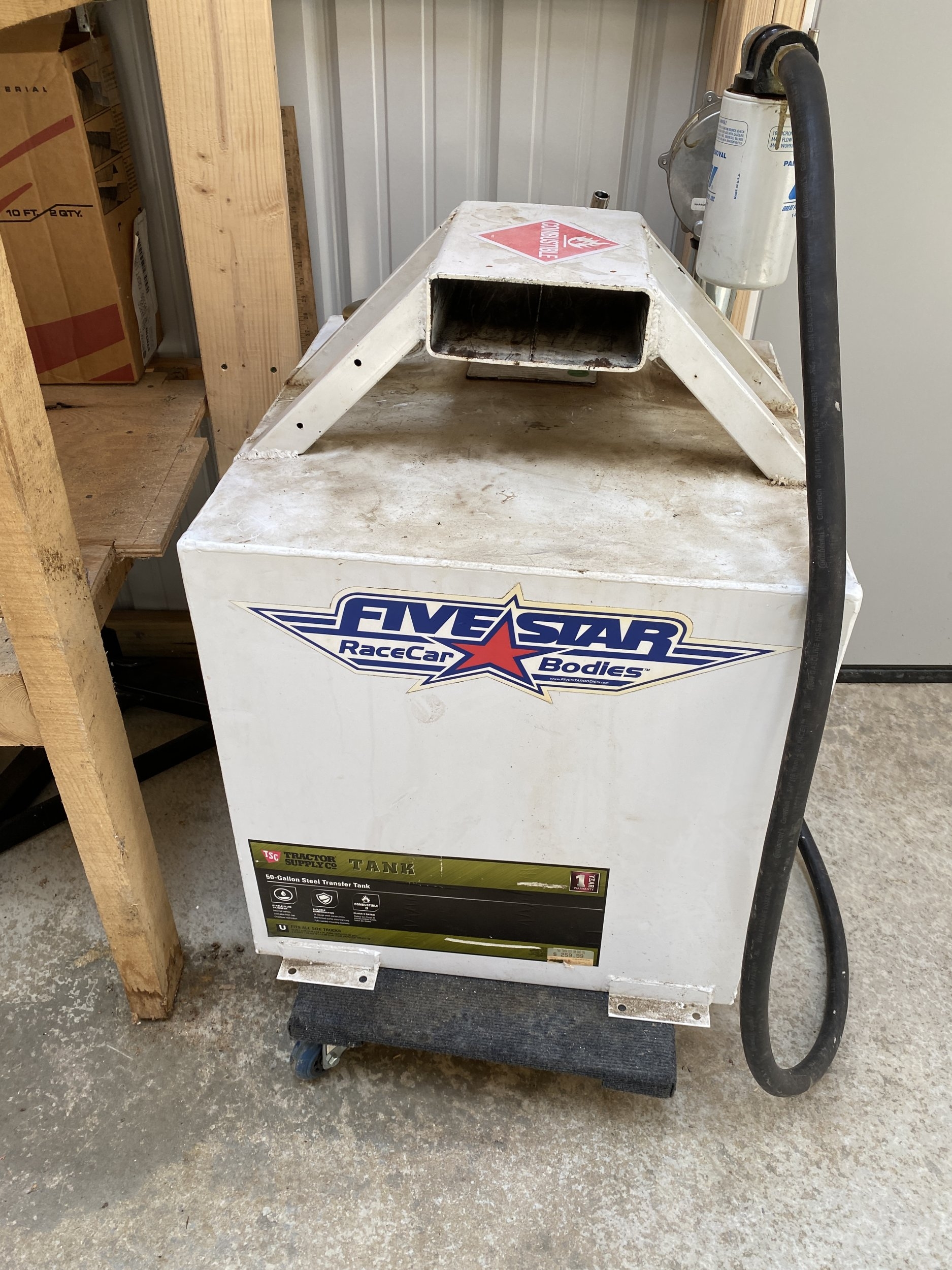

I have two 50 gallon tanks with fill-rite hand pumps, one for diesel and one for ethanol free gasoline. I welded a piece of tube to a riser that lets me handle the tanks with my forks, well one fork. Easy to load into my pickup when it’s time to fill them. I set them on dollies, so they are easy to move around.

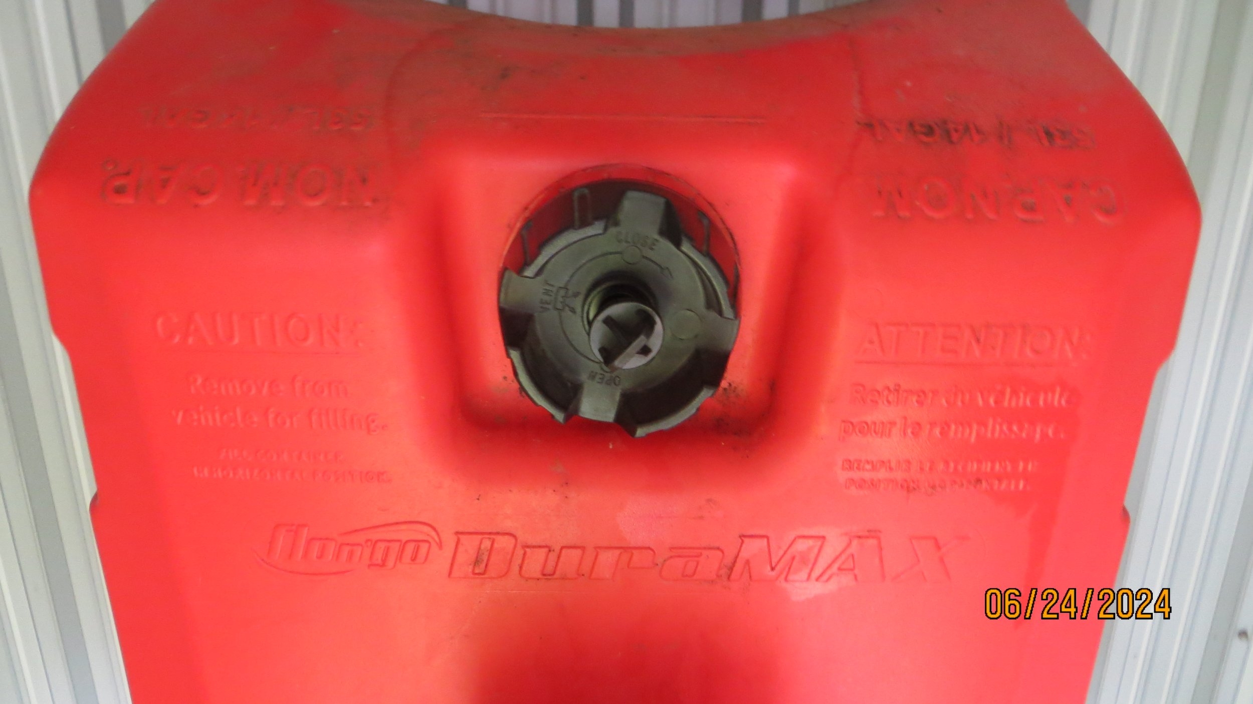

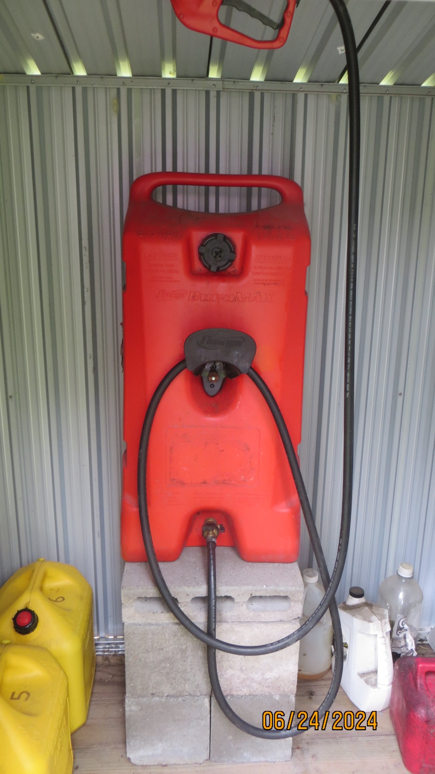

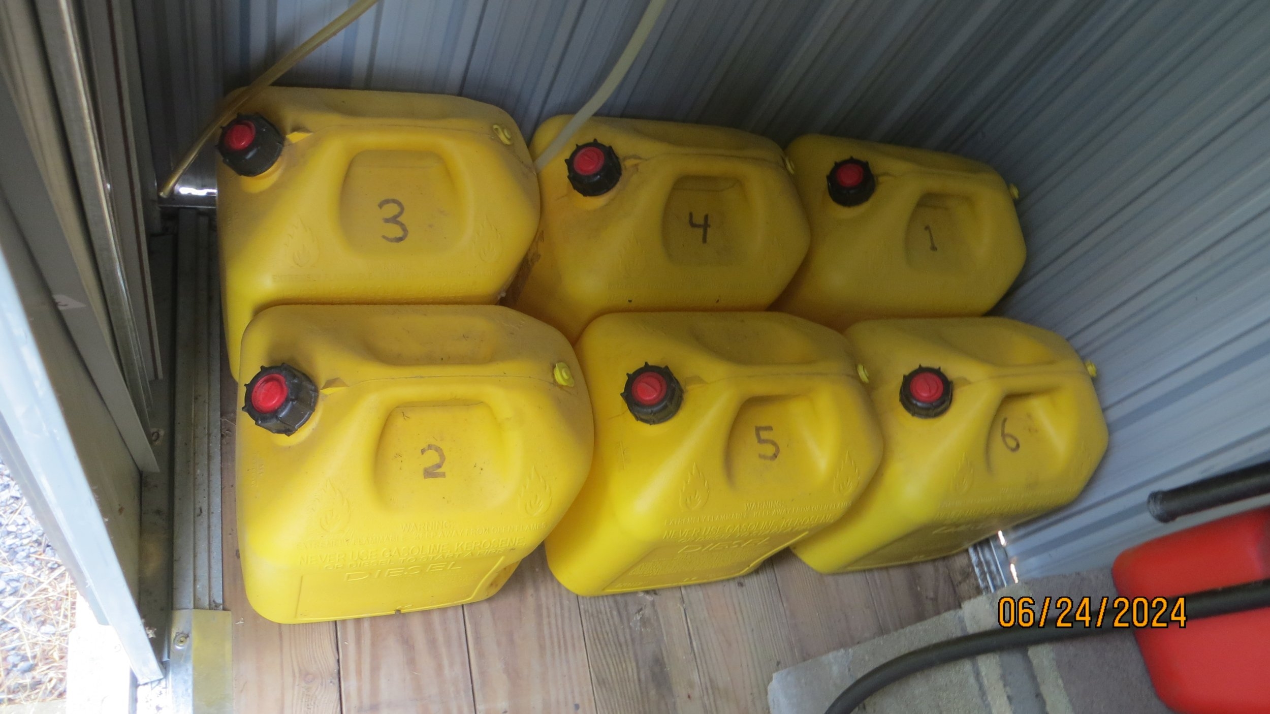

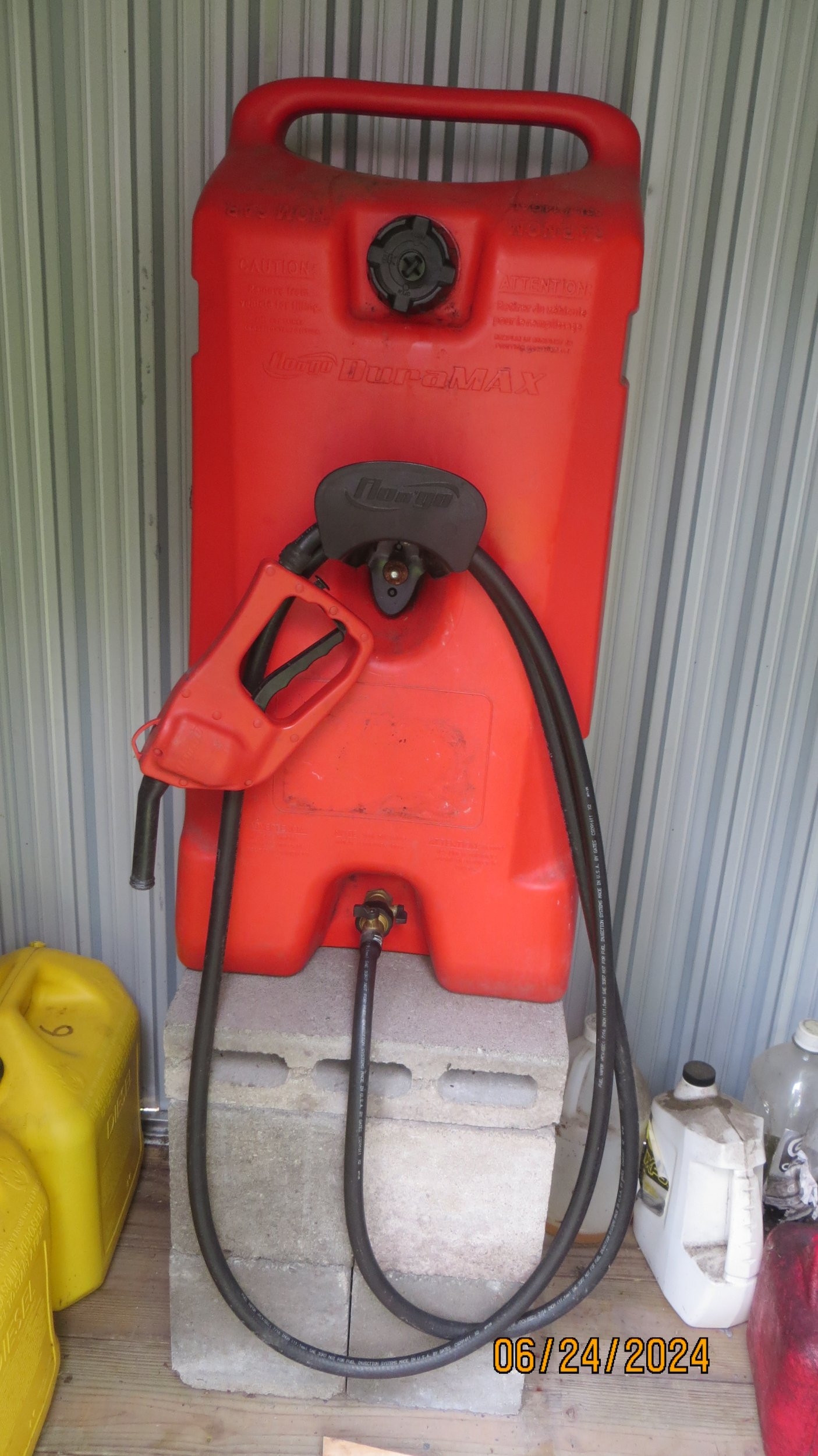

What do you guys do for any thing more than 5 gallon cans? I wanna get something bigger but seems most things are rated for diesel and not gasoline. I was thinking of something like these. Amazon.com
I bought this 14 gallon gas (can/container) about 10 years ago. The only problem I had was that the hose disintegrated and I bought a new hose at NAPA.
My problem is/was getting better diesel cans - but found these on sale at Tractor Supply.
I treat all my gas and diesel with the appropriate fuel supplements for gas the Blue Marine 360 Sta-Bil. And for the diesel I use EDT 6 in 1 Diesel Treatment and TRC DZL-Pep w/AAT.
"+" in the winter I also add Power Service Fuel Supplement CetaneBoost & Hot Shot Secret Diesel Extreme.
It sounds and looks like a lot - but I have never had it not start on me. It always starts on the first try of about up to 2 seconds duration on the key. Usually instantly when the key is turned on to start.
Also year-round I have a battery maintainer on when the tractor is not in use. - same battery since new in Jan 2018.

Watch Craig's List or Nextdoor, or whatever you use in your area, for a used boat or other tank removed from a piece of equipment. I have both, and have them sitting up high on pallet [which I put in the back of the pickup when filling them] sitting on a tote, but any high support will do. My 20 gallon tank was something removed from a piece of equipment, is heavy, so is mounted to the pallet. I have a hose with a quick-connect on them, and a ball valve on the end. I drive my ride-on mower up to it and just let it gravity feed into the mower, or whatever else I need to fill. Of course, use a priming bulb to initially fill up the hose, but once it's full, gravity should do the work after that. A boat tank is made to be portable, and can usually be found used at a good price. I use Stabil Marine360 in the fuel when I first get it, and the fuel sitting in the forklift, and have never had a problem, even with the atrocious CA gas. The Stabil Marine version is stronger and seems to work better and longer. On the pallet, I've never had a problem filling or anyone complaining about filling the larger tank sitting in the bed of the truck.
