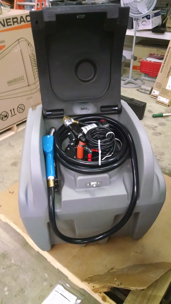

What do you guys do for any thing more than 5 gallon cans? I wanna get something bigger but seems most things are rated for diesel and not gasoline. I was thinking of something like these. Amazon.com
/ Gasoline storage #2
If you look up the individual specifications below that page, it shows that that tank is diesel rated ONLY.
Very odd that the description says gasoline. Its my understanding that those 12v pumps are not designed for gasoline. I know when i bought my 50 gal poly fuel tank with pump it specifically says not for use with gasoline.

/ Gasoline storage
Yeah the first one says good for gasoline in multiple places but almost every other one I can find says diesel only. I really don’t know what the difference would be but I’m kinda iffy on the putting 50 gallons of gas in something that could very well be not made for gas at all. Anyone know what the difference between a gasoline one and a diesel one?
/ Gasoline storage #4
I suspect it's more a matter of certification of the tank itself, vapor recovery, and pump construction rather than the tank material itself.

I use these 14 gallon plastic caddies rated for gasoline, biggest I can still manhandle when full. I use gravity feed not the cheap handle pump. Had them over 5 yrs never much of a problem I own two and were pretty inexpensive back then, and I own, a non pictured gasoline rated metal with a manual vane pump it's 35 gallon I painted yellow and use solely for diesel. If it's a steel tank/nozzle used for gasoline it needs a ground clamp hooked to what your filling.

Its possible that the gas would dissolve the gaskets in the pump

#13
On mine its the pump itself. Its not rated for volatility of gas.
So maybe I could get a diesel tank and change out the pump rated for gas?

I have two of these. One for gas, one for diesel.
Same here, I have both strapped to a pallet to fork them in and out of my truck after filling.
I had to upgrade the cheap OEM hoses to real fuel hoses after 1 yr as the hoses on the gasoline side got brittle and started craking. While upgrading the hoses, I added a Goldenrod water block particulate filter to each.
Both hand pumps are still working on mine, but my brother had one go out on him after just over a year.
I store mine outdoors with a tarp over them, haven't had any issues other than the hoses.
