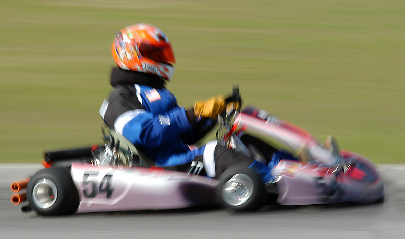

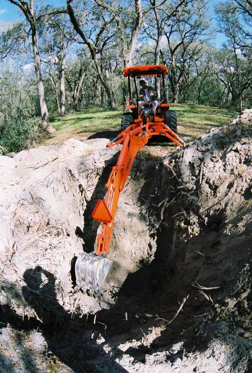

   / Gas vs Diesel Hp vs Torque #40
I have a high performance one cylinder water cooled two-stroke racing go-kart that puts out 40+HP @ 17,000rpm and does 115 MPH.
My question is, should I remove the three cylinder diesel engine from my Kubota L-39 and install the go-kart engine to pick up a few more horsepower and more top end speed? :eek:
