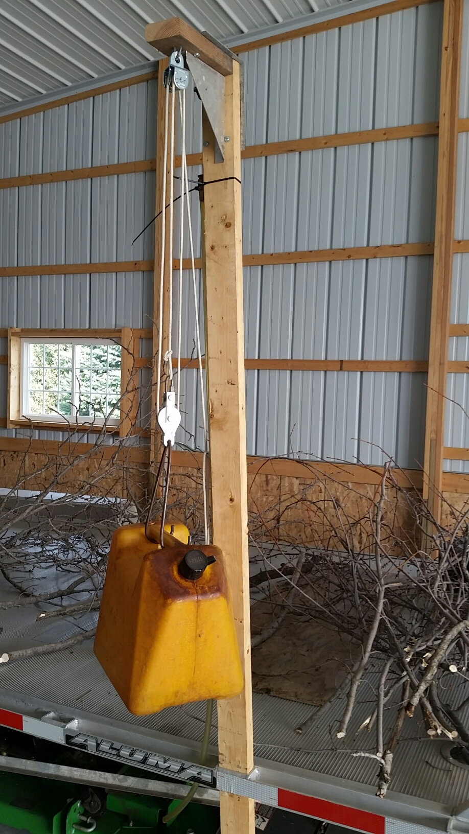

How about a portable arm-crane with a 3-to-1 pulley? Slip the 2x4 into your trailer and hoist up the can, then fuel up with a shaker-siphon.
