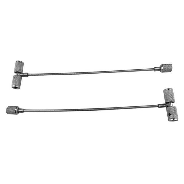

A metal tire valve stem works great for a vent. You just have to remove the valve core.
Cool idea, how do you get it installed seeing I assume you need to install it from the inside. Or maybe I don't get how these work.
You guys are losing me. We are talking about an install in a plastic jug. One drilled hole and a snap on (from the outside) plastic vent is easy peasy.... oh and it works with a flip of the finger. Removing the valve core? :punch: :stirthepot: :banghead:
   / Gas cans - really #172
- You drill a hole in the back top of the plastic can.
- You put the tire valve core installation cable into the hole, fish it out of the gas can filler.
Doesn't everyone have one of these tools? :confused3:
- Screw the new valve stem onto the core installation tool and pull it through the filler and out the new hole that you drilled.
- It snaps and seals into place, just as it would on a tire rim.
- You remove the core valve with the slot on the valve cap, no tools needed.
(you all know that the little slots on the top of the cap are a valve stem removal wrench, right?)
- Now you have a screw cap that you can remove for a vent.... until you drop it! :laughing:
Yes, the little plastic yellow snap in cap is much easier and you won't lose the cap. I agree. But this is much more complicated, costs more, and looks much cooler. :thumbsup:

I put one on my 3 gallon sprayer cause I got tired of pumpmping it up. Drill the hole where you want it. I fished some multi strand wire into the hole and out the fill opening. Remove the valve core , thread it on the wire and tie a knot so it can稚 be pulled through the stem. Pull the wire and valve stem out the hole. Little silicone or dish soap helps.
   / Gas cans - really #174
Not really my idea, I saw some you tube videos of using a valve stem as a vent I just wanted something that would not leak.
I drilled a hole and fished in through the pour opening and then threaded it down tight.
they make push in ones with an installer 'tube'

Ha ha, I do not have one of those tools either. Fishing through with a wire makes sense, I forgot you could remove the guts so that the wire could go through it.
