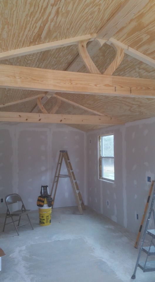

#25
Ceiling and beams are stained. We went with Minwax in Puritan Pine

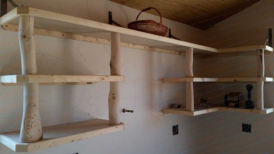

#26
For the shelves, I wanted something open, and easy to see what's up there. Basic shelves seemed kind of boring to me, so I'm trying something new. I bought some shelf brackets and welded them up to make them stronger, then mounted them upside down on the top shelf. I also ran a bolt through the shelf and the bracket to make sure screw threads would never pull out. Then the lower shelves are hung from that top one with branches that I cut from a downed oak tree. It took a very long time to get them sanded how I wanted them, but the result was worth it.

/ Garden Kitchen/Processing Room #27
:thumbsup:!
/ Garden Kitchen/Processing Room #28
A+ on the shelves Eddie.
/ Garden Kitchen/Processing Room #29
Eddie PLEASE delete the pic of the shelves, If my wife sees it i will be building shelves just like that, but with some minor change that wont take much to do. Just :laughing: I really like the shelves and I likely will be building some. Ed
