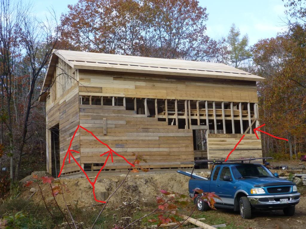

Front of garage has boards diagonally because of two doors that are close together, theres no way to have 2x6s to go diagonally between them, I figure that it adds strength against wind, and along the sides I have 2x6s going diagonally between studs.
Arrow's point to inside diagonal studs.....
Back in days before world became plywood & den wood chips er cardboard diagonal T&G on horizontal studs very usual in high wind country. Also done on old multistory wid vertical "balloon" studs. Real carpenters recessed diaphram bracing into outside walls. Hung second floor joist on sides of studs too. Lot of faying surfaces & proper diagonal nailing. Dem de houses still standing after hurricane blows plywood places away. Proper connection delivers strength.
