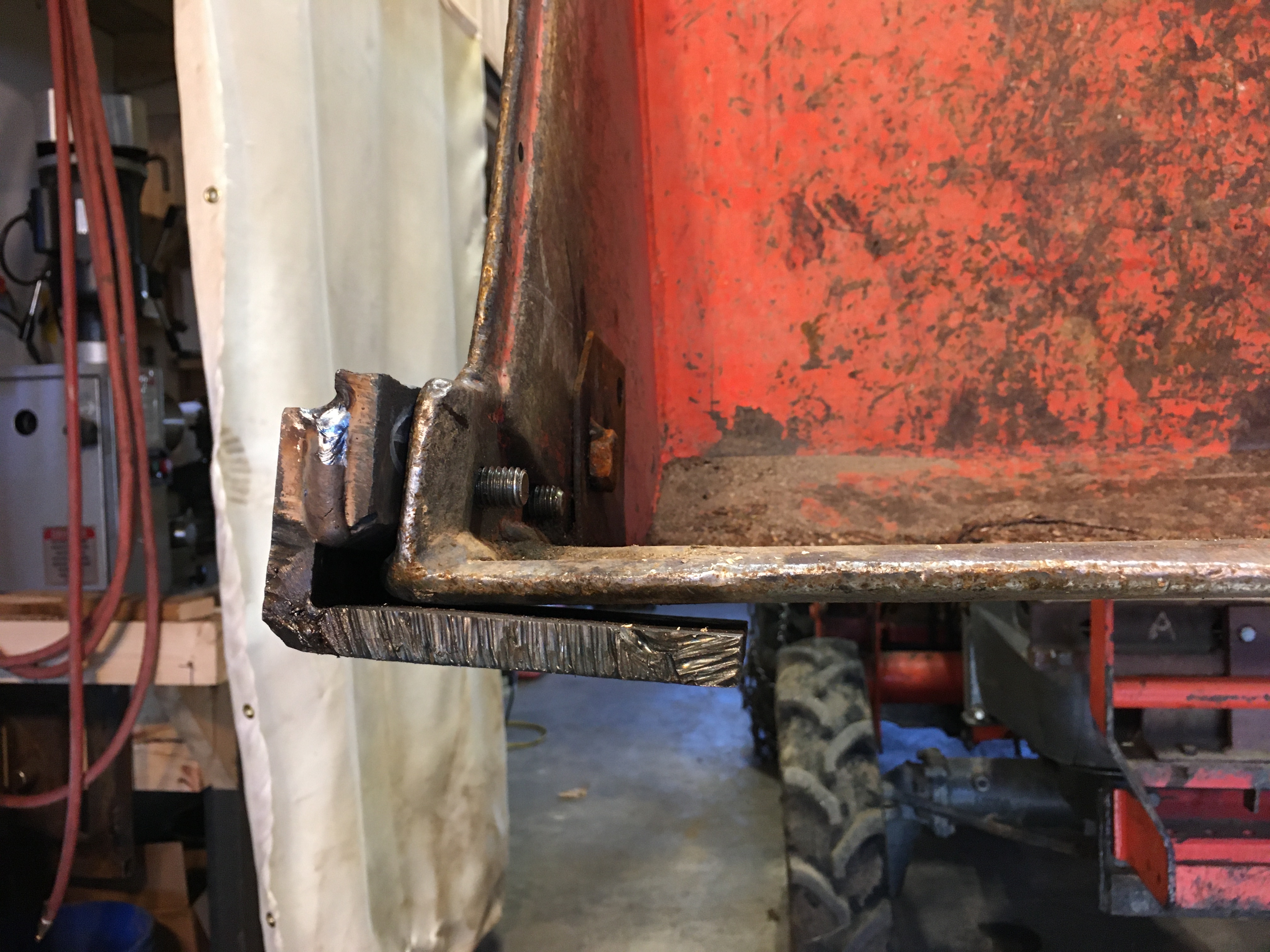

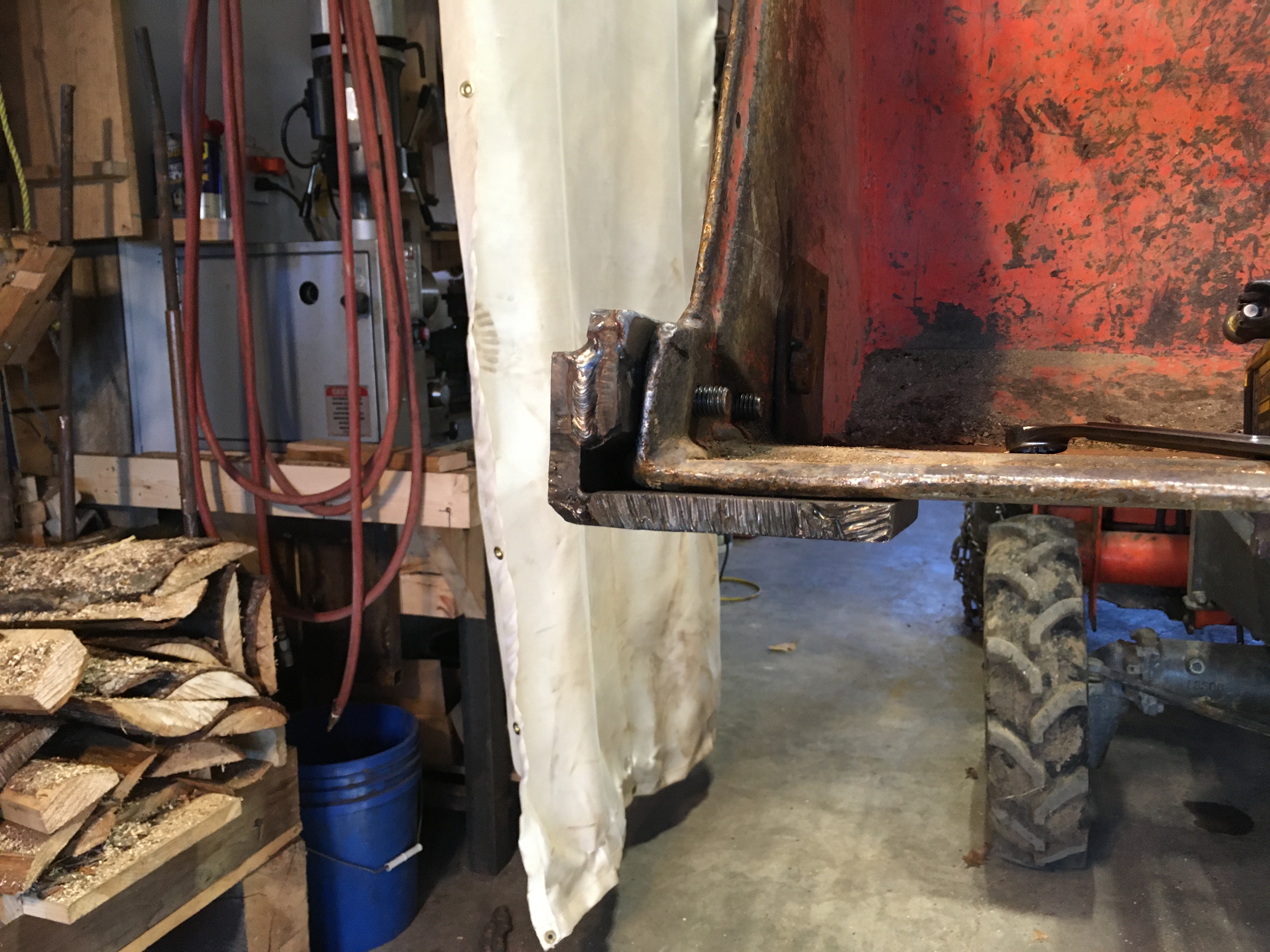

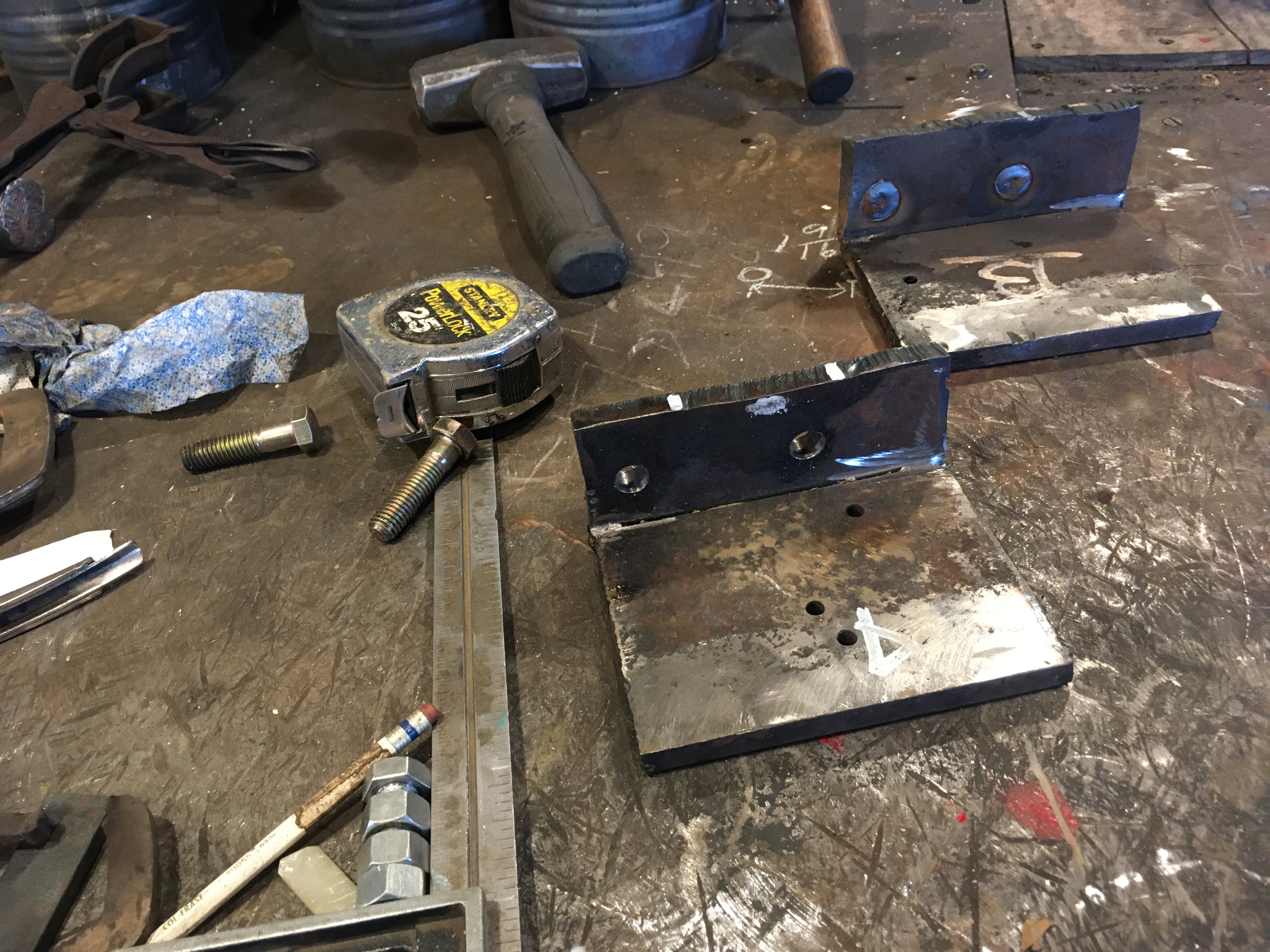

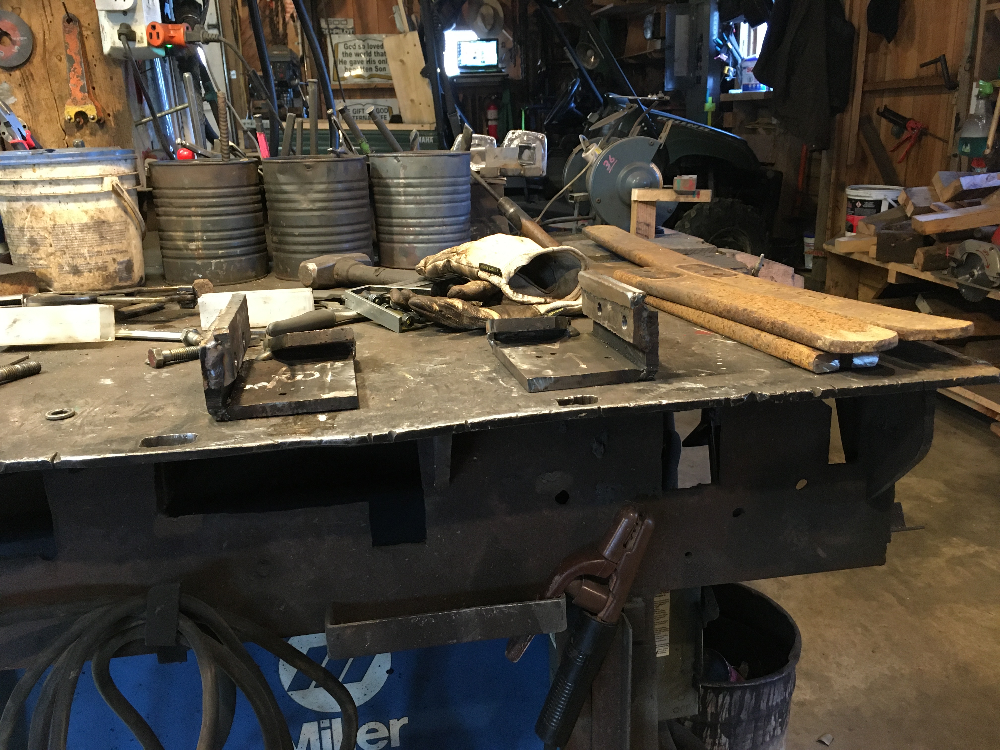

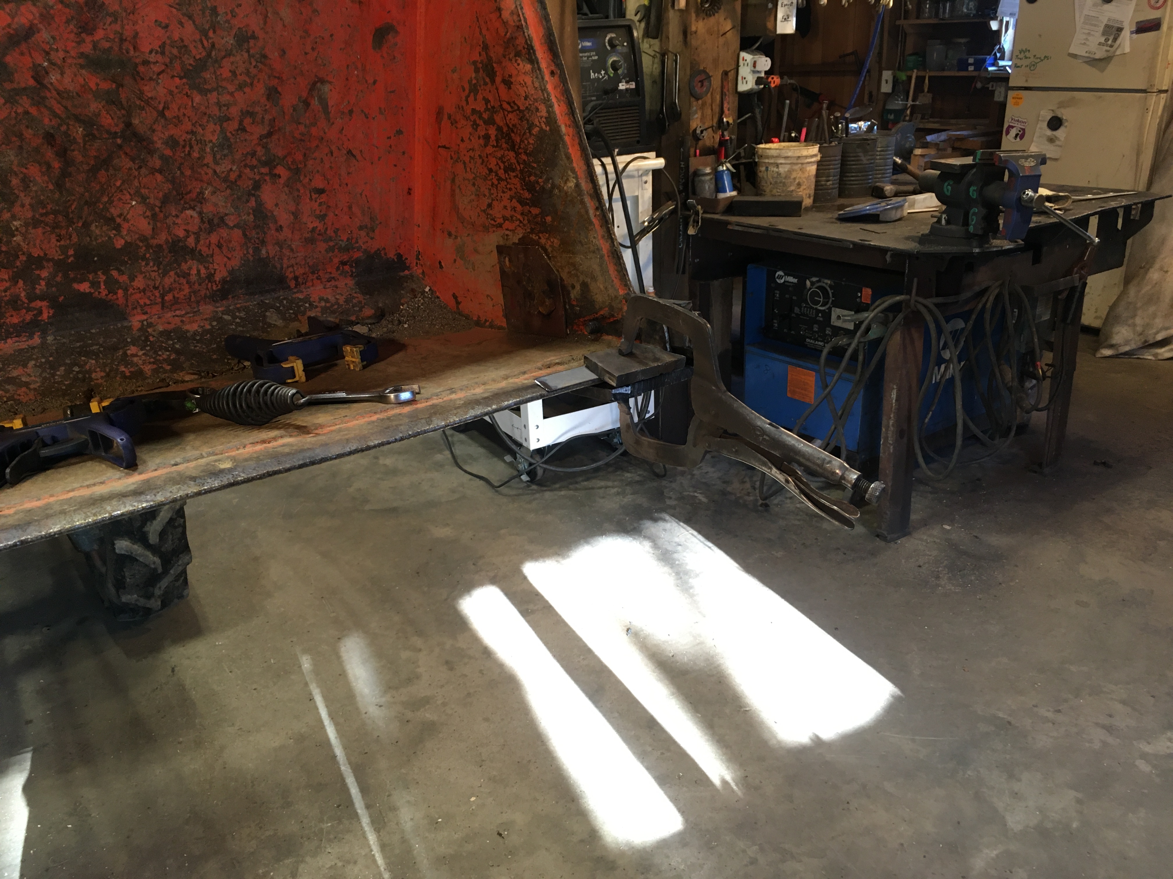

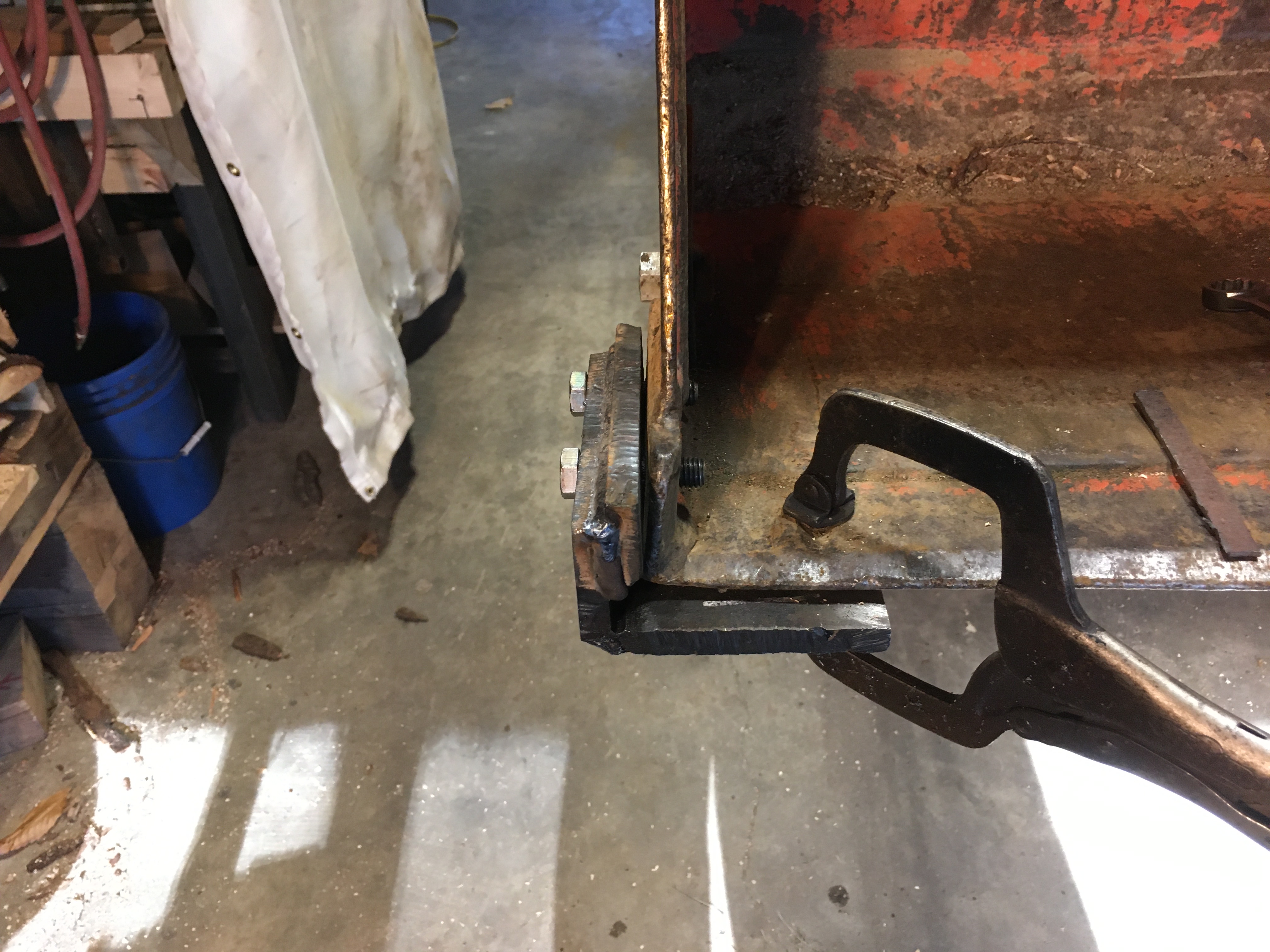

So what if I only re-drilled 8 holes 2 times and 6 holes 3 times, least now the angle bar fits, but it would've help if I measured from the right place and got the right measurement's to begin with, oh well live and dont learn.......

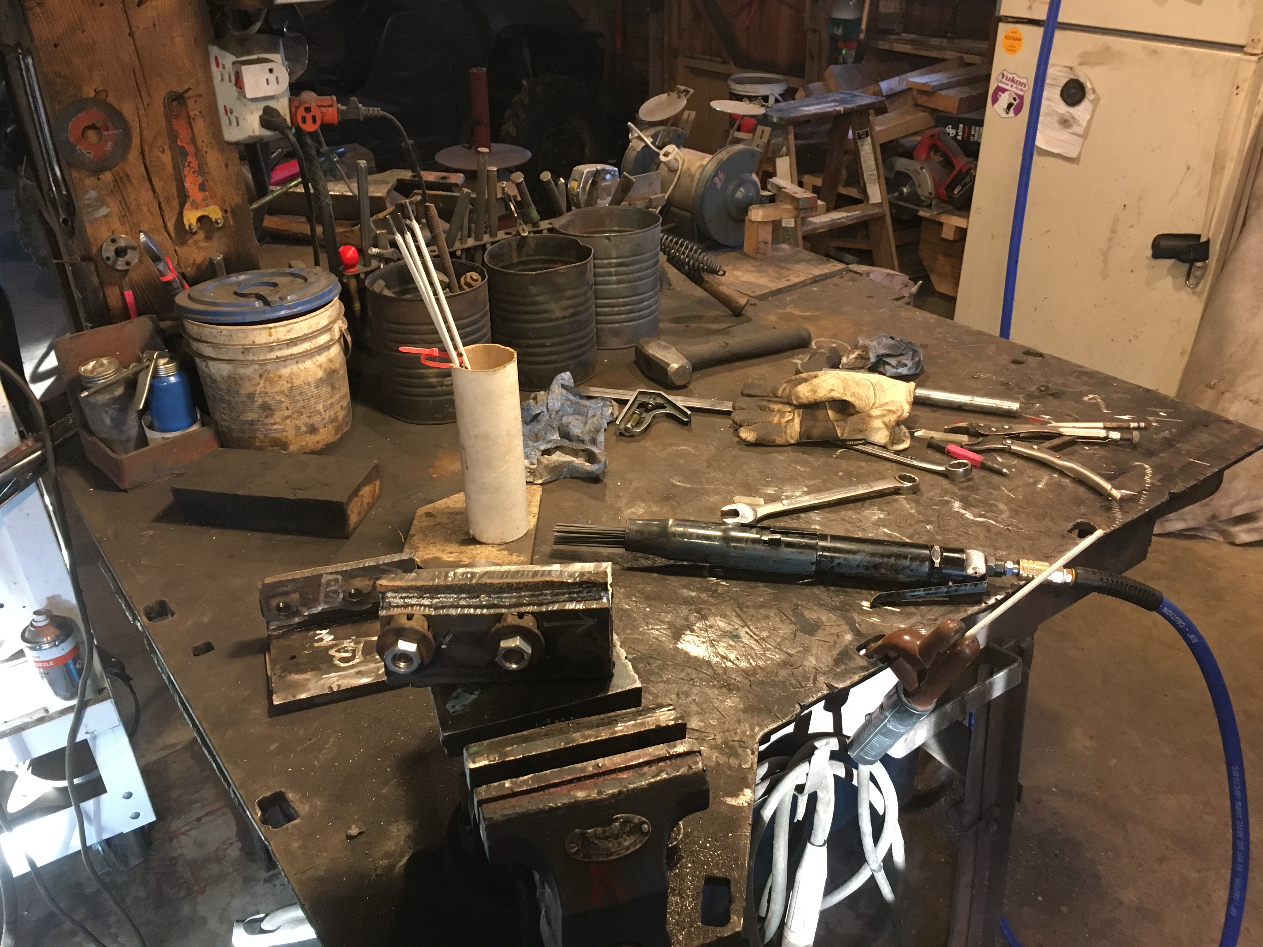

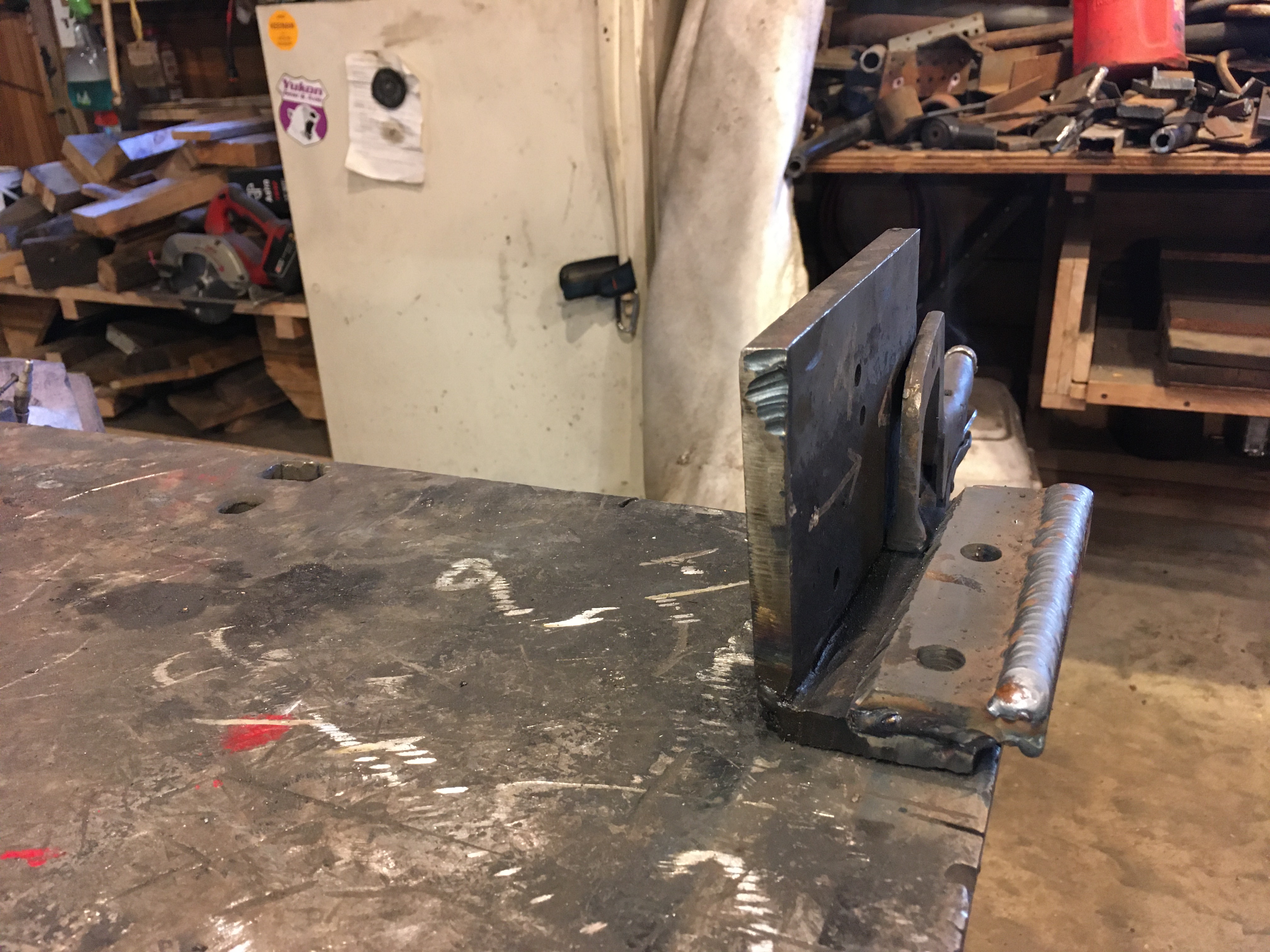

Making new short forks that bolt on my bucket, 6 hrs so far and counting and I'm paying myself $50.00/hr, I have to make some money somehow........
It's called drilling practice.

Yeah I got my drill practice in today, measuring practice I also got in. I find Cobalt drill bits drill better, even better with my drill press, and thats a subject I need to enquire about sometime......
The first hole mark-up mistake was, I measured with combo-square up from under cutting edge on bucket 1-1/4" to hole center, then I transferred the 1-1/4" by holding the square under the two pieces of angle, marked it 1-1/4", problem is the angle pieces are 1/2" thick so I should've marked it at 1-3/4"............:confused2: Anyone want me to lay out hole mark-up's

Come to think of it, isn't Sat time-&-half.... As long as I dont go into the red I should come in under budget but behind schedule............

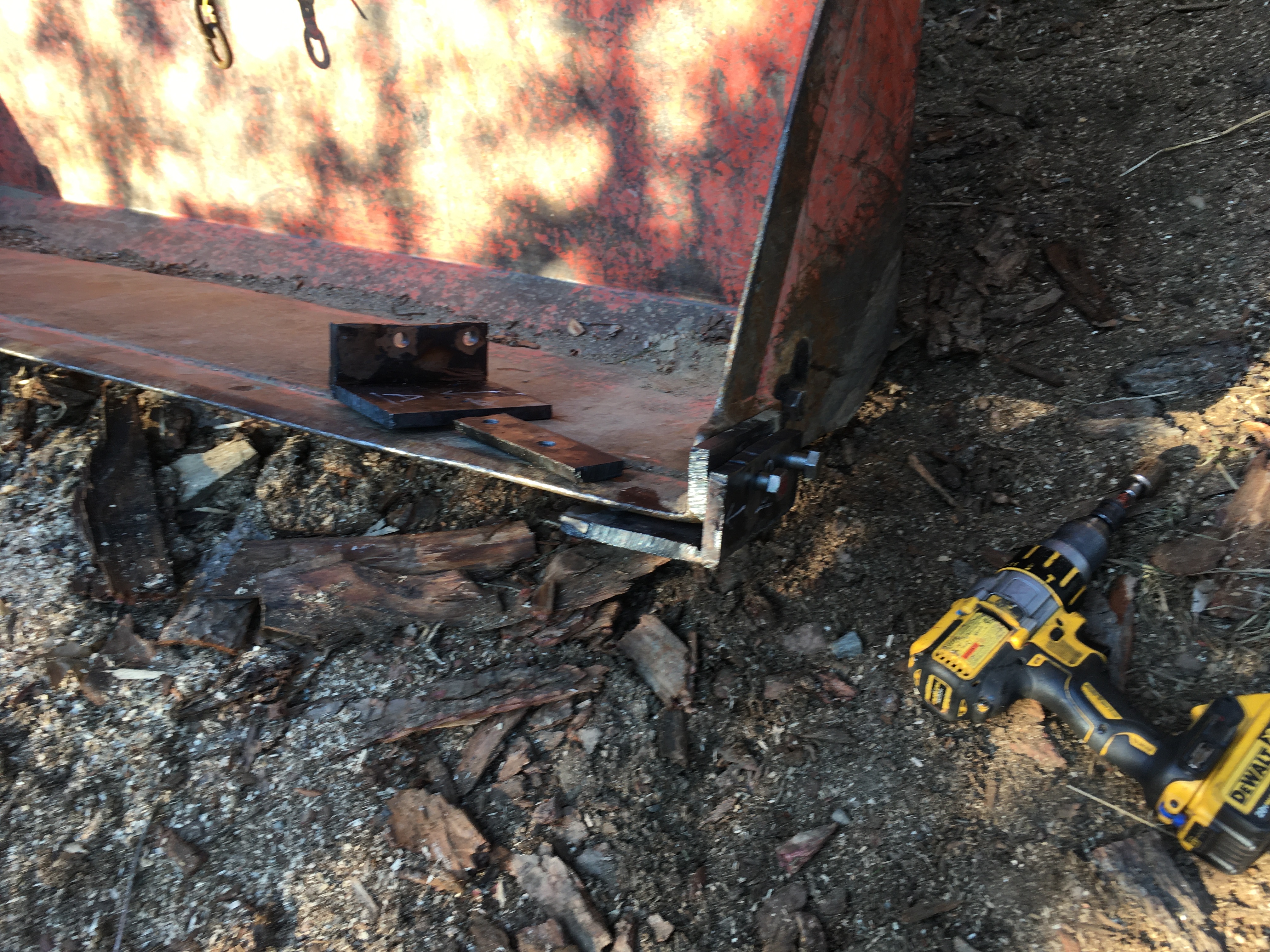

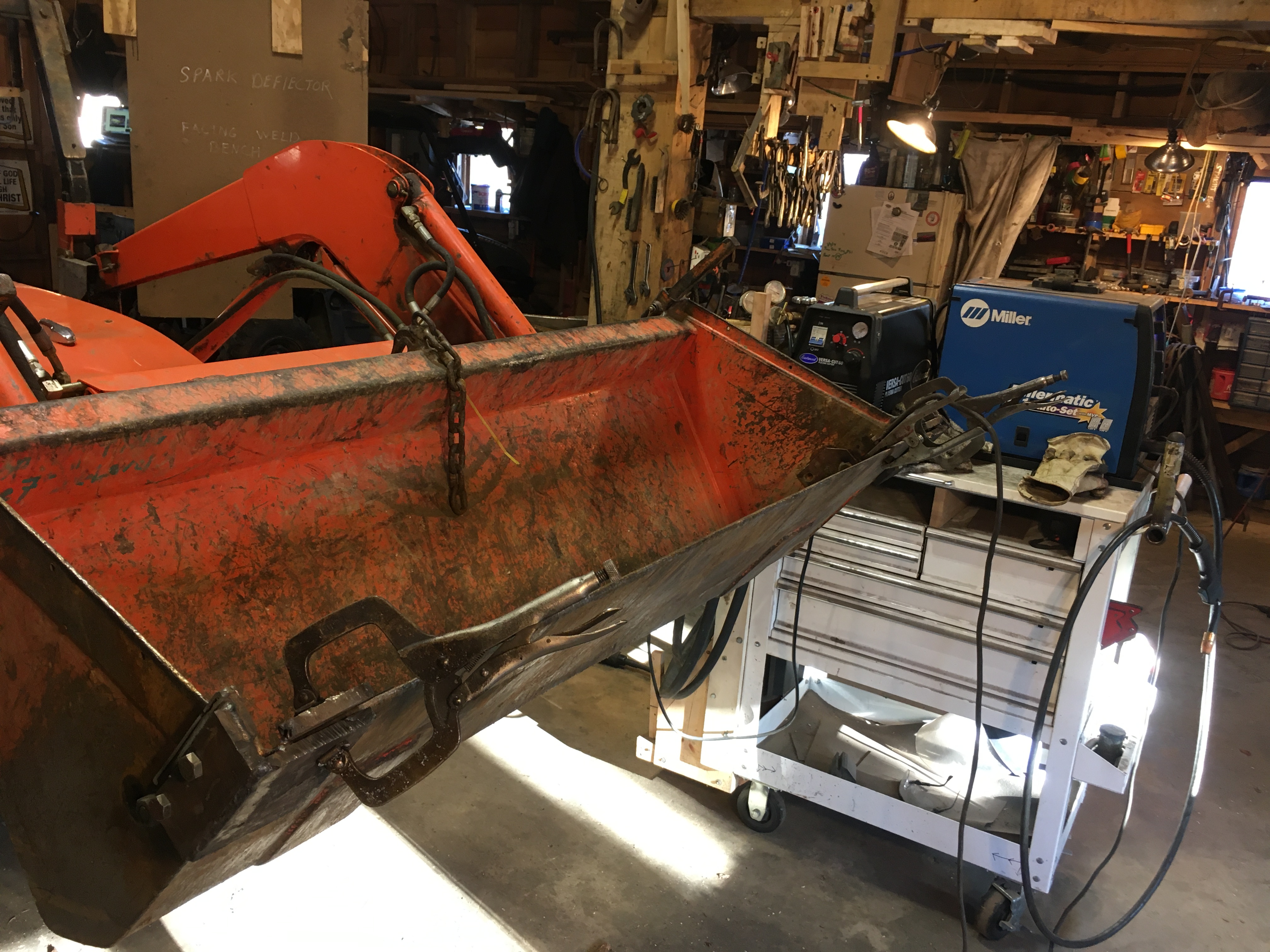

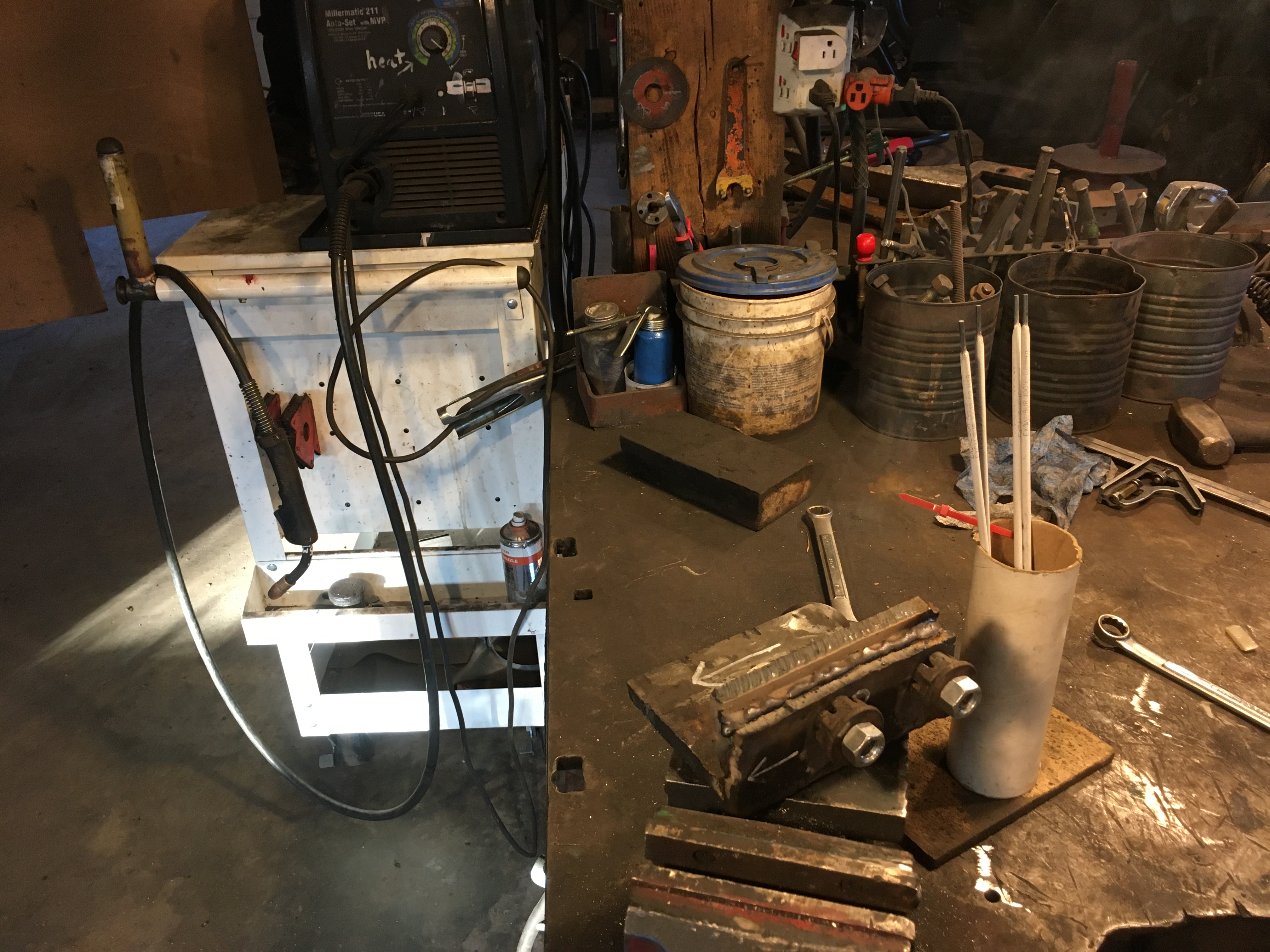

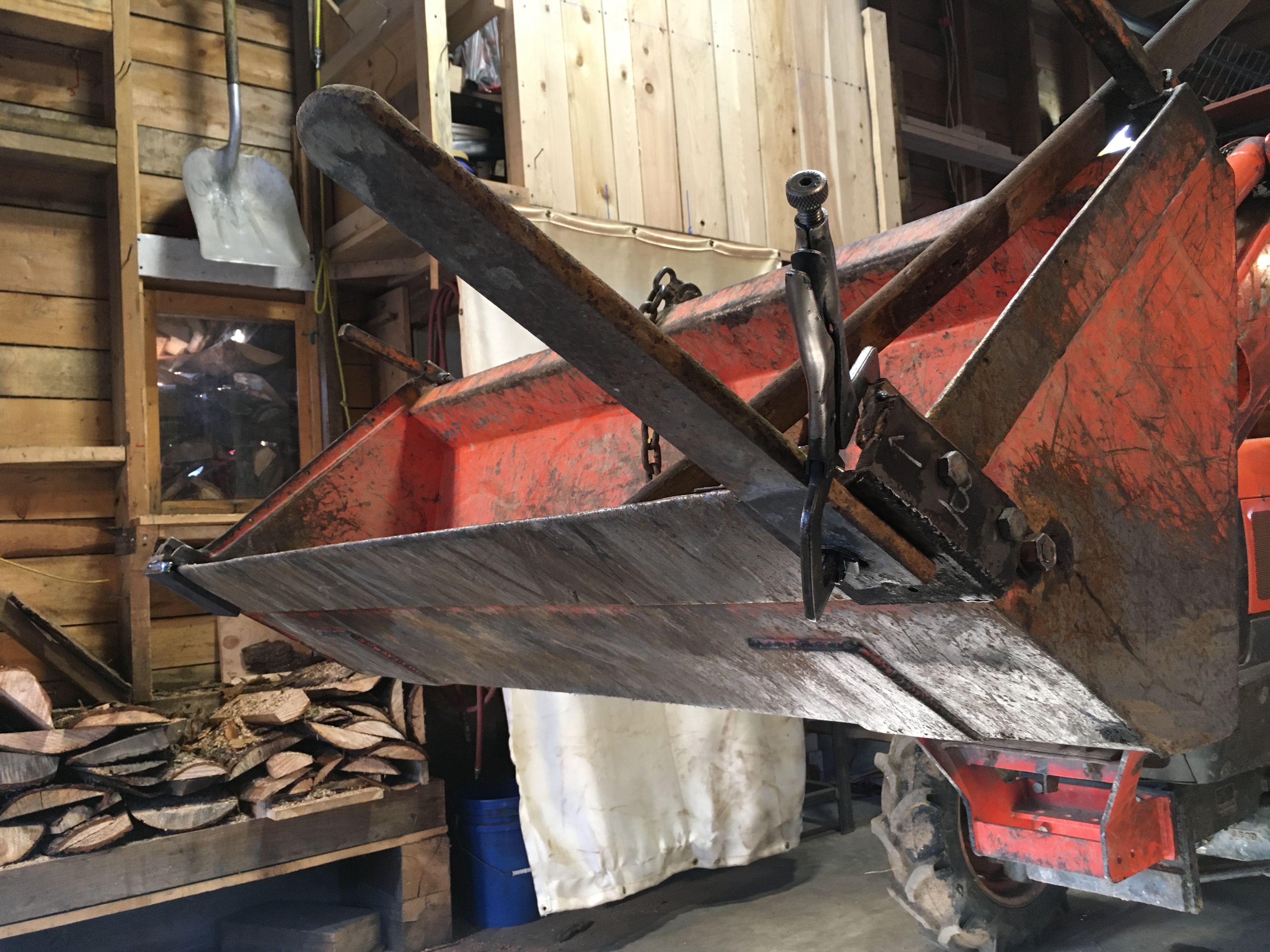

Now that the bolts fit now it's time to square up to the bucket, one fit square but left side not so much, that means shim time.......

Gonna end up something like this......
