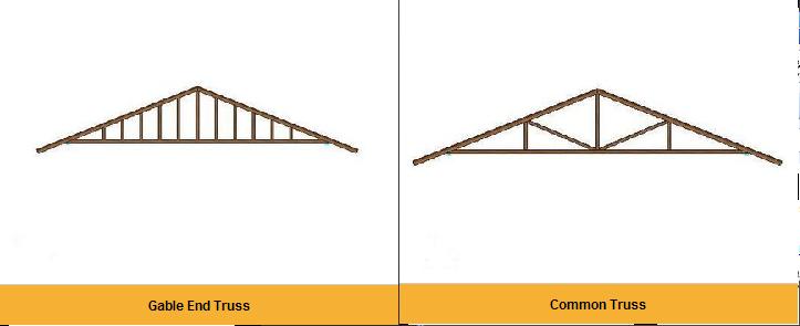

Did not hear back whether truss was gable style or same as the other trusses. As Backdoor stated, makes all the difference in the world. The front over hang needs to be considered as well as snow load. From your pictures it looks like you have 14" (or more) room for a header. A pair of 1 3/4 x 14" lvl's should be fine with double jack studs.
If it has a true truss above than less header is needed. Too much header is never a bad thing, but too little could be disastrous. If it were me, I would do the header anyway and bolt a steel hook on for lifting loads.
It might also be easier to jack a new header straight up rather than moving all garage door tacks etc. to scab on horizontally.

Sorry for being out of pocket guys. The area directly over the header is the last truss. Excuse my ignorance here, what do you mean by gable style truss or normal truss? BTW Lostcause, did you post this build/remodel a while back? It sure looked familiar. Sometimes it is hard to keep all these great projects clear in my head.

Dave, a gable truss has vertical 2x4's usually 16" on center like a regular wall and has no clear span characteristics. A standard truss has angled 2x4's similar to the picture you posted suggesting zig zag blocks over your existing header. Those blocks, by the way, would do nothing to support a load because there is not enough depth to be effective.

The 'common' truss is load bearing and would not require a header; the gable truss is not intended to span an opening it only transfers roof load directly to the wall below. With sheathing the gable truss is probably capable of spanning the opening (as in the picture above of the garage being raised) but that is a risk you have to take. I know building code here does not care where your span is (end or side wall), nor what kind of truss you have on your gable - the header specs are the same.

i agree there is a load to be supported by even the end truss and header on a gable end, but it is truly minimal compared to a header that has to support the ends of multiple roof trusses. the point was brought up about the differences in a standard w-braced truss, as opposed to a gable end truss. the gable end truss is not designed to take any load, since the interior members do not act in a direction to transfer the loads. it is framed in that manner to facilitate the attachment of sheathing. however, as long as you have plywood/osb sheathing, then you in fact have a load carrying truss. the sheathing performs the same function as the interior members of the truss.
i suppose some people will balk at that notion, because they can cite numbers form truss manufacturers about the carrying capacity of conventional trusses, but they don't have any numbers to prove that a sheathed gable end truss will support any weight. more than likely they also wouldn't believe that a loaf of bread had flour in it unless it had a label stating so. the gable end in my garage was stick built like a gable end truss, and at one point there was not even a header supporting it during the remodel.

All right guys, the gable truss description makes perfect sense. I had never heard this framing described like that. The truss's are standard truss's. I have been dealing with some leach field issues and this project has taken a back burner. I really appreciate all the help and will take it all into consideration.
