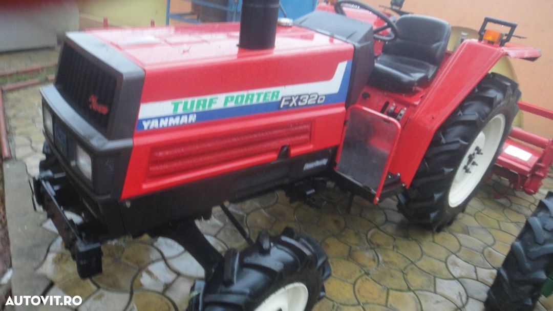

It took a long time searching the web just for a simple picture of any F32 or FX32. If your's looks nice like this, I too would be very upset that it's dead now.
BTW, Fredricks does offer the FX32D on it's price list, though a little dated. Wonder if they have parts.
