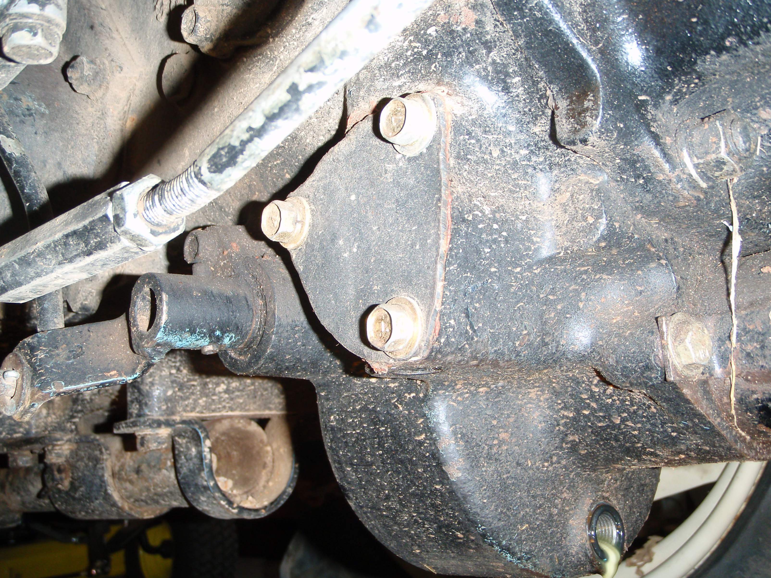

Looks just like the one on my YM240 FWIW.
It should filter the oil just before it goes to the pump. Look to see if the larger diameter return line exits the opposite side of the transmission in line with this plate.

GWSMITH or someone else with an FX24D, can you please verify something for me? Is the metal plate with three screws in this photo the cover for the hydraulic screen? This doesn't look the same as the cover that Hoye has, or what is in the manual. It looks like someone may have cut a piece of sheet metal and used some silicon sealant instead of using the replacement part. Thanks!
Been a while since I was under mine but I do believe you are correct.

Thanks for the input on the screen cover. I pulled it and cleaned the screen. It looks like the flat piece they put in place doesn't hold the screen in the correct position to be most effective at filtering the oil. It looks like I will be making another Hoye order today.
While I have everything empty and apart, how often do you change the rubber hoses from the screen and to the filter?
/ FX24D photos? #26
The flange that holds the screen in place has a cylindrical part built on it that should hold the screen. It has a close tolerance with the housing. That cylindrical part also has a hole that goes in the up position. This is where the power shift takes it's suction if I remember right. Not sure just what you have but wondering if your powershift pump is actually pulling suction through the screen? :confused3:
Here it is. http://www.hoyetractor.com/mm5/merc..._Code=HTE&Product_Code=IP-4555&Category_Code= Part number 194555-24220
I would change the filter hose based on hands on inspection.

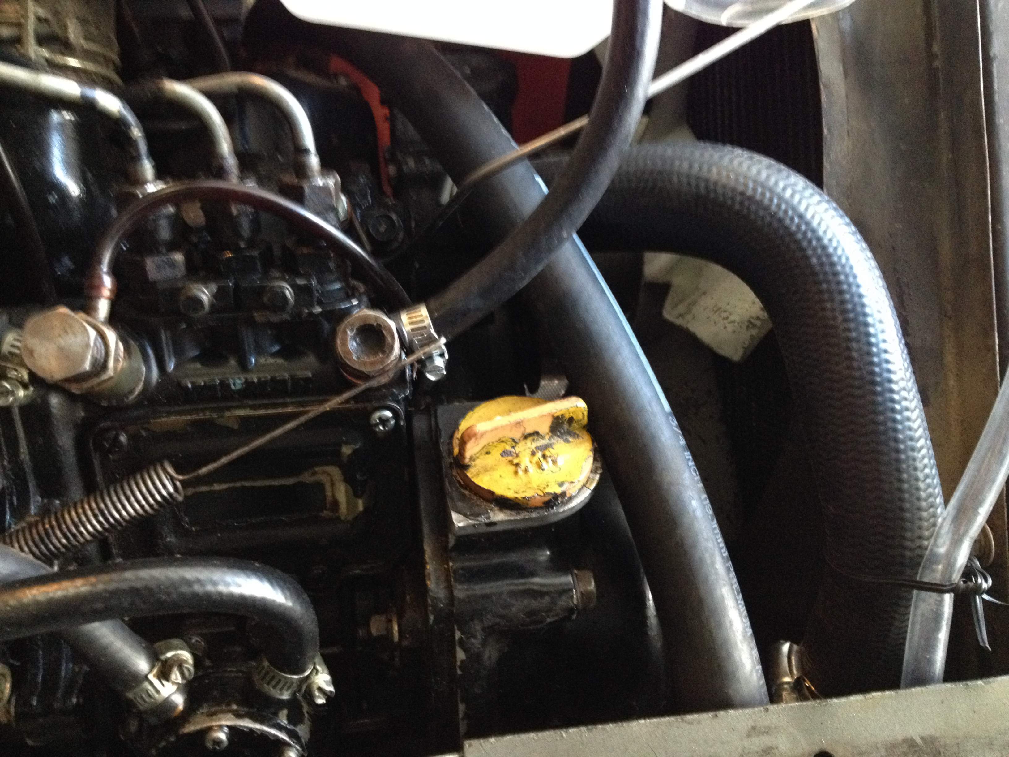

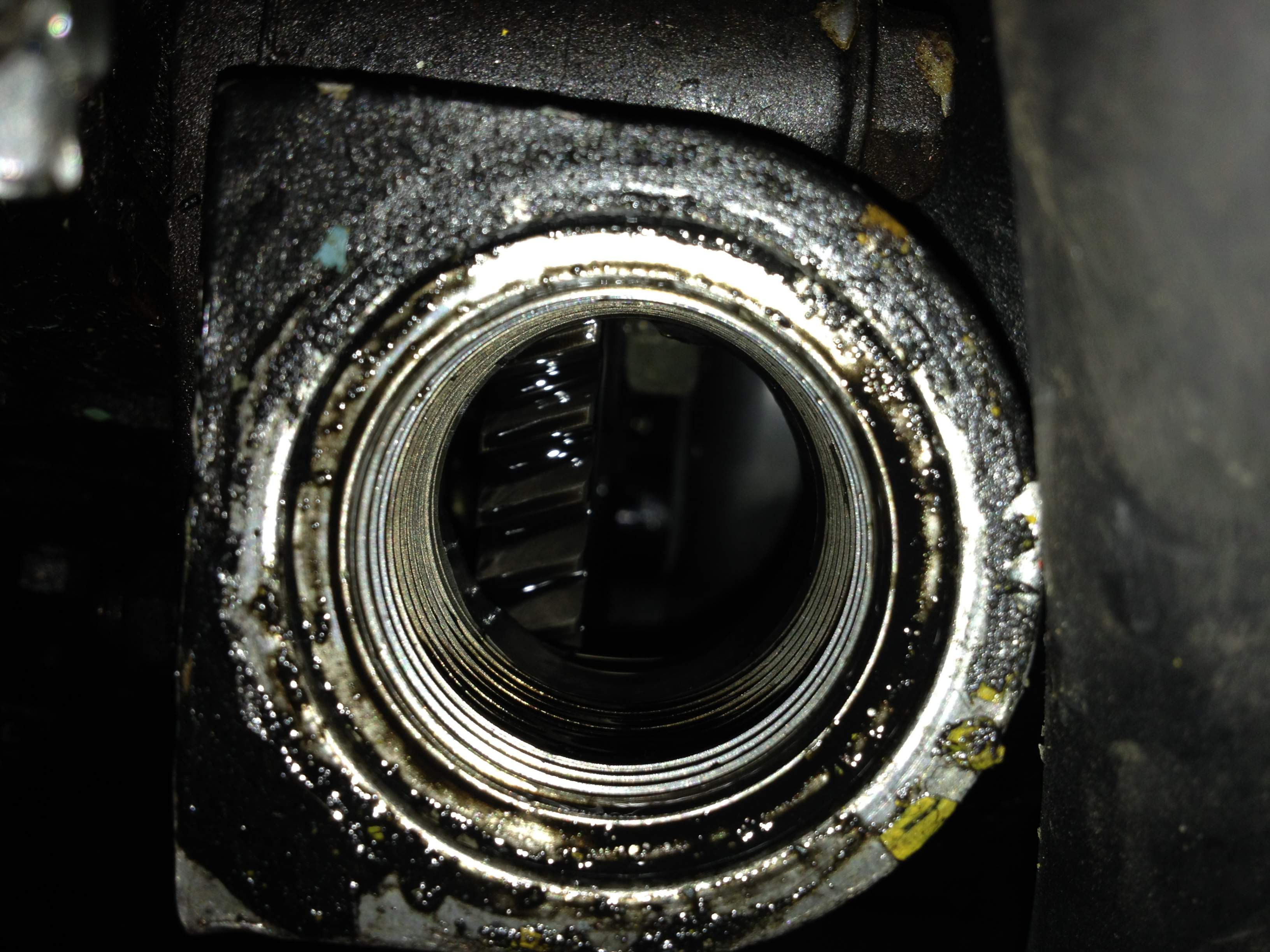

What is this reservior, and what fluid should it have in it? Of course the cap says oil, and it does NOT have a dip stick. It is not full of fluid, but the gears appear to be adequately lubricated. mine 074.jpgmine 072.jpg

What is this reservior, and what fluid should it have in it? Of course the cap says oil, and it does NOT have a dip stick. It is not full of fluid, but the gears appear to be adequately lubricated.View attachment 350581View attachment 350582
I am not sure what I am seeing but believing that is a cap on the front gear housing. If so, engine oil goes in. It is just another acess to the crankcase. You can pour oil in there or on top of the rocker arm cover. Dip stick determines level.
/ FX24D photos? #30

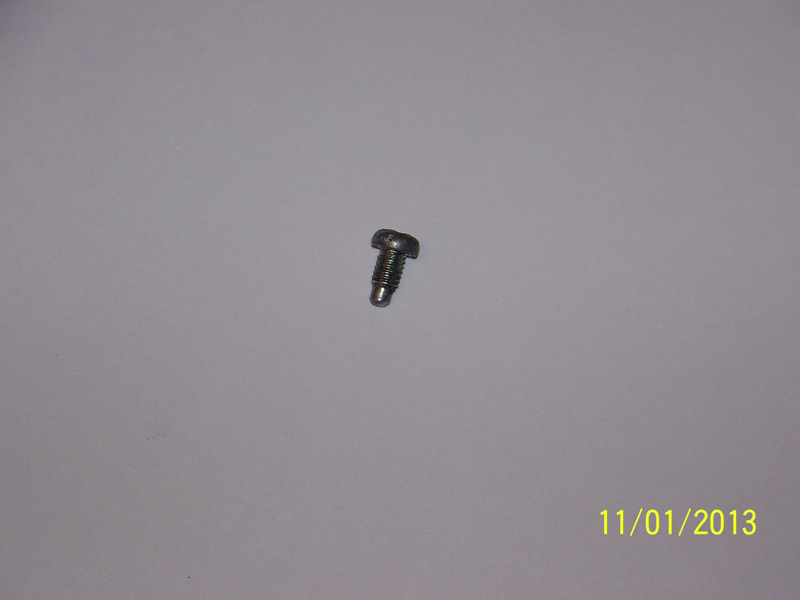

I checked it this weekend. When operating at full RPM it goes completely off of the gauge and down into the PTO RPM gauge. It still sounds good. The throttle set screw only has one tab (one is broken off?), and the paint on it looks like it has never been adjusted. Is there an easy way to calibrate/adjust the gauge? For the most part I don't care, but it might be good to know for operating implements.
/ FX24D photos? #35
I certainly don't know but have an opinion about everything. I just doubt the tach has any adjustments. Parts manual shows it has a little gear box right behind it similiar to the one on the gear case where the tach cable comes off. If the tach is steady I doubt any hope for it. If it is jumping around a good lube of cable and possible the tach also might help. Don't take any of this to the bank, just putting something out there for thought. You can buy one of these and check it out. Digital Photo Sensor Tachometer
