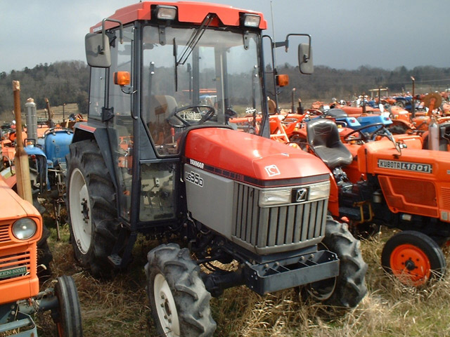

I also just saw a US35D for sale but do not know anything about the US series, actually I never even heard of it until now. Can anybody shed any light on this series?
Thx...Pozzman
In nearly 14 years I have never heard of a Yanmar US35D model in a compact tractor, or anything close to that.

The US35 is an exact replica of a john deere only in red from what I have seen in the photos. Now that I would shy away from (parts) there just are'nt enough of them over here yet, in my opinion.

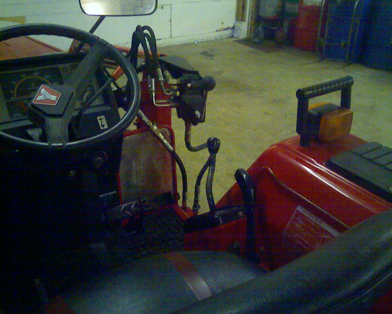

..... The shifter is next to your right thigh perfect for shifting when using the loader, just feels right ergonomicly to me......
That's the one thing that bugs me about my F16, is that the shifter is on the left side. I sure wish it was on the right side. But, if it was, it would get in the way of the 3pt levers. Would you mind taking a pic of yours (with the seat raised) someday? It's not like I'd be able to change mine, I'm just curious, that's all.

Ernie.....tell me about the US35. Is this a relatively new model? Seriously never heard of such.

Here's a picture of the US35-D.

Hi Wayne, I know very little about the US35 as I have never had one here to see. It looks like a very nice machine, but like I said, parts could be an issue.
