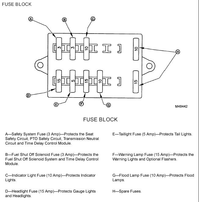

Oct 20, 2011 / fuse #1 P philintexas New member Joined Jan 23, 2011 Messages 4 where is the 3amp fuse located on a 790
Oct 20, 2011 / fuse #2 B beenthere Super Star Member Joined Aug 16, 2001 Messages 18,689 Location Southern Wisconsin, USA Tractor JD_4x2_Gator, JD_4300, JD_425, JD_455 AWS, added JD_455, JD_110, JD_X485(sold) Can you tell us more? Try in the fuse block. Attachments 790_fuseblock.JPG 54.2 KB · Views: 953

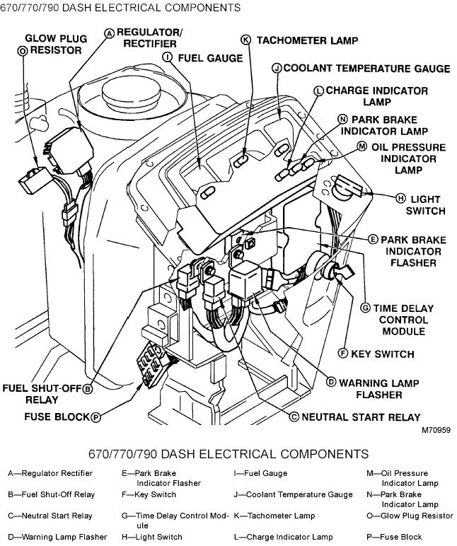

Oct 20, 2011 / fuse #3 B beenthere Super Star Member Joined Aug 16, 2001 Messages 18,689 Location Southern Wisconsin, USA Tractor JD_4x2_Gator, JD_4300, JD_425, JD_455 AWS, added JD_455, JD_110, JD_X485(sold) Location of the fuse block. Attachments 790_fuseblock_loc.JPG 118.6 KB · Views: 990
