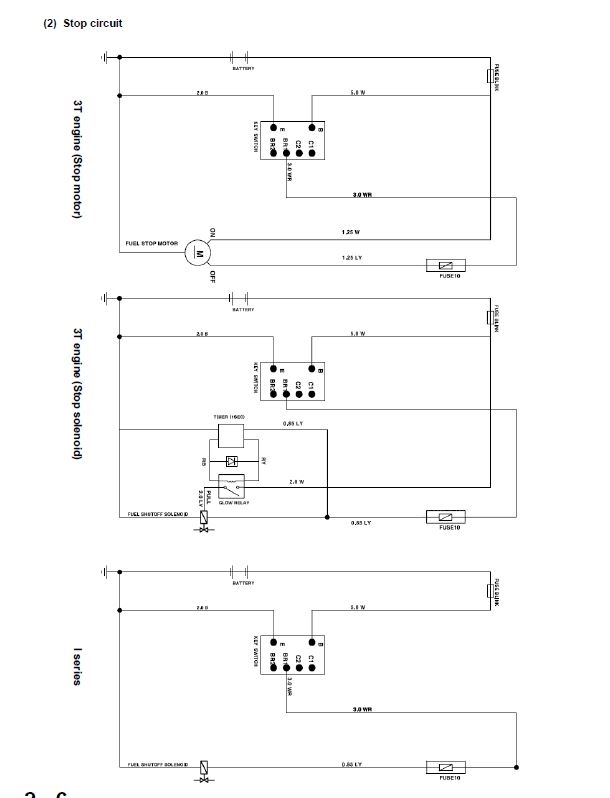

Does anyone have a schematic for the century 3045 fuse panel? The repair manual has nothing.

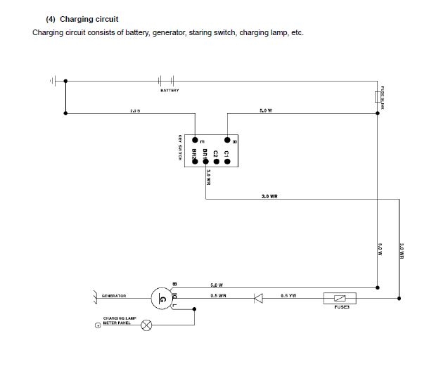

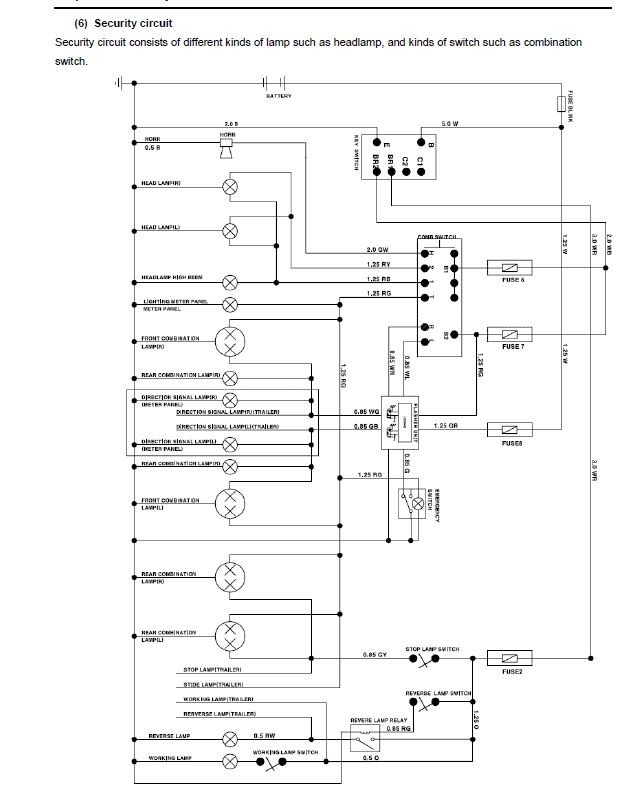

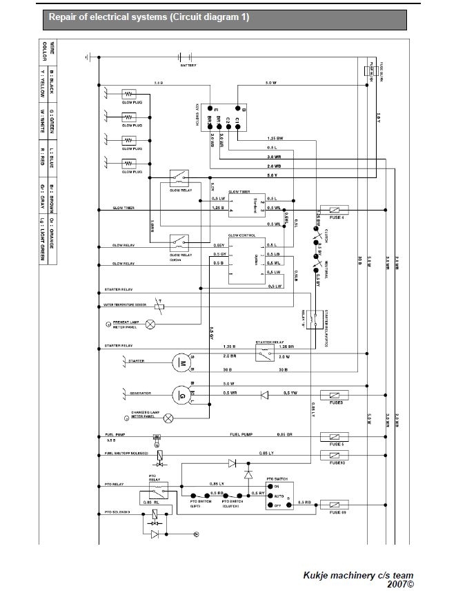

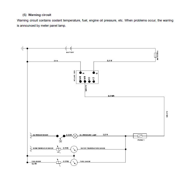

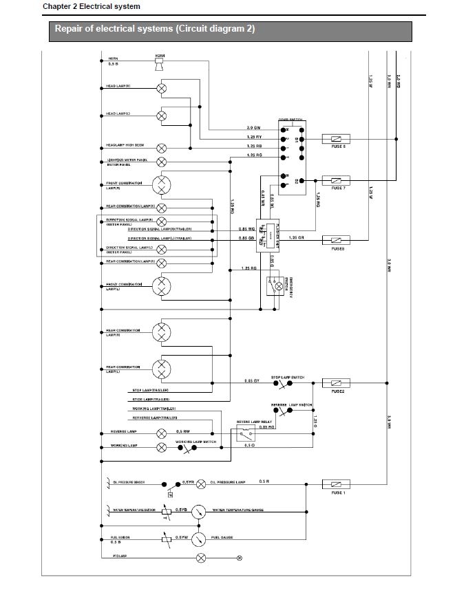

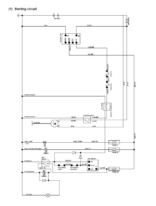

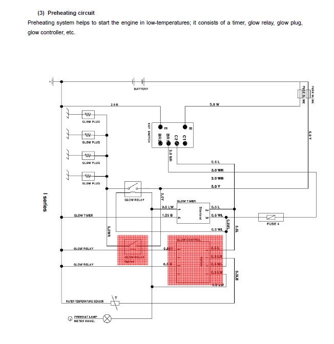

here is every wiring diagram i have for that series hope this helps
