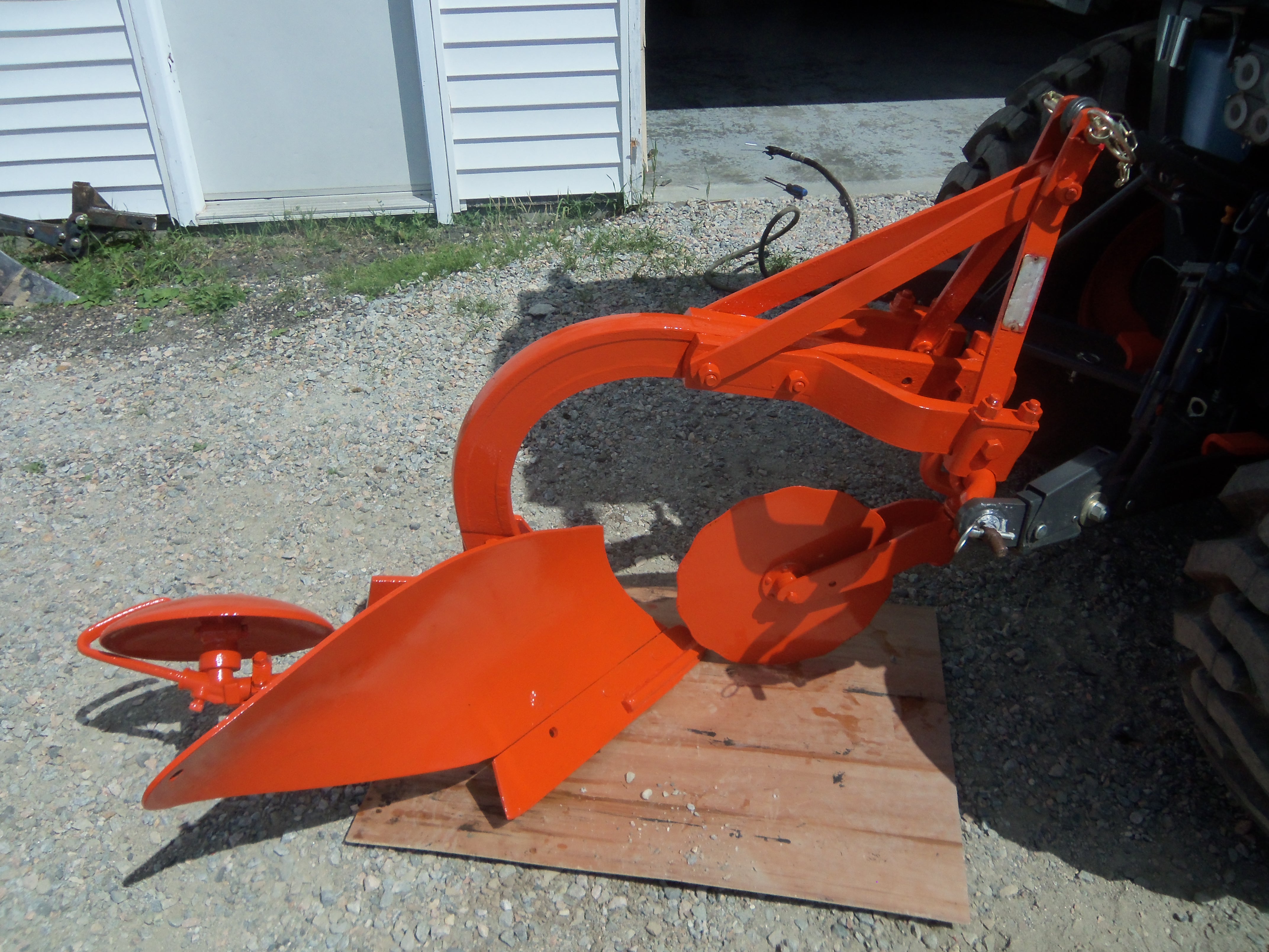

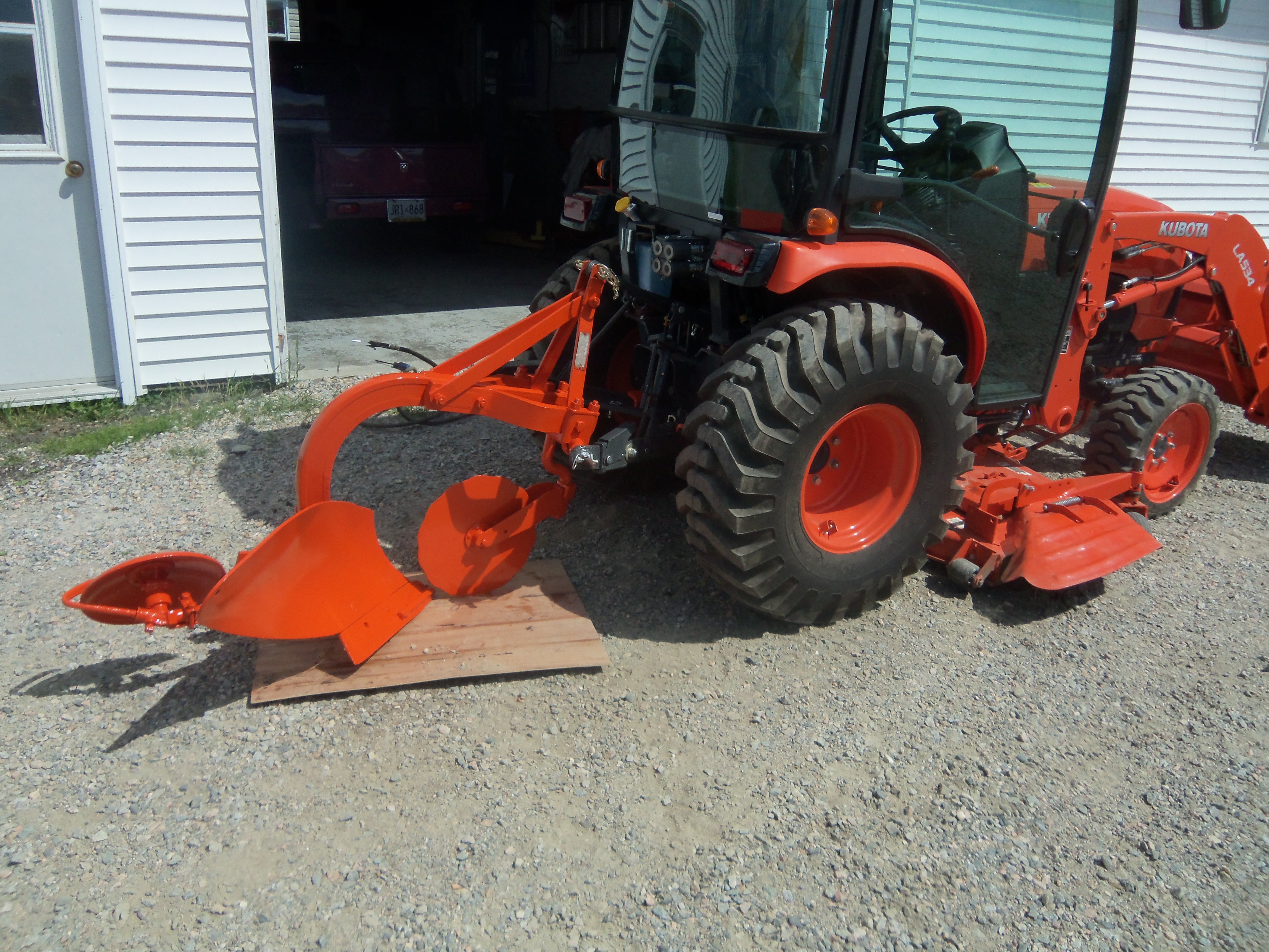

Well here is what I pick up yesterday for a good price 100.00$ .The front wheel was not on it I had one here look like it going to work and I just had to paint it orange you can call it massy orange lol.

There you go much better!

The plow is Cat 1. The tractor is Cat 0.
The plow is actually Category II as the OP stated the pins are 1.125" diameter. Category I is 0.875"
Nonetheless, the plow is too big for the OP's tractor. A single bottom 14" (preferred) or a 2 bottom 14" (ok) would be better.
The old 19hp Farmall C can pull 2-14's.
The new single bottom plow you got is nice! I have the same one but a little older...my A-frame is all cast iron where yours is fabricated steel. The front "wheel" is called a coulter, by the way! I just re-bushed the furrow wheel on mine last week...check to see if it's wobbly on its shaft. If it is, you need to bore it and install a bushing...it's just steel on steel with a grease fitting. I ground the rivets off the hub, chucked it up in the lathe and indicated it true, bored it out then made/installed a new bushing with a very LIGHT press fit...worked like a champ.

yep am sure it will .I dont like to abuse my stuff . I know it can take a lot but like to take good care of it .

OK, let's see it in action now. Drop that thing in the dirt and let it rip. Did you mention what implement you will be using after the plow and what you'll be doing with the ground after it's worked?

Soon it to dry right now ,I try it a bit when I got it I cant wait to give it a real try .I just got a piece of land in the back yard about 100 x 200 that id like to get nice and strait afteram done plowing I have a set of disk that am going to run over to brake it up. Am planning on doing a RC track for the kid well and me.
