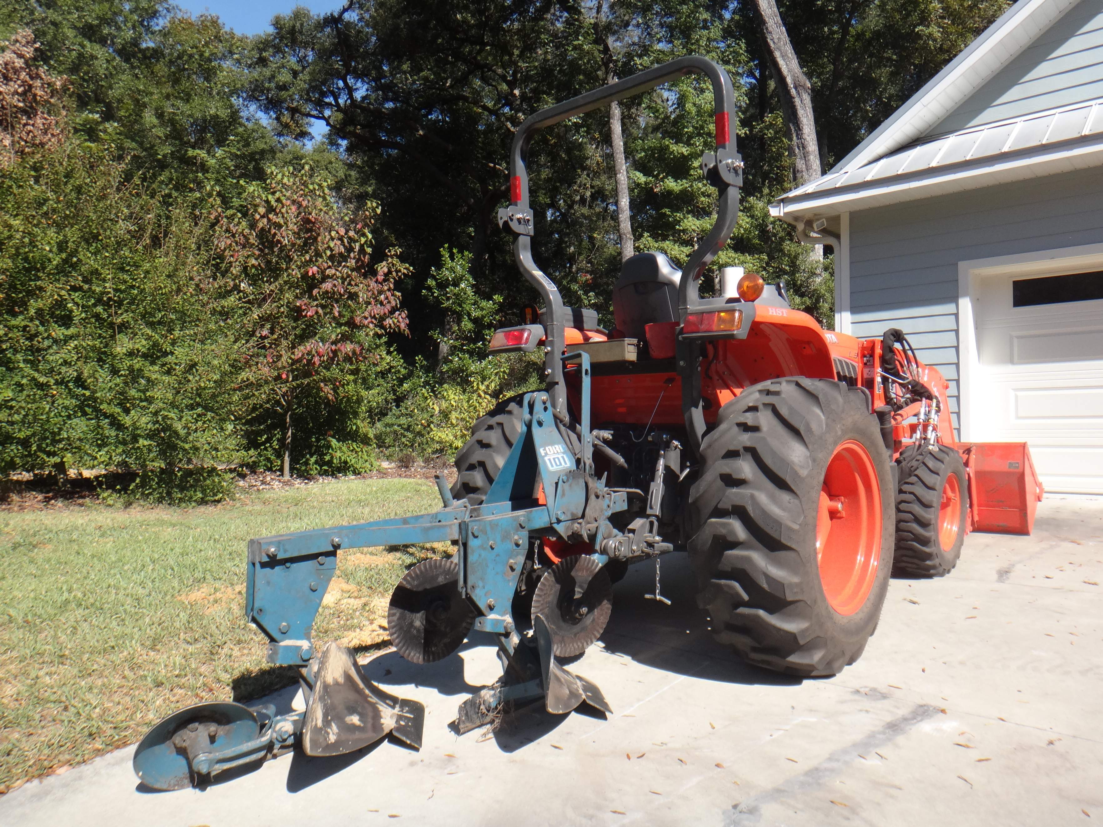

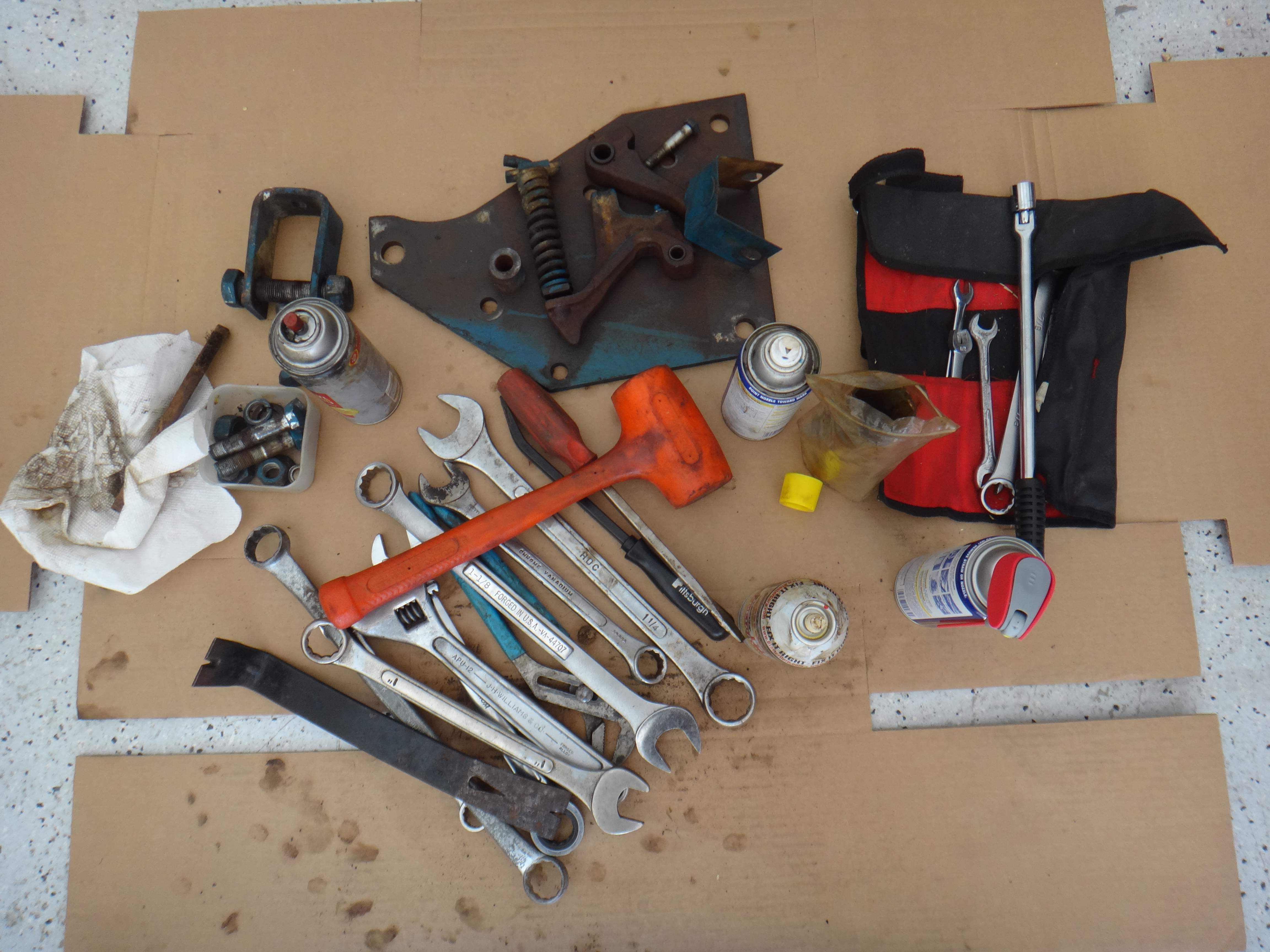

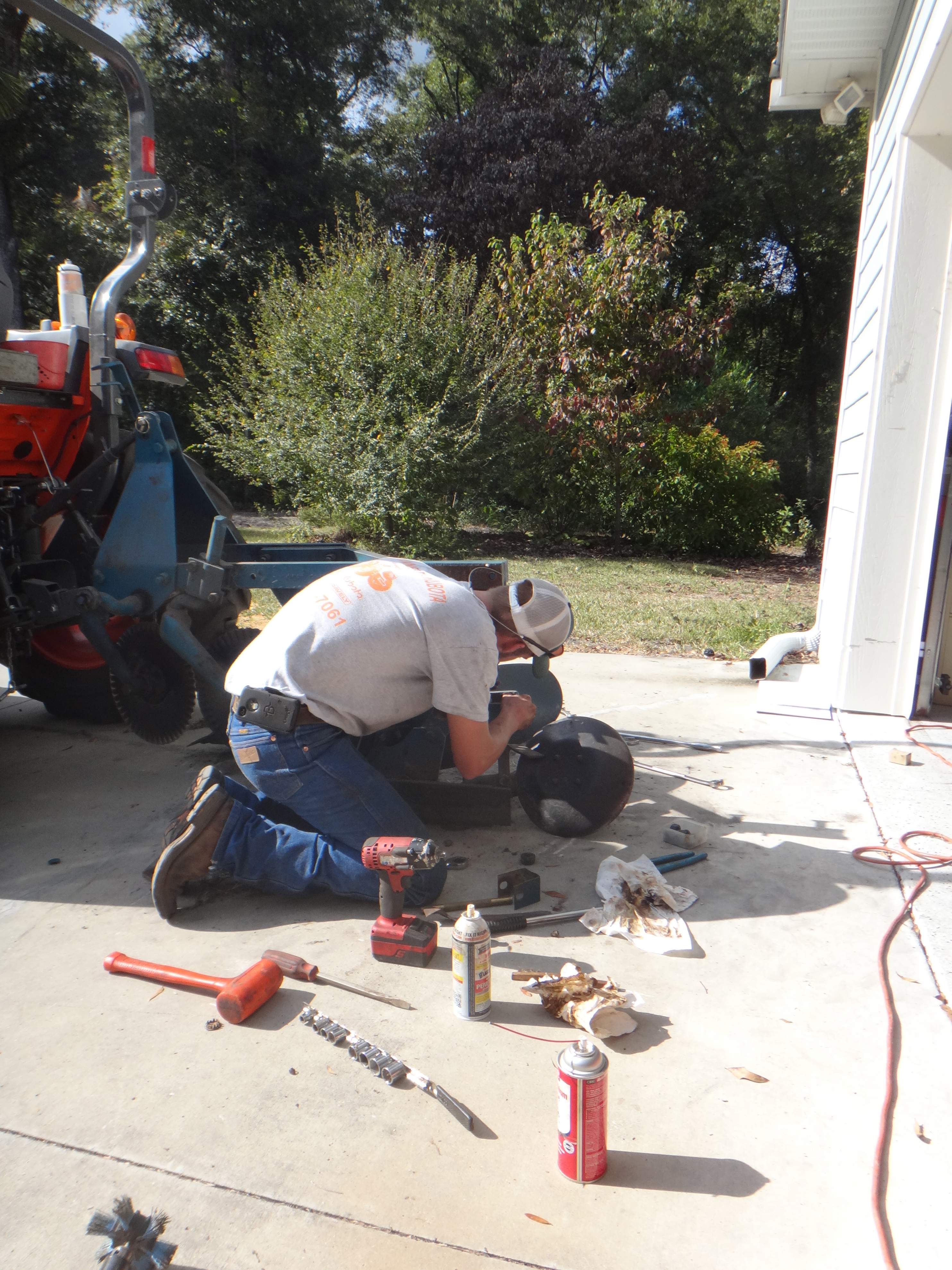

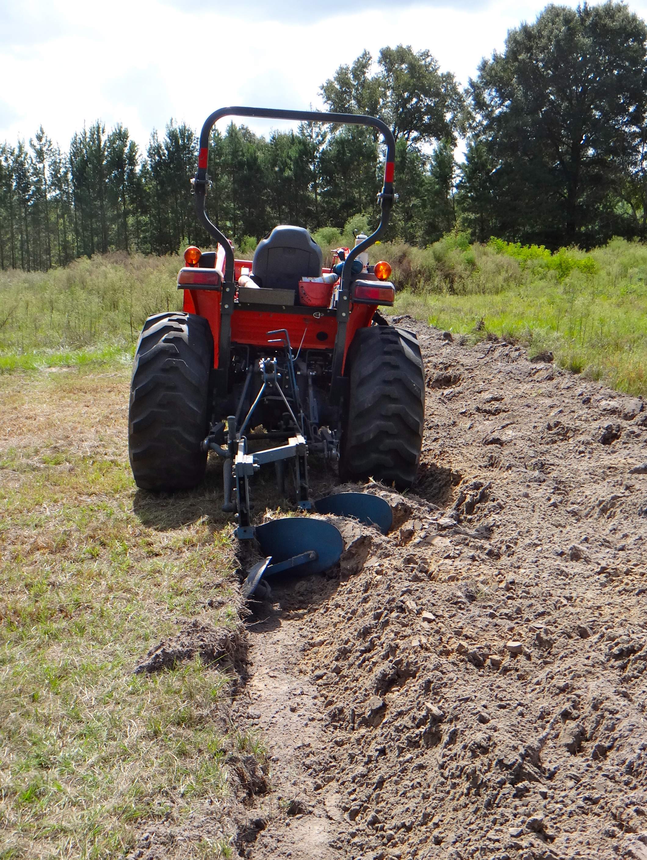

If you hit a rock dead on something has got to give. I damaged a top link - failed a swivel bushing - along with breaking a share when I hit a rock. At that point I decided I may as well find a plow with trip bottoms even though we don't have a lot of rocks. Slop in the stabilizers will allow it to slip around some but a good solid square on hit and something's got to give.
Harry Ferguson patented hydraulic Draft Control as part of his tractor Three Point Hitch in the 1930's. Draft Control is engineered specifically to automatically raise the plow if it encounters too much resistance, such as a boulder or a rock ledge. Sensitivity is set by 1) Draft Control lever position and 2) pin-set inboard position of the Top Link. Usually there are 3-4 pairs of holes, one pair above/below the next, for Top Link inboard pin.
Draft Control does not always prevent plow damage, but more importantly it prevents the tractor from going VERTICAL in 1/2 second. I personally got a John Deere 750, without Draft Control, VERTCAL, and it was just too, too, exciting to do more than once. Had I not had the seat belt tight, I might be dead.
After that experience I pull a Ford Series 101 Trip Plow in addition to having the ($250 optional) Draft Control on my Kubota 'Grand L' properly adjusted.
And, YES, that big Branson can get vertical too. Bent Branson Top Link was a warning from God to use Draft Control with the plow.
Periodically you must clean and lubricate any Trip Plow mechanism.
