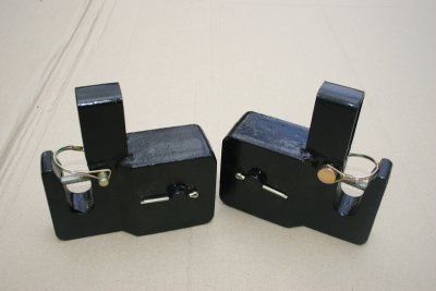

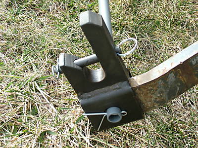

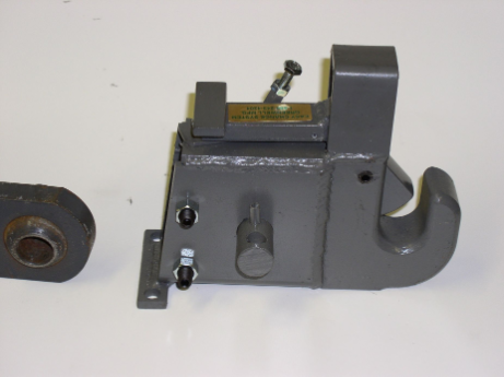

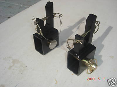

I don't mean to hijack this thread, but I was just looking into this myself. Seems to be a few more variants than the last time I looked. Was going to ask everyone if they had experience with any of these other than Pat's system, which looks to be the Cadillac, including the price tag.
My issue is where they position the implement. Some position it behind the lift arms, some position it above the arms. Sometimes I wish my implements would go lower, so I'm not wild about having them sitting on "top" of the arms.
All of these were found just by doing a search on Ebay for "Kubota", except for Pat's, which is easy to find on this site.
Getting back to Bill's original question... is there a downside to having these? Anyone ever take theirs off in order to use a particular implement?

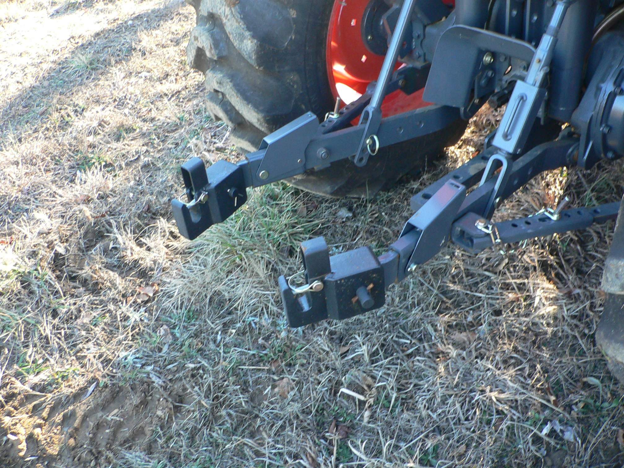

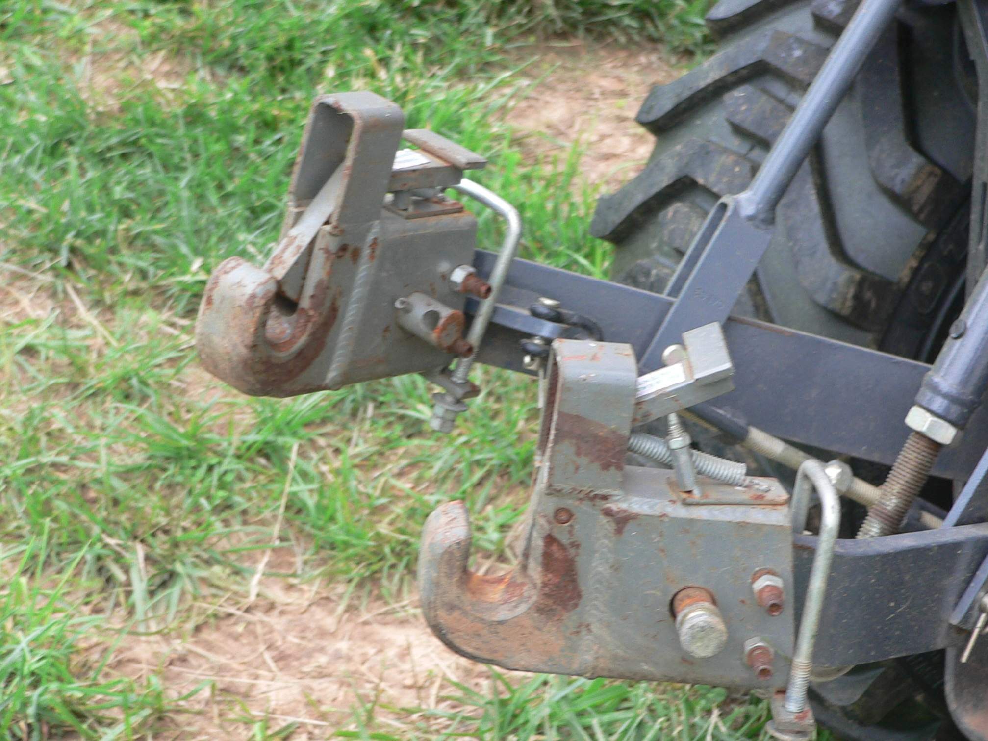

I've had Pat's (30 day satisfaction or money back guarantee) for over 4 years and I also have a set from Ebay as pictured for other tractor. Guess that shows how much of a believer I am. The down side is they set implement back a few inches which can make upper arm to short. Did for me so went to TSC and got another longer upper arm under $30. Also makes the need for drive shaft to be able to extend a few more inches for implements with drive shafts which has been no problem for me. Some have expressed the increased power needed to lift an object a few inches further back but that has never been a problem for me.

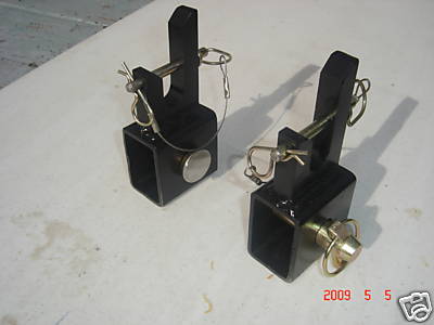

I finally took a picture of my Pat's on my tractor for those that want to see the 2 types I own installed.
Jesse
Jesse,
I have the 3rd one from the left-- the quick hitch version..
I like it, but wonder if PAT's would be better..
on my set, the cost was $65 plus shipping..
they work pretty good-- the only problem I've seen is with my bent and mangled box blade... It is difficult to hook up depending on how I dropped the box off..
but still alot better than without....

As pictured above, I have Pats and the ebay cheapos. My L3240 had the extendable arms. They are handy but not really competeters. The QA/s have the open top instead of the round hole to wrangle over pins. With extendable arms you can get into position and then the arms will easily slide back and forth to line up holes but the height issue is still there. If the arm is to high or to low you still have to manipulate the implement to get it in the hole. Pat's or other with extendable arms is fantastic.
