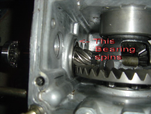

sandman2234 said:
When you knurl the case to allow the bearing race to fit better, make sure you do it equally all the way around. Keeping the bearing centered will probably make a difference.
Another way would be to use some very thin shim stock to take up the space.
David from jax

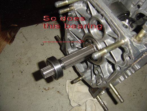

Hi Yubby,
Dave has given you some good advice ! You can buy .001 or .002 feeler stock to accomplish what he is talking about. It would be nice to know what the specs on those bores were when new. But no, those bearings should not be spinning. The loctite can work also but, but I kind of like the feeler stock better.
Keep us posted!
/ Fun with a B21 Differential #24
dullpain said:
If you want to tighten the fit of that outer race in the bore of the case , you can take a center punch and punch all the way around the bore, do a couple of rows. This will raise some of the parent metal and make an interference fit if bore is not too large. I believe that Loctite also makes a liquid chemical product for this purpose , can't remember the name tho. Loctite is the brand name of thread locking compound , should be able to find it at a good NAPA parts store.
the punch theory does work but shouldnt be used for excessivly loose fitment (if you can spin it by hand)
the loctite product your looking for is "Loctite Retaining Compound"
Loctite Retaining Compounds
you can reserche the various flavors on the net to see which one is best for your application. (#648 has come up in the past)

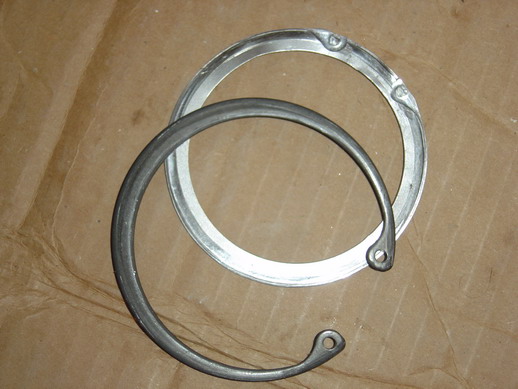

/ Fun with a B21 Differential #25
I have used Loctite 609 Retaining Compound before with success. A cam bearing spun in an engine block enlarging the bore. I advised the owner he could pay for another block or I could use the 609. To my knowledge the repair never failed. I have also peened bores with a punch and never had a failure.
Great repair job and photos. I am very impressed by the size of the bearings.
Looks to me like the snap ring got worn by the spinning outer bearing race.

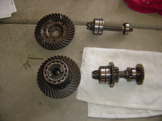

Thanks for all the great replies and suggestions. I ended up getting a new differential casing, as I found a few cracks in the existing one and could not get the differential to come up to spec on Backlash without putting excessive shims in.
I figured the $200 additional cost for the case was well worth it if I do not have to take the tractor apart again!!
I ended up getting 7 thousandths backlash using 0.7 mm shims on the ring gear side and 0.6 mm on the casing side.
Attached is the picture of the new case and the first step of reassembly; installing the HST unit and transmission. [note the picture of the transmission is actually the HST return spring, that you don't want to forget to install!!!!!!!]
cheers -y
