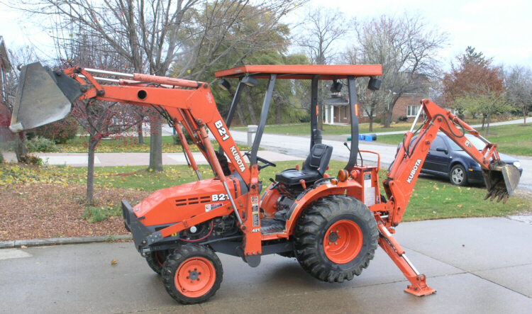

I just purchased an experienced 2004 B21. I take delivery into my ManRoom tomorrow where it will stay for the winter. I plan on doing cleanup & minor repairs/maintenance then, in the spring, it will move to its permanent home, our cottage near Parry Sound Ontario.
Once it is all cleaned up, I'd like to put a coat of paint on it & maybe even some new decals. The paint on it now isn't too bad but I would like to spruce it up a bit.
Has anyone done a full paint job using a brush & maybe the odd spray can? I've read some painting threads here but most pertain to minor jobs, touch-ups etc. Has anyone done a full paint job? Can a do-it-yourselfer get a decent finish using a brush or roller for most of the work or am I liable to make it look worse than when I started?

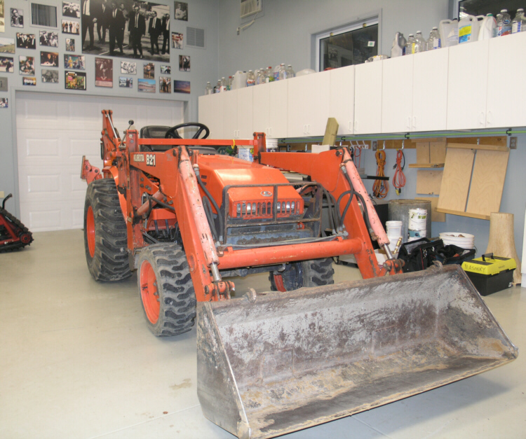

I took delivery today. Here it is.
I had to remove the canopy to get it into my ManRoom.
The paint on top of the canopy is quite faded. I have a compressor so I think I'll buy some spray painting gear & paint the frame & top to see how I do. Then I'll decide the extent I want to dissassemble & paint the rest.

Wow, that looks like a nice ManRoom.
The tractor looks good too, although I have never seen that style of hood before.

Where is the tractor that needs painted??:laughing: Maybe the bucket but man I would leave the rest alone!!!!!!!
Great looking machine! Congrats!

Thanks everyone for your input.
After further thought I've decided against a complete paint job. It would require a complete disassembly & like several have said, the existing paint is pretty good. The only exception is the canopy which is quite weather beaten & scratched. That will be fairly easy to do. I do have a few bad spots which I can touch up with a brush or can to protect the metal.
