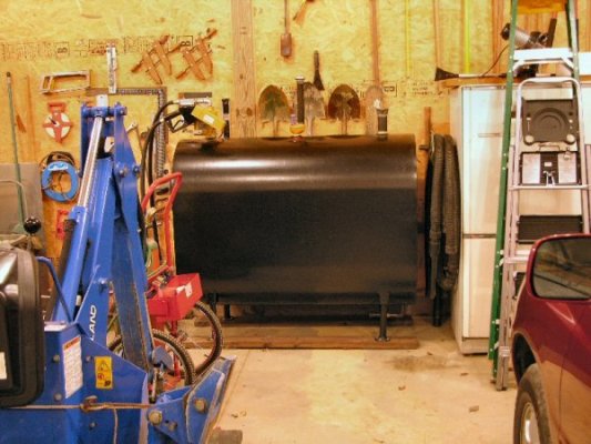

I have said this before but it bears repeating, you can get a used 275 gallon oil tank that was used for home heating oil for practically nothing and in some cases free. Around here lots of folks are converting from oil to propane or natural gas and glad to get rid of the home heating fuel tanks. In one case they even gave us the oil in the tank and the tank itself.
You can have as little or as much off road diesel delivered to that tank (we use Cambell Oil) and since it is "off road" it will be much cheaper since you won't be paying the road taxes on the fuel.
I don't use nearly as much fuel as I used to since we no longer have our Internet business so we have 150 gallons delivered as we need it. That normally lasts us a long time so I add a jug of stabilizer to the fuel as it's being pumped into the storage tank.
All I need to do is back up close to the tank and fill up the tractor via a 110 volt pump. I use the same nozzle as the fuel stations so it shuts down automatically when fueling is complete. No mess, no tangle of fuel lines, no hauling, no 4 bucks a gallon, no sweat.

My concern about the used home heating oil tanks is potential rust inside. Old tanks that have been around for a long time, in use or not, might be rusty and I don't want that going into my engine. Of course a filter helps but I don't know if that's enough. The few tanks that I saw around here were pretty scruffy looking on the outside, unknown on the inside.

I have seen a lot of outdoor tanks that have rusted through from the outside in. However if an oil tank was kept inside in a heated area such as a basement w/oil I don't see how that would be possible from the inside out considering we're talking oil here. The tanks do collect some thick crud in the bottom from years of storing oil but that can easily be cleaned from the tank before re-filling it with good oil.
I do nonetheless pump my oil through a Goldenrod water-block spin-on oil filter designed to remove debris and moisture.
