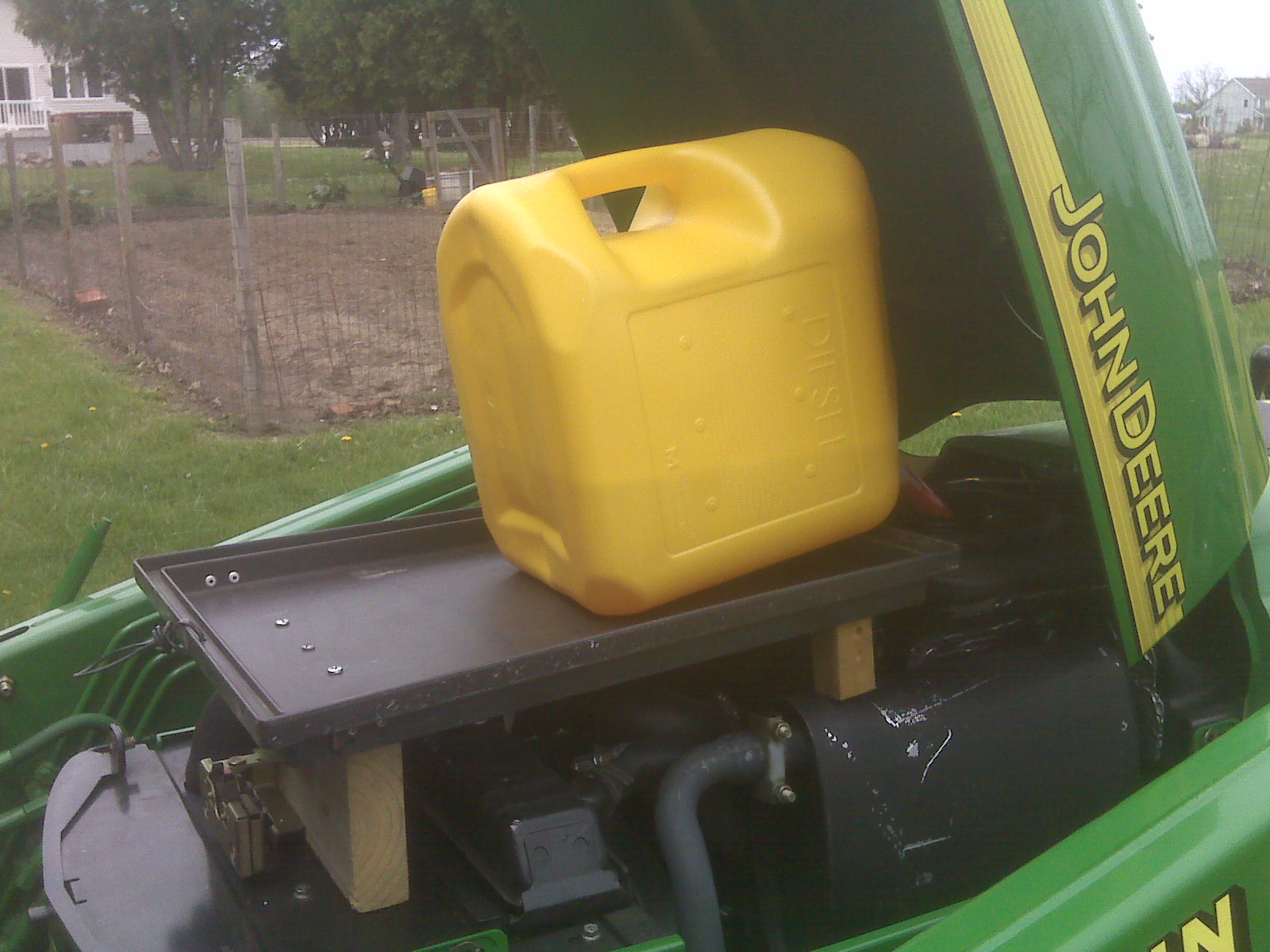

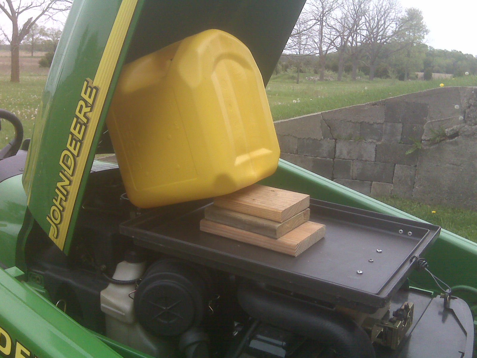

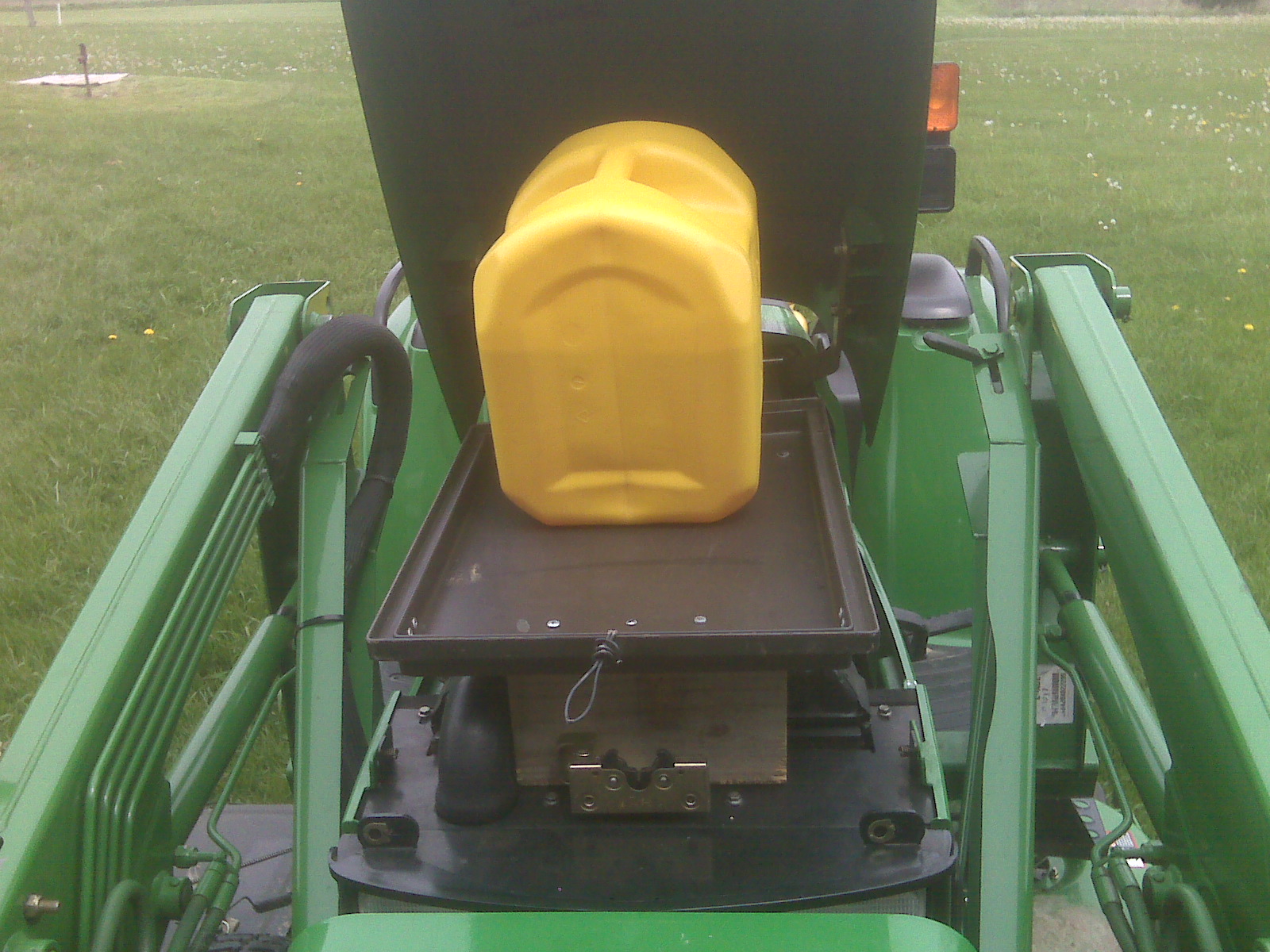

I have NEVER fueled my JD 4210 with the hood down...and since I only use it 100 hours a year, 5 gallon cans of diesel work well for me. I made a fueling aid from a plastic tray with wood blocks screwed underneath it to make it level when I place it over the engine compartment. Set the can atop the tray, open the spout and vent, cover the spout hole with a finger and tip the can forward into the filler neck. Almost no spillage at all as it empties, and you don't have to hold onto it. The wood blocks can be added under the can as it empties.
Just make sure your tank will hold the contents without overfilling !!!

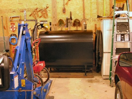

Here's our setup. You can get these fuel oil tanks cheap if you watch the local paper or Craigslist. There's always someone putting in a new high eff furnace that switches from fuel oil to nat gas. We got 2 for free so far.
The pump came from Northern Tool. The local oil company comes to our place to fill it when needed.
It all depends on how much fuel you need to keep on hand. Prior to looking at some additional land (see prior posting), this would have been too much fuel and I'd worry about the fuel going bad before I used it. Your suggestion is now a viable option. Another great idea -- thanks!
