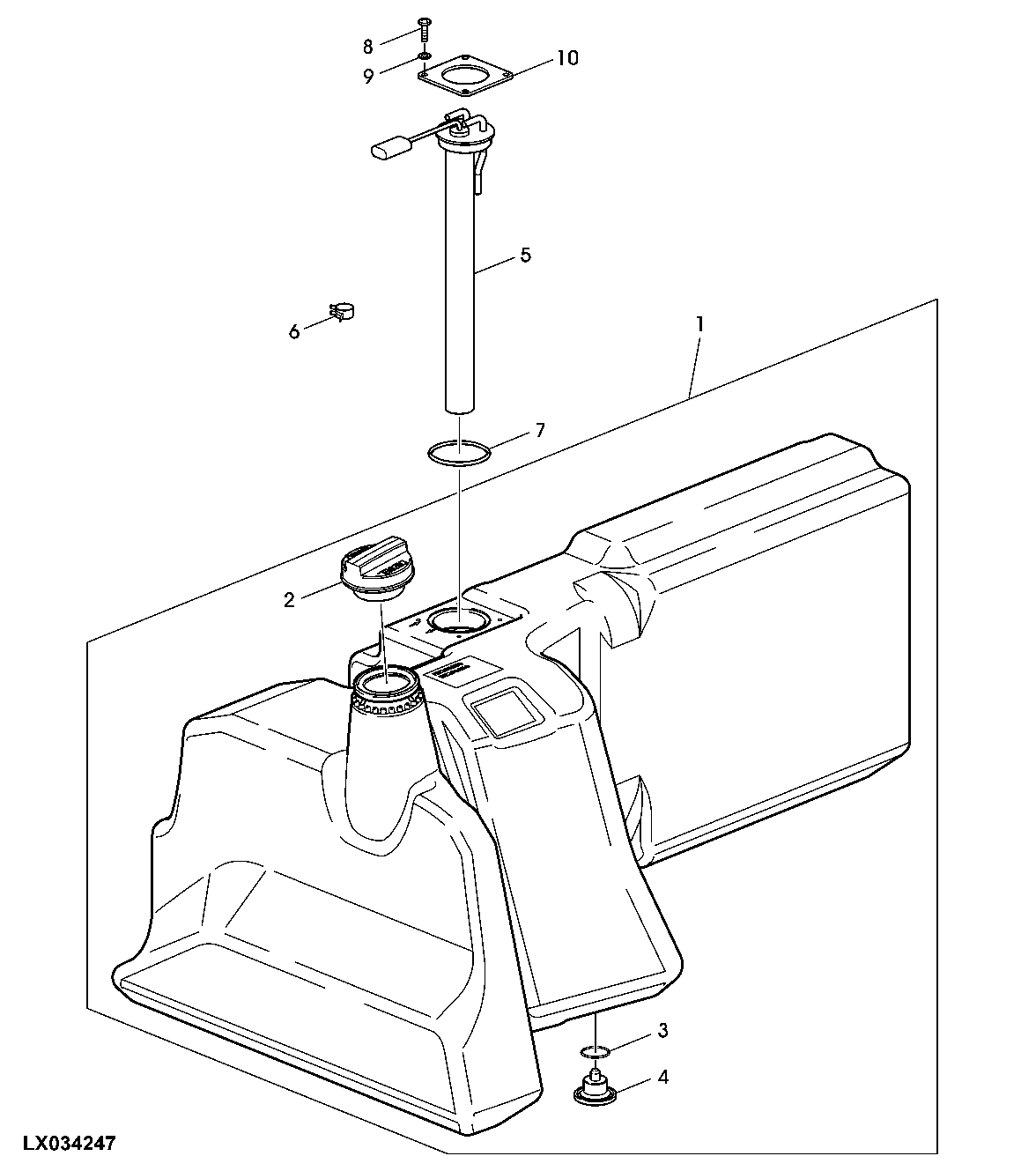

My JD 5720 has only done 2000 hours and it is suffering from a fuel issue that Im yet to get to the bottom of. I have replaced all the fuel lines on the suction side of the injector pump as well as both filters but I'm getting air in the system. After about 10 mins at 2100 RPM it starts " hunting " and blowing smoke at the same time the rpm drops down to 1100RPM or there abouts at full throttle . I stop the tractor bleed the system and air is present where could this be coming from?? Im thinking that the water separator filter housing my be defective or the small inline prime pump. Has anyone out there in tractor world had this problem? Have tried asking local JD service center but all there interested in is coming out to take a look themselves and charging a small fortune for the privilege to do so.
HELP!!!!:mad:
/ Fuel System Problem John Deere 5720 #2
I wonder if the suction tube(parts key #5) could have a small crack in it??

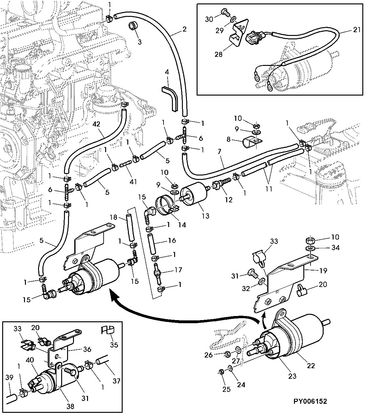

/ Fuel System Problem John Deere 5720 #8
I don't have any experience with aftermarket filters. I was looking at the diagram for fuel hoses on your tractor. It is somewhat different than our North American tractors but similar. Are your fuel lines like this? I see several connections that could be source of leak. Besides the obvious hose conenctions, there are three quick connects on primary filter and suction side of pump that could leak. (items 12 & 15)and check valve (item 17). Another item to look at is the orifice (item 41). It can get clogged and cause excessive pressure to injection pump and can make automatic purging of air not work as well. If the orifice is missing, it can cause insufficient pressure to injection pump due to too much fuel dumping back to the tank. I have seen alot of these orifices missing when someone replaces the hose without reinstalling the orifice. PY006152_______UN14NOV07.gifPY006152_______UN14NOV07.gif
#9
My machine doesn't have that spill back line where item 41 is located. When I replaced all the fuel lines I did away with those quick release type hose clips (that come from factory) with worm type hose clips to eliminate problems at connections. The only item I haven't looked at is that check valve (item 17). I was reading on a forum the other day a guy said every time that John Deer service guy comes out to do a service he replaces the water filter & housing every time so that's why I'm wandering if the factory one is no good.
