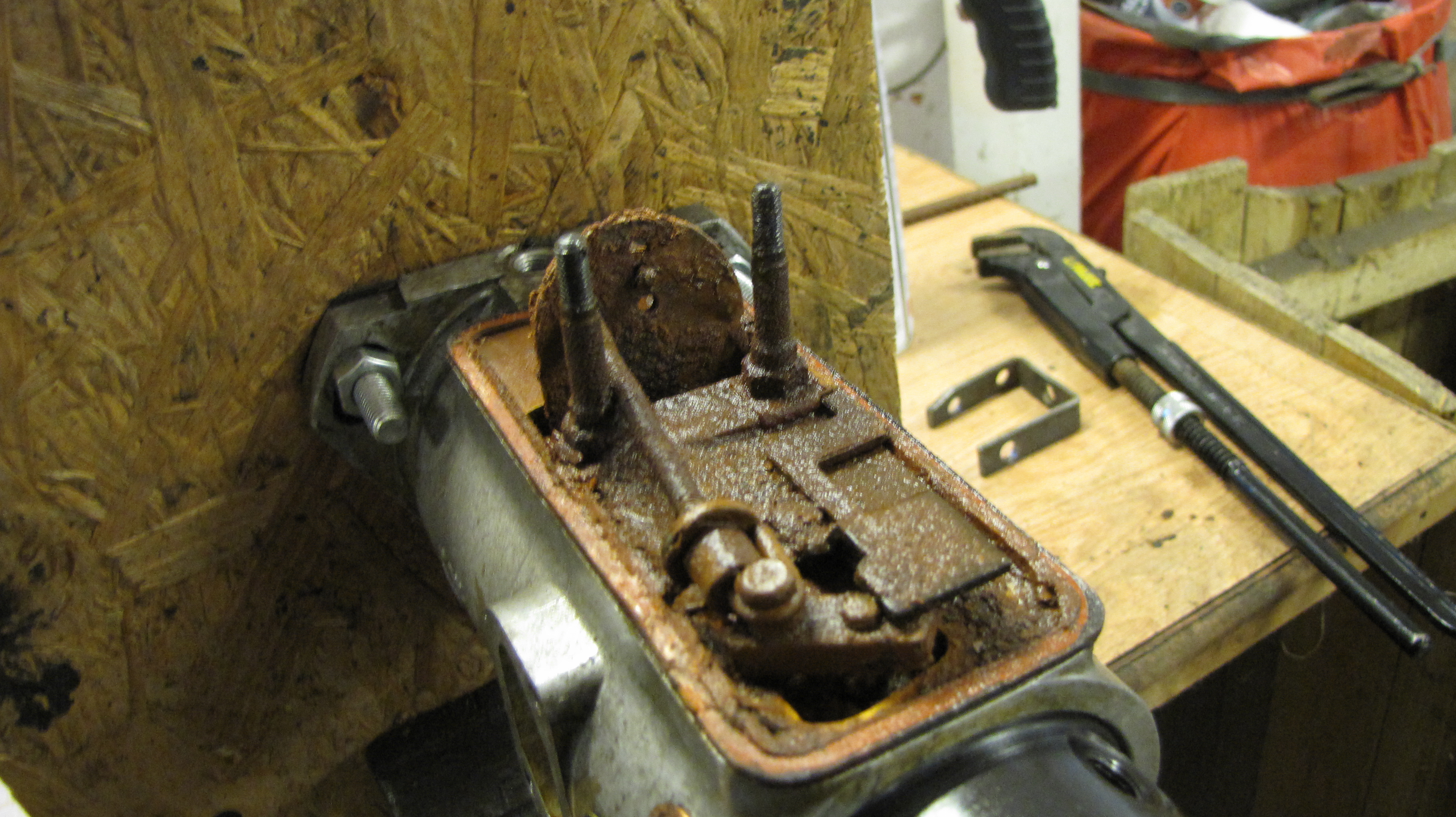

It had enough juice to start the engine before this problem, but I have been using a larger battery, that I borrowed from a fried, with plenty of power, for use while bleeding the fuel system, and that can also not get the engine running.
Yes, I would guess that metal particles would have released inside the fuel pump while the axle broke, but as soon as the axle broke, no more fuel was delivered in the fuel system so I don't see how it could have made it into the injectors.
But I am pretty sure the injection pump broke because of dirty fuel, and when disassembling the broken fuel pump it was absolutely filthy (see picture)
But it ran fine up until the pump broke, so I do not think the injectors would be faulty enough that the engine cannot start, and certainly not all four at the same time. And the white smoke in the exhaust when attempting to start does also imply that fuel is being injected.
