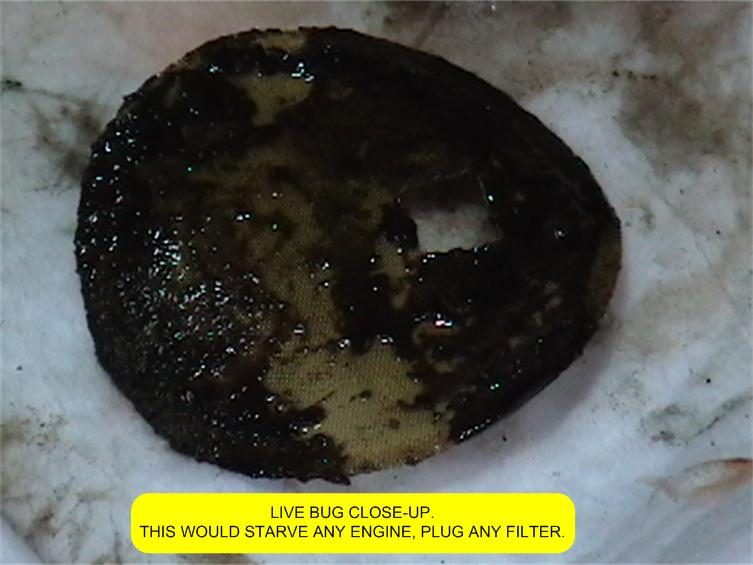

If you've ever seen muddy looking gray or gray-green goop in the bottom of your sediment bowl, that's a sign to suspect diesel bugs. If your sediment bowl has remained otherwise clean, that's probably a ghost you don't need to chase down right now. But while we're on the subject, how often do you have to dump water out of the sediment bowl? If you've never done it, take a quick look right now. If it's all yellow, you're ok. If there are two distinct layers - clear below, yellow above - the clear level is water. Dump the bowl. If it's all clear, your engine might be trying to burn water.

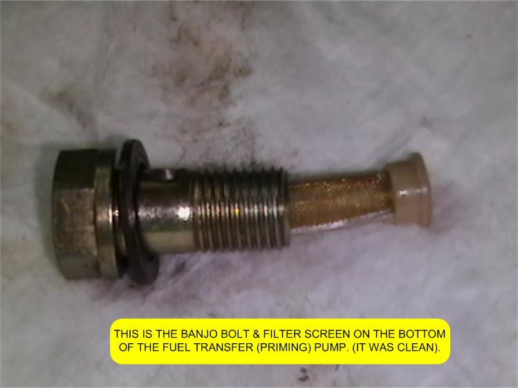

Tommy's describing an inline screen further down the fuel path. Follow the flex line from the sediment bowl to the pump. The fitting at the pump end has a screen inside, which has often been reported as a cause of blockage. Also, the hoses on these things aren't of the highest quality either. There have been reports of them collapsing internally, another potential cause for blockage. So it's probably a good idea to do a health & welfare check of ALL the flexible fuel lines.

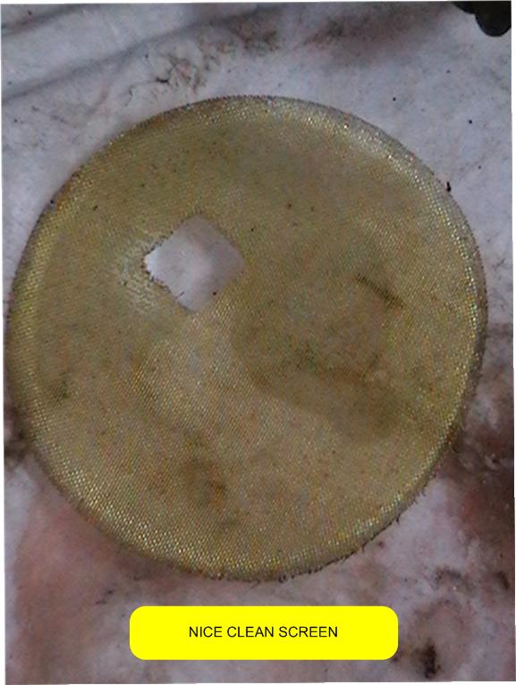

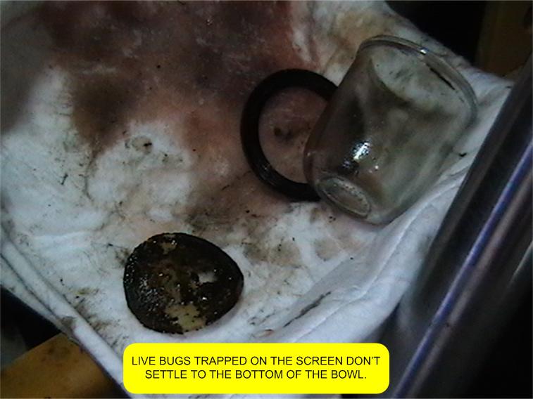

The sediment bowl can appear clean as a whistle (bugs are microscopic) but will coagulate on the screen. Best to remove the bowl and check the screen anyway.

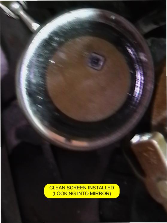

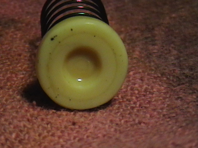

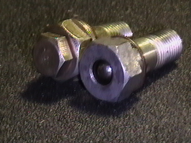

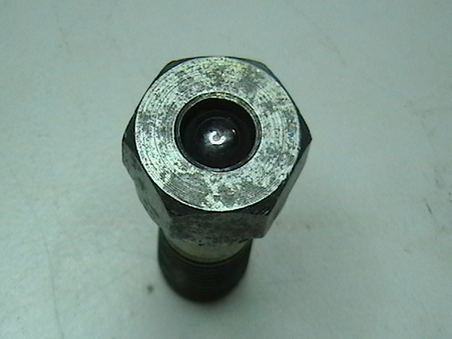

Greg,

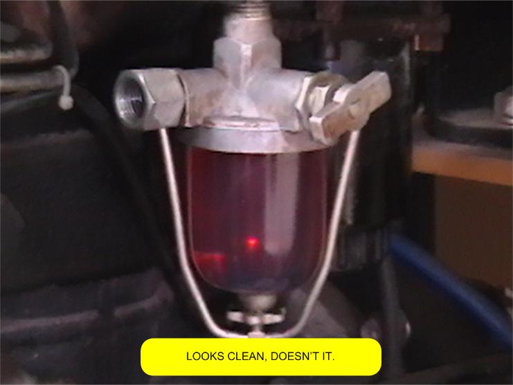

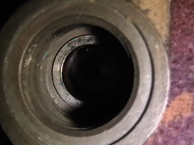

I'm speaking from personal experience with my dozer's OEM sediment bowl and the issues I had. The sediment bowls are the same. I can't find the thread I had on CTOA about it, but I will post the pics when I get home tonight.
Clear bowl, plugged screen, and the damage to the lift pump and injection pump relief valve, which wouldn't seat and allow fuel pressure to develop - the fuel was just flowing through the injection pump, air and all.
Yes, the live bugs will pass right through just about anything, it's the dead ones that do the plugging.

I forgot to say there are several screens in the banjo fittings on many of the machines though I cant remember what yours is.

In my case I found the valve seats in the lift (transfer) pump were pitted so badly it would barely pump (see pictures). And even though I didn't disassemble it, I could tell that the pressure relief valve was corroded too.
Before: YouTube - Lift pump 1.mpg
After: YouTube - New valve 1.mpg
Note: The new pressure relief valve is adjustable and repairable, the old one is not, it's a sealed unit.
