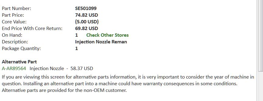

Maybe a stupid question, but what is A&I?
/ Fuel filter on John Deere 5520 #11
It's a parts company that JD bought part ownership of that sells parts for farm equip by independent dealers plus JD dealers. Here's an example of a JD part I looked up earlier on another forum. The lower PN is for A&I. Some parts from A&I are dramatically lower than JD prices. I've had an AC evaporator in my JD 4255 for several years with no problems. Most of the time on can just add A- preceding part number on JDparts.com to get a price for A&I part for JD
