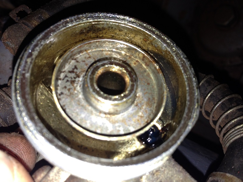

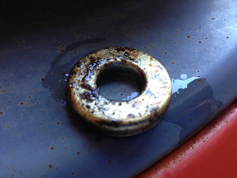

So had some time today to look at little deeper into the filter issue I have had, and here are the pictures.
Looking at the bottom of the filter housing after I removed the bolts holding it on. See anything that should not be there.
This is what I removed from the filter housing. Seems the previous owner failed to remove a filter top sometime in the past.
New filter (Baldwin PF-872) and o-ring fit without issue. Used the Baldwin because it has a metal bar running top to bottom so crushing should not be an issue.

I suspect the answer was stated as the bar prevents crushing, but so does having removed the piece that was left behind in the housing previously, so essentially no need for anything beyond OEM. I'd be curious if the filter top that was found in the housing was from an OEM filter?

I am not opposed to dealers and buying parts from dealers, but the closest dealer I know of is over an hour away, if there had been one here where I live I would have been down there asking about why the filter would not go on correctly and they might have said hey maybe you have an old filter cap stuck on the inlet. But there is not a Kioti dealer here, so I do the best I can.
