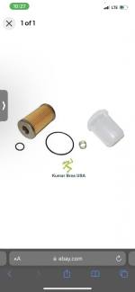

Oct 23, 2022 / Fuel filter kit #1 Brady D Silver Member Joined Oct 29, 2021 Messages 216 Location Southern Middle Tennessee Tractor Ford 1910, Case farmall 95, John Deere 317g I’m replacing the fuel filter on my tractor and I saw a kit with a new bowl, filter, o-ring for the bowl but then there is a very small o-ring and a spring what is the spring and small o-ring for Attachments 1AA8015F-C2E2-4F5A-BEDF-402B3294C82C.png 1.1 MB · Views: 114

Oct 24, 2022 / Fuel filter kit #2 K5lwq Elite Member Joined Aug 6, 2017 Messages 4,922 Location Mineola, TX Tractor Kioti LK2554, Branson 4815C, Satoh Beaver, Speedex The o-ring goes on the tube inside the filter housing. The spring goes under the filter and pushes the filter up to seal it to the small o-ring.
