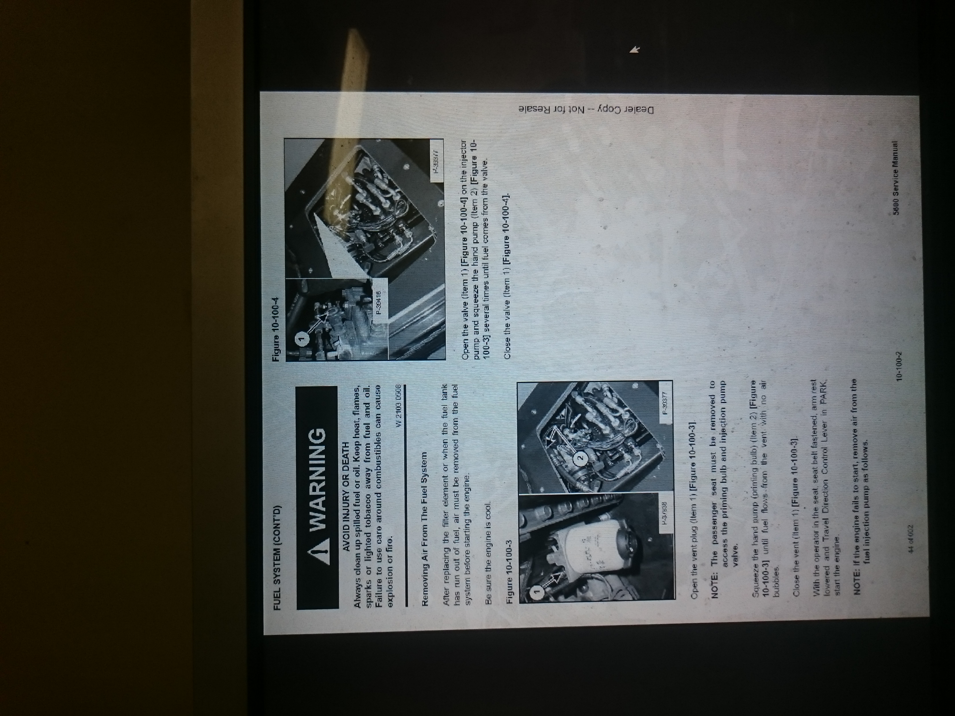

I would think you need to pump it to prime the fuel pump and injection pump
/ Fuel Filter Issues - Model A Toolcat #23
On the trucks and loader at work I pump the hand primer and have somebody start the truck at the same time.....keep pumping till it starts...
#24
Tried again to get the toolcat running today. Put the space heater on and pumped the hand primer well over 500 times to no avail.
The primer bulb never got 'hard' and the toolcat never found fuel to start with. Engine was nice and warm with no glo plugs required.
Had the wife try to start after 500 pumps while I continue to pump the bulb. The fuel tank is 100% full.
Even at a quarter ounce per pump, there should have been plenty of fuel pushed far enough and available.
Going to call my country mechanic to see if he is willing to make a house call. Otherwise I am S.O.L. this winter.

I would be questioning if the primer bulb is working after 20 pumps. Most times you should barely feel/hear the check valve in the bulb shutting if it is working properly too. Also, it should feel like there is liquid in it vs just air. If there is fuel and the bulb is operating correctly, it doesn't take long to bleed out the air.
/ Fuel Filter Issues - Model A Toolcat #33
The primer bulb has an arrow showing direction of flow. Take the hose off from the inlet end of the primer bulb then put your thumb over the end of the bulb and squeeze the bulb and release it. If the bulb expands back then the check valve is stuck, if it stays collapsed until you release your thumb bulb is working.

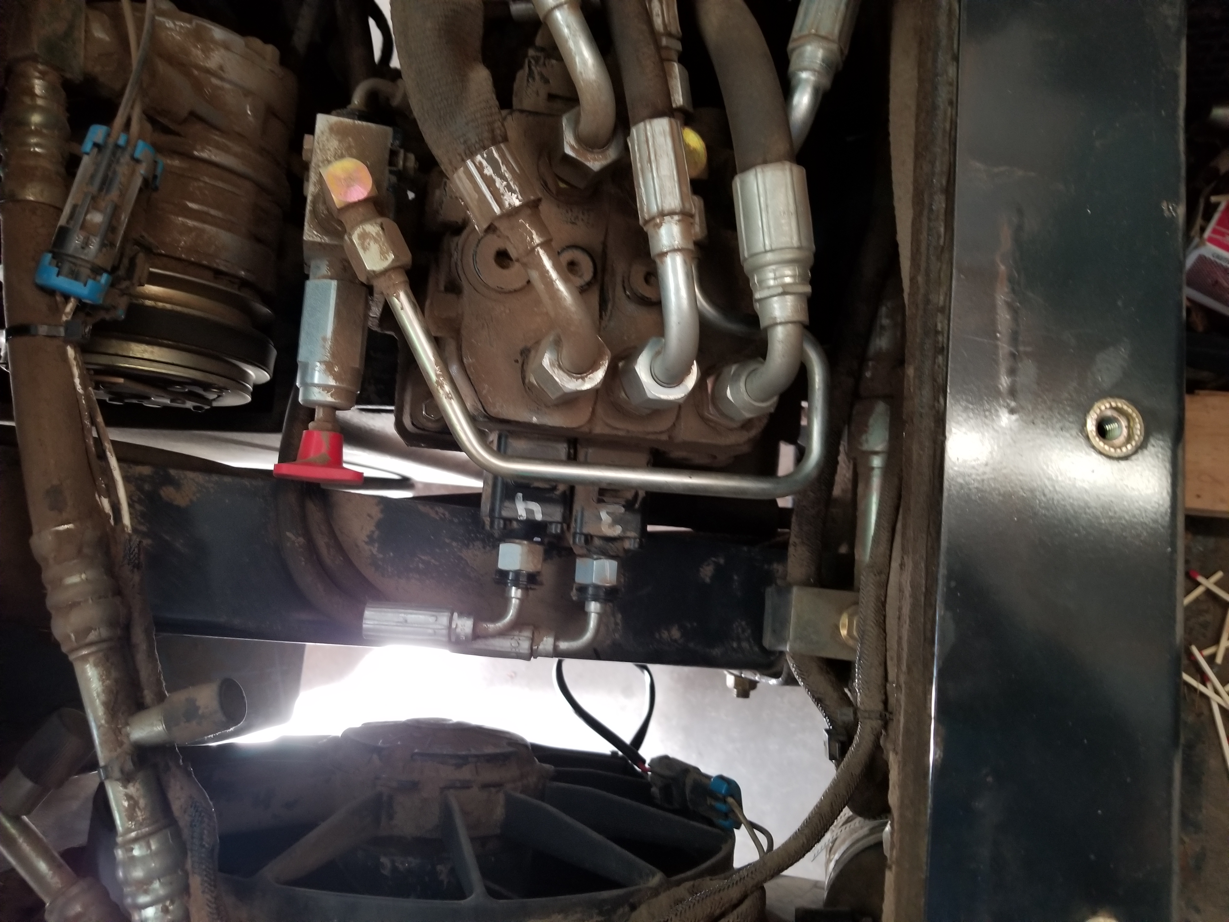

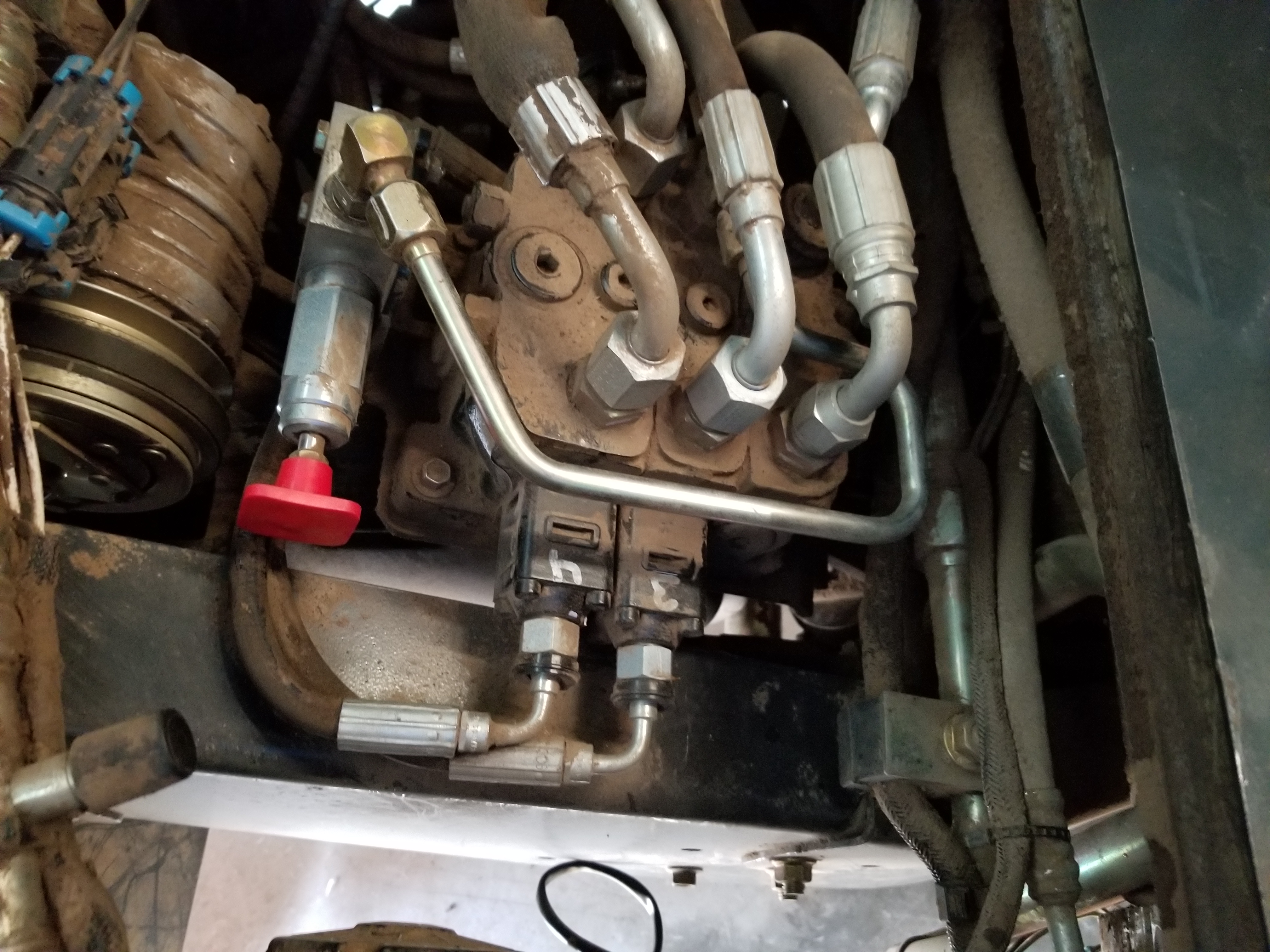

Tried to pull the Toolcat with the 3/4 ton pickup to no avail. Is there a hydraulic release so I can try to load a trailer?
The toolcat's brakes come on with the lack of hydraulic pressure so, no, there is not a release valve. I have read that the early TCs could be pushed easier by screwing in special brake release tools. Maybe your dealer has these?
