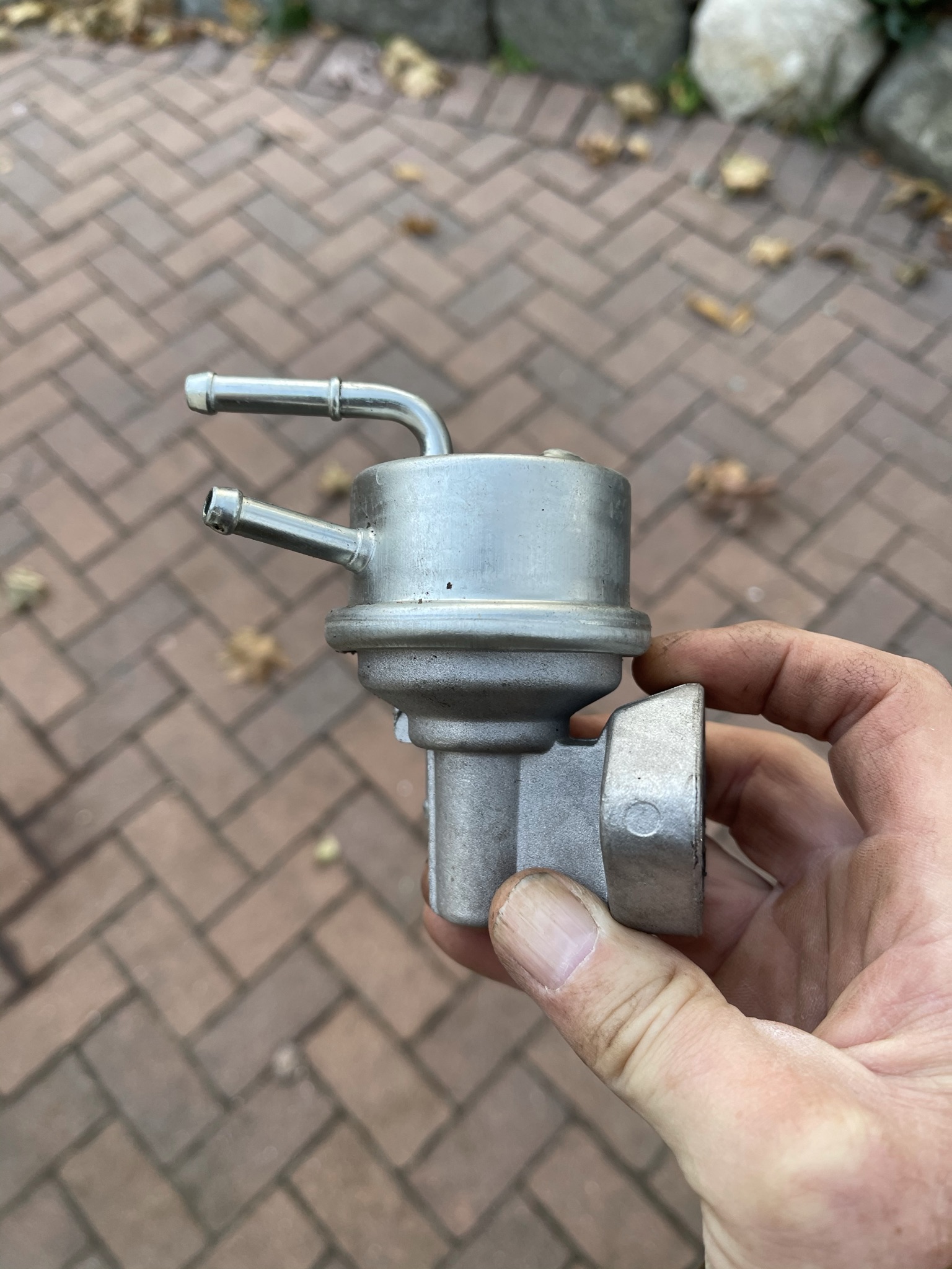

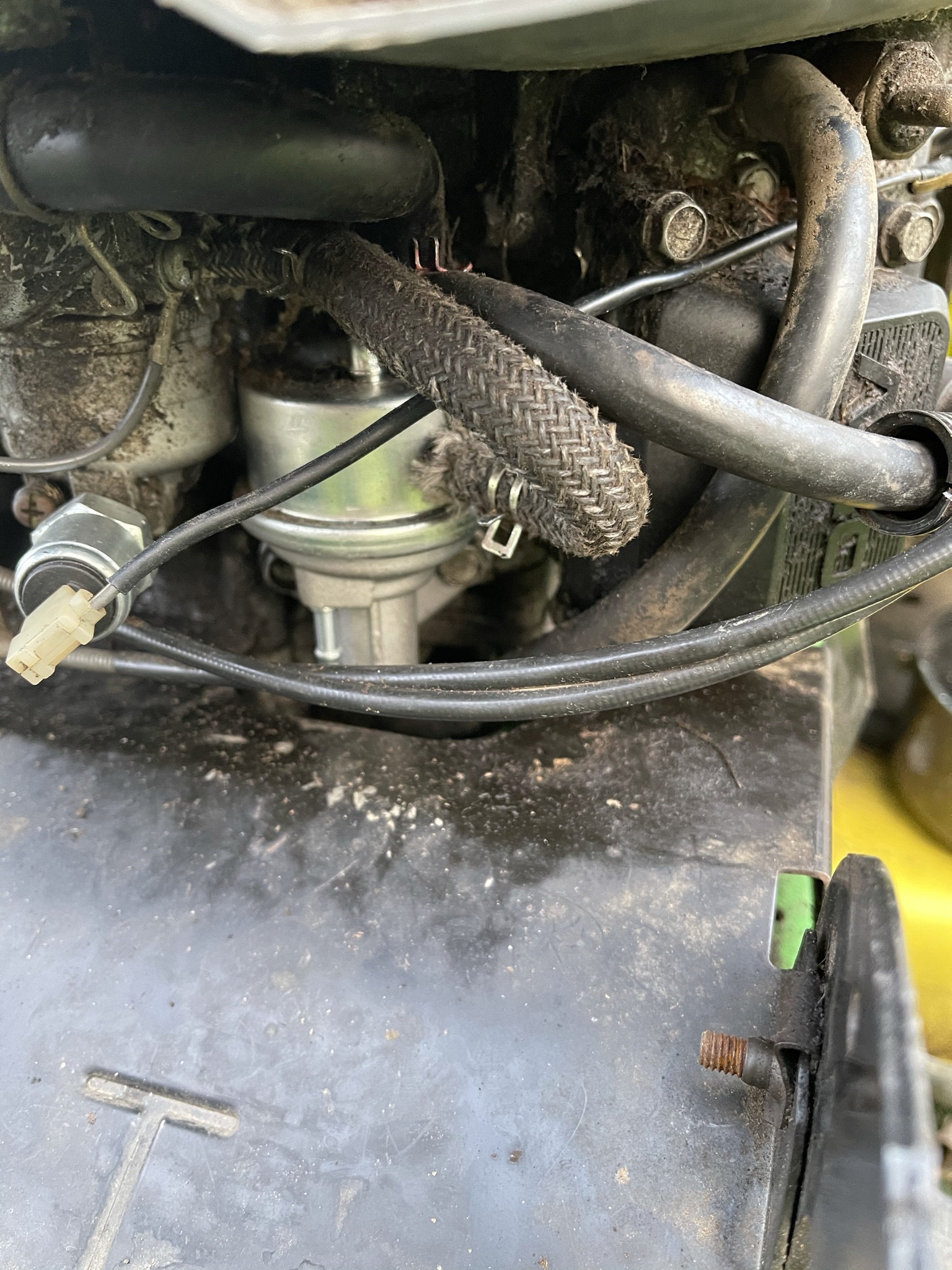

so this is the fuel pump I believe I have it connected correctly same as it was before and ias shown on youtube videos.

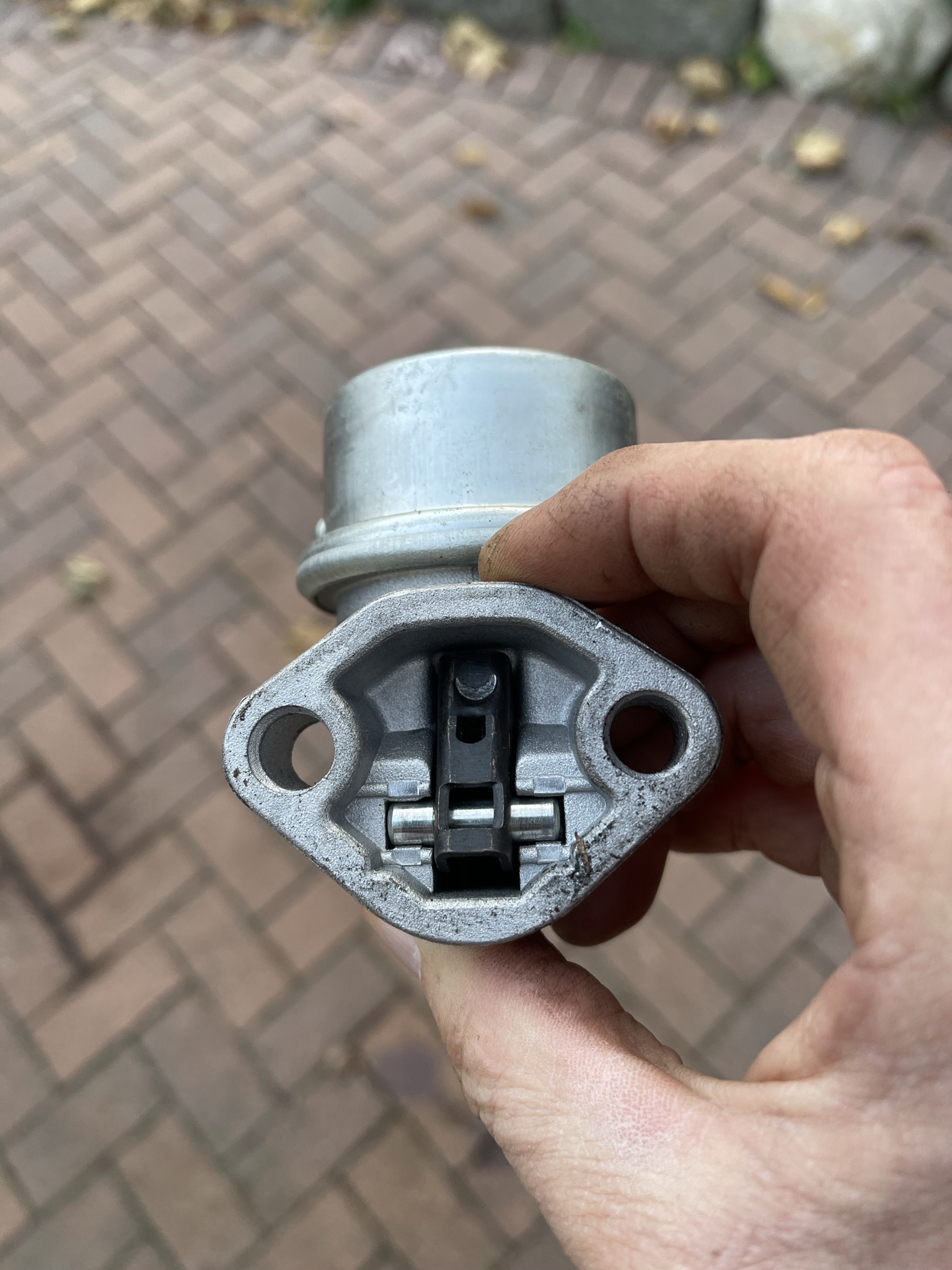

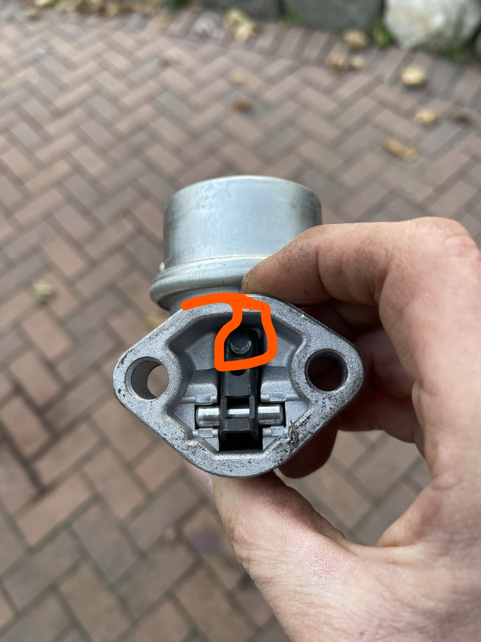

The first picture is of the back of the pump. What the spring contraption and how does it work. Im not getting any real fuel from this pump when I crank the engine.

If you put the supply line on and press the top fuel should come out the other fitting...Inkedfp_LI.jpg fuel pump.jpg

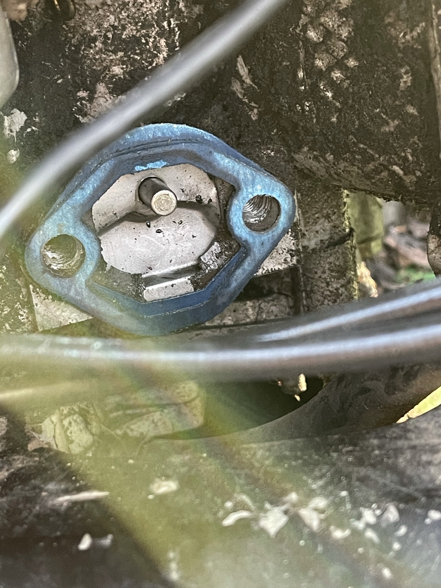

Can we assume that the little actuator rod that activates the pump is still in the block? If it ran fine before you replaced the pump, we can probably assume the cam hasn't failed.

the cam seems to vibrate a lot when I feed the carborator fuel line from another source and the engine runs fine. Can anyone tell me how this works what is going on? is there a vacuum in the carborator that pulling fuel? what is this cam doing? when you attach the fuel pump the spring hinge inside the back of the fuel pump is obviously pushed in. But what does this do?

so no directions but youtube shows how to install it. intake at top and out on side. see pics above. I feel confident that thas right and it matches my picture of fuel pump connections that i took before touching anything.
