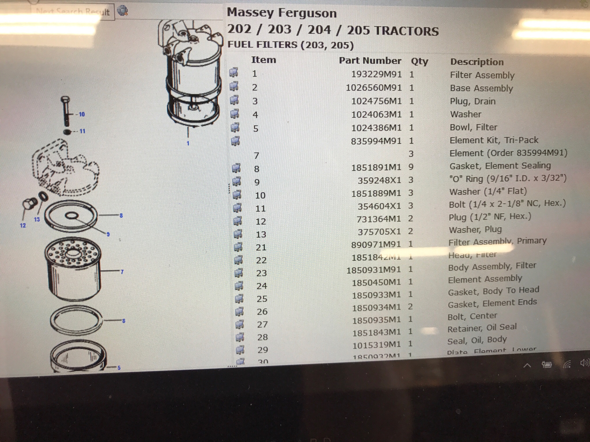

I have a Massey Ferguson MF205 tractor. I was recently bleeding the air out of the fuel line after a repair and although it didn't seem like I tightened it too hard, the dumb thing broke off. I have no idea where I can find a replacement, but any help would be appreciated.
/ Fuel Bleed Screw #2
You talking about #12 here?

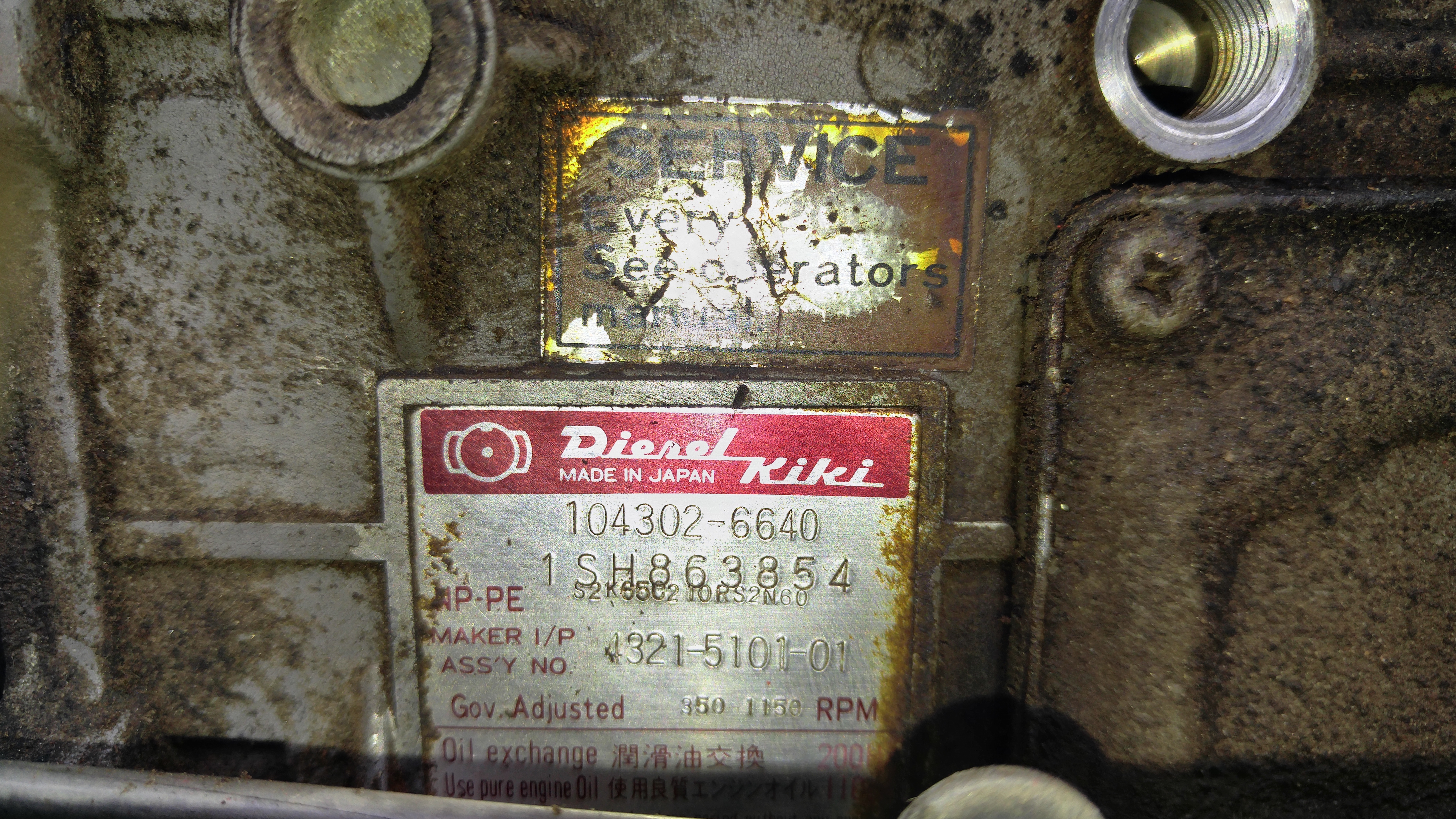

Shaneard, unfortunately no. Its the bleed screw on the injector pump. It's a Kiki pump and the bleed screw is on the top right. I took it off so you can't see it in the picture, just the empty spot where it should be.
/ Fuel Bleed Screw #4
The P# for the bleed screw assembly is>> 104302-6640.. Diesel Kiki is now called Zexel..
You can look online or ANY injection shop will order it for ya..
The copper gasket P# is>> 026512-1540
OR you could go buy a 5mm bolt & gasket to fit the center..
