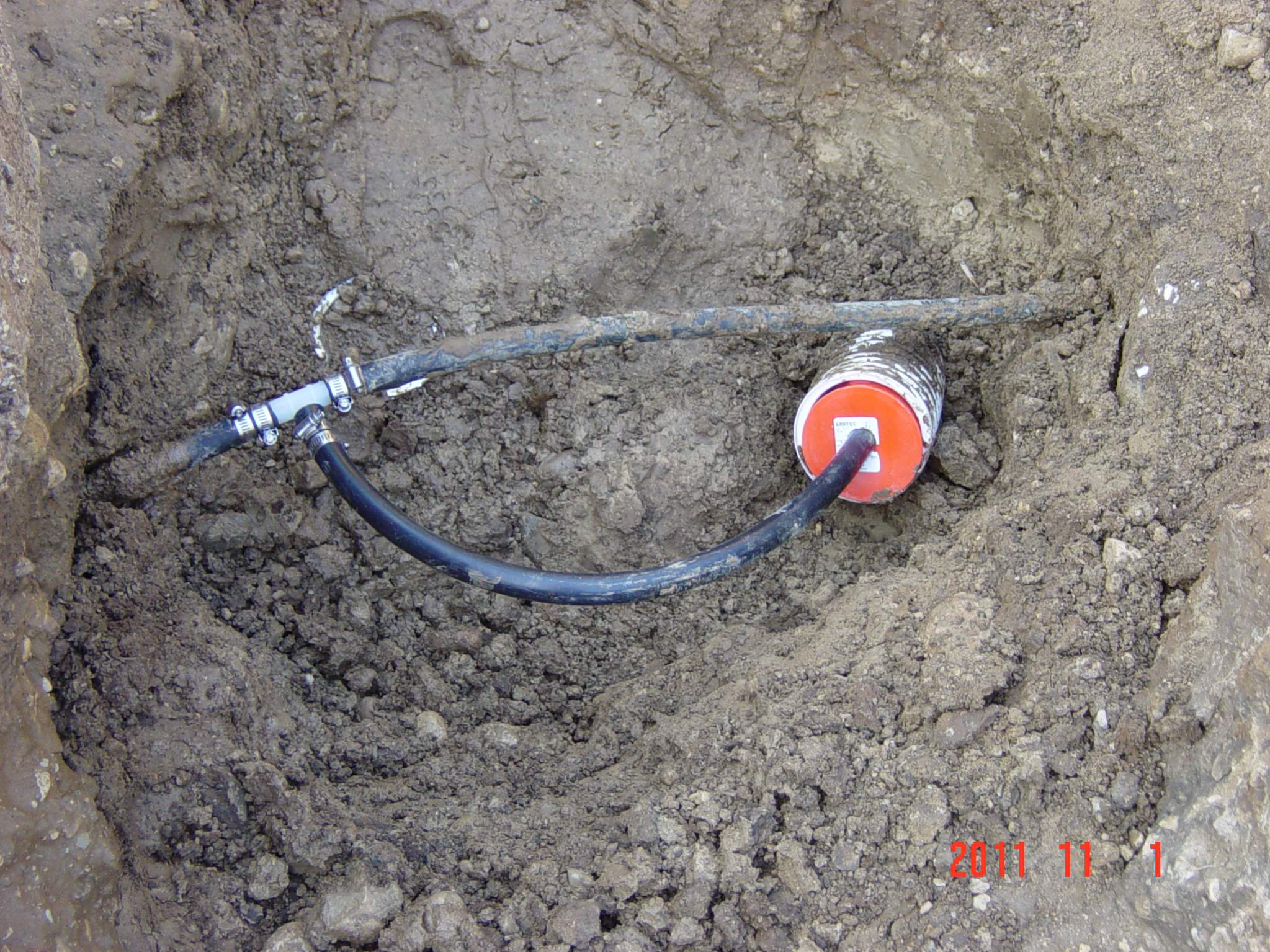

Could not get my fancy nozzle through the "T". Took it out and took a piece of 3/4" pipe to see how the pex went through it. As I suspected, the curl of the pipe forces the tip to slide along the wall and then hits the "T" fitting. Usually I take a step drill when I install such fittings and chamfer the edge, but I guess I didn't. DSC02975.jpg
Just a picture of the "T" in question when it was installed three or so years ago. Drainage pipe goes to my frost free hydrant a few feet away at the garage.
So, I tried to bend the nozzle inward and promptly broke it off! Then I cut the pex at an angle so it would go through the "T" which I had tried before, but never having tired it in a mock piece of pipe.
Tried again, and it finnally got through the "T". I sat in that pump house feeding that line half an inch a minute, envisioning having a hot shower that night. The first in two weeks!
Then my hundred feet of pex ran out! Probably, if I had addressed this situation by attempting to thaw the line with my current method, rather then covering with snow and "waiting" for it to melt, I would not be in such a bad position.

Instead of going through the T can't you just take it apart?
