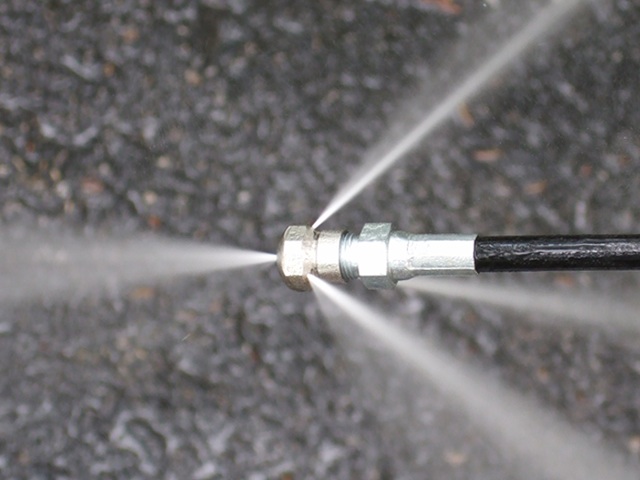

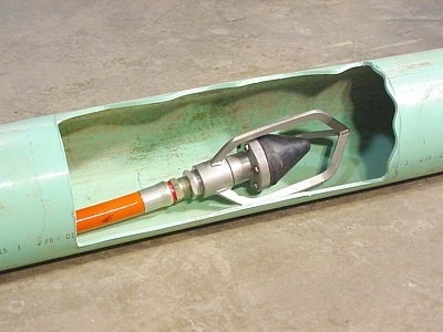

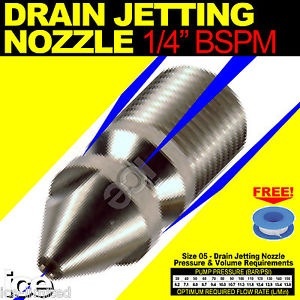

Look for some nozzles of the type used for cleaning tubes or such things. They should help pull the line forward. A pressure steamer may be what you are looking for.

I figure the nozzle has to be something that is a good trade off between a fine jet that goes far and one that can deliver enough water at well temperature to melt ice reasonably quickly.

The commercial/industrial type water jetting usually require high pressures.

Anyway. It was warmer today then on the weekend, but felt much colder, so I couldn't get myself to crawl down the hole. I did play with jets. I discovered that with out quite low domestic water pressure that the hole size of nozzle I had guessed would work, didn't squirt the water very far, after going through a hundred feet of the 3/8 pex. So I reduced it. Then had more trouble with ice chrystals blocking the nozzle, but this should be OK once I get going. Just hope no dirt or debris gets in there!
This nozzle thing I made, might even stand a fighting chance of going through the "T"being of a tapered design. Now I just wish I had a small float switch with which I could start and stop my return waste water sump pump.
