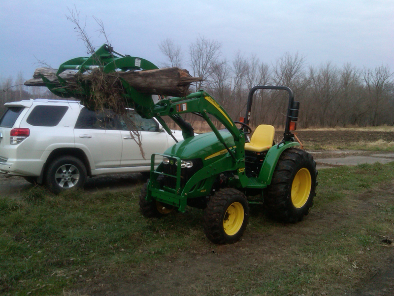

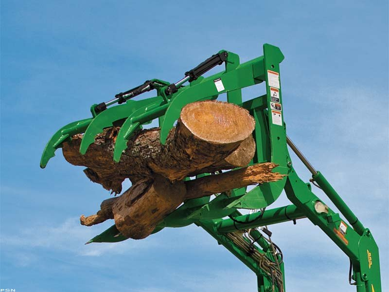

AV20H model has only one hydraulic cylinder which is centered on the unit.
   / Frontier Root
#13
LouieJunior said:
<img src="http://www.tractorbynet.com/forums/attachment.php?attachmentid=258889"/>
Would you see an advantage having two cylinders like the E model?
   / Frontier Root #14
Two is far better than one. When a log turns and holds one open, the other is free to clamp the small debris that would otherwise fall out.
   / Frontier Root #15
I suppose you can get a better grip on irregularly shaped objects, since each of the top units can close independently.
