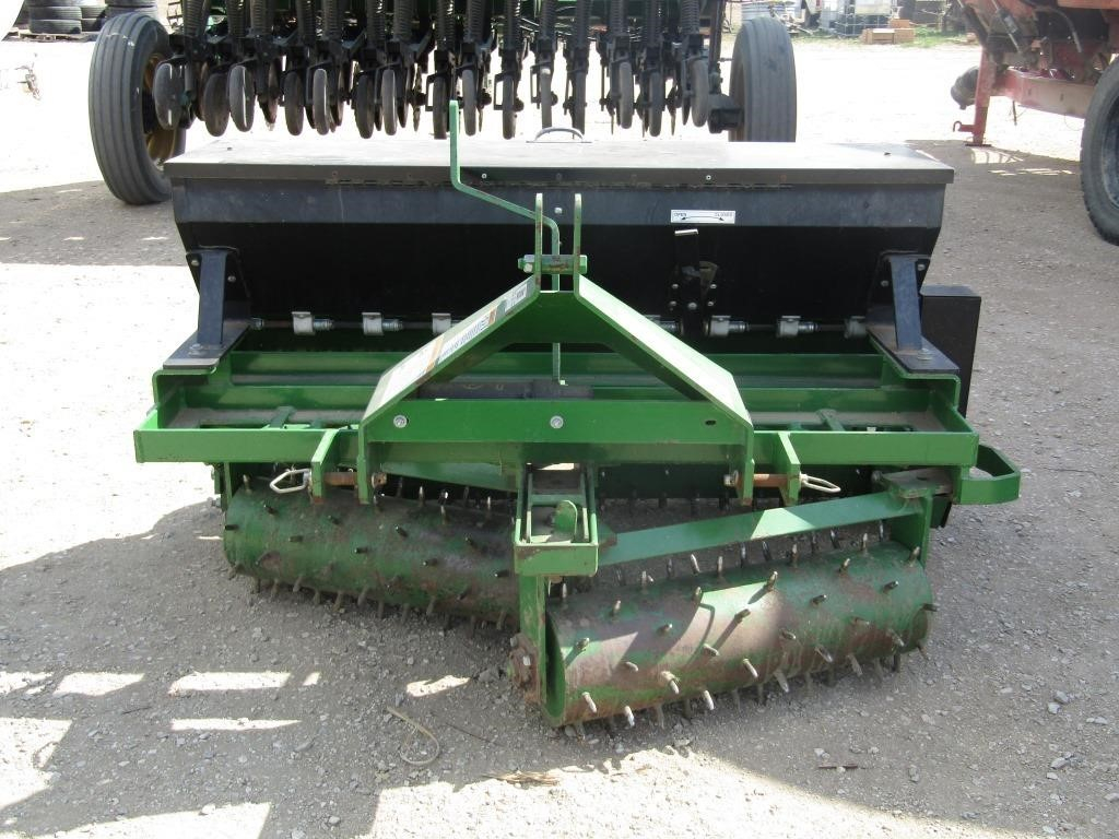

Been looking for a grass seeder for several years and this one is up at a local auction:
Wondering if anyone is familiar with this type and/or owned one. I would like to seed into prepared as well as unprepared ground. One concern is the lack of any type of soil firming device such as a roller behind the seed drop. What do you guys and gals think?
This is a Frontier OS-1060-M and not finding a lot of info online.

npalen - I agree, information is hard to come by. An overseeder is the only way to go. It needs to be heavy, but I couldn't find the weight. Based on the unit I've used unsuccessfully, I think you need 125 lbs a foot, and a tractor that can handle the weight. I believe the unit under consideration is 5 foot, sells at auction for $2500 - 3,000. Many units for sale, indicate only a few number of times of use (like 3, or 7), which tells me that after the lawn or pasture is amended to some degree of satisfaction, the user stops using the overseeder.
There really needs to be a roller behind the seed drop. Lost ? Maybe you can make up for it with a drum roller. Those aren't expensive, but then, there is the time to go over the field again - unless you can rig it to tow behind the overseeder.

Yes, can always drum roll. Some folks don't worry about packing but I think one needs good seed to soil contact for best germination.

I've never saw one like that. Are the front gangs adjustable?
Yes the front gangs are adjustable angle to change the level of aggressiveness, I guess. Looks like they would help settle the soil and break clods in tilled conditions while loosening up the soil in unprepared conditions.

I read somewhere that grass seed should only be buried to a depth of 150% of it's length.
I've done considerable seeding over the past 5-6 years. My failures have been when I buried the seed to the point of only seeing a small percentage uncovered. In situations where I left a large majority uncovered I've had great success. I finish with a cultipacker.
My larger farmer friend says "Mother Nature doesn't use a tiller". :)

Yep. Grass managed just fine for millions of years. Let’s say that you DO get a little better germination with a seeder. How much more seed can you buy for the cost and maintenance of a seeder? I just wait until there is rain in the forecast then mow and over seed.

I run a 4ft slit seeder, no roller, germination rate is excellent. It's relatively unintrusive to existing turf and de-thatches at the same time.
Mine is an Olathe (now sold under the toro brand), I'm not sure how well the nonpowered type do, especially for overseeding without tearing up existing turf.
I imagine a clutipacker attached to the rear might help, maybe one day I'll try adding a cultipacker to it, or just roll afterwards.
