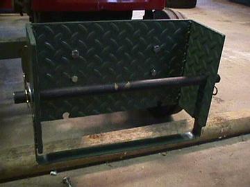

/ Front Weights #4
Roy,
I used the same weights total 151 lbs

/ Front Weights #11
Go under customization and look at the post "brush guard that works". That is how I solved the weight problem.
