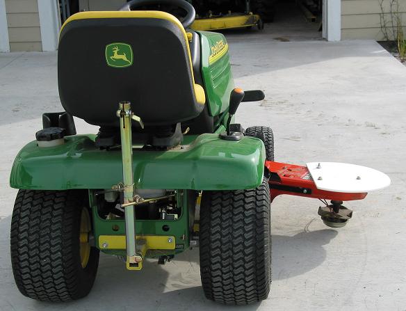

Anyone built a cutter of any sort to cut under electric fences.

Yea thats generally what I'm looking for. I have an old 18hp rider that gets all the dirty work and want to build something quick attach possibly even 12 volt. Got all winter to play.

   / Front Weed Wacker #9
My 16HP riding weed wacker
Here's a fence trimmer I build from a large wheel gas powered string trimmer. It clips on to the mower deck mounts with two pins in about a minute. The original had a 6HP engine, so I geared it up a little and usually cut at about half throttle. The mower height lever raises and lowers it, although it could use more range than the mowers 4 inches. Sure does cut great though. It's spring loaded and pivots around fence posts.

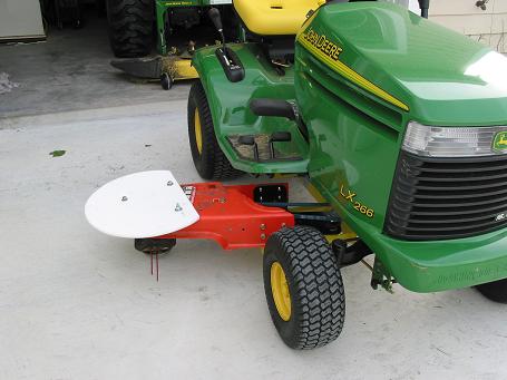

   / Front Weed Wacker #10
Re: My 16HP riding weed wacker
I let it stick out far enough to trim ditches without getting the tractor too close. It needs more vertical articulation, so I think I'll add another hinge so it can float along the ground better.
