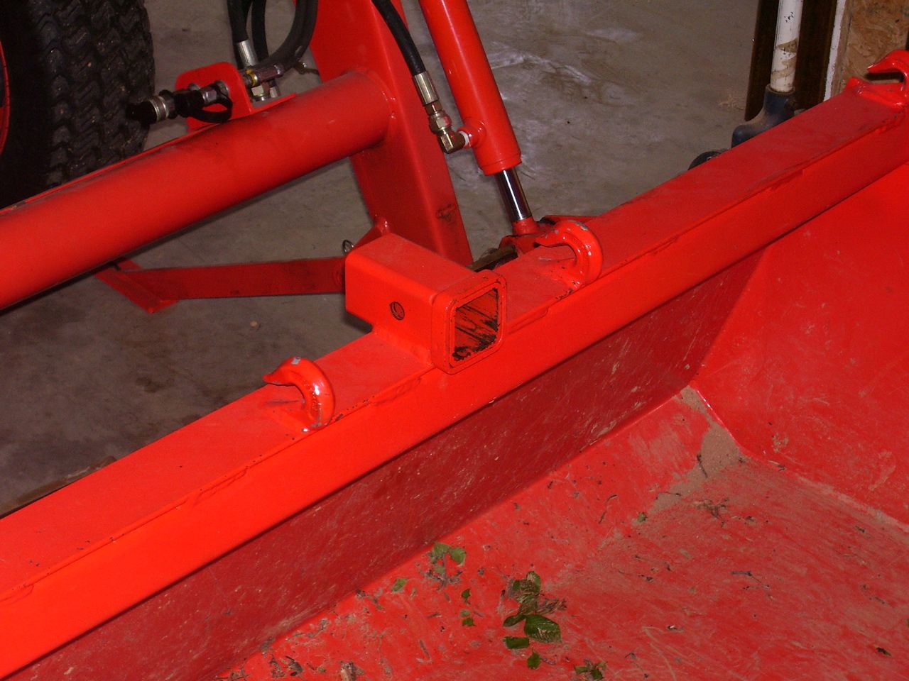

I'm wondering if it is possible to have a trailer hitch receiver (similar to this) bolted or welded on the front underside of a Kubota tractor? I've seen pictures of receivers welded on the bottoms of a bucket - but how strong would that be and might it damage the bucket.
The main use would be for mounting a portable winch.
/ Front Trailer Hitch Receiver #2
Since your your primary use for this is to mount a winch. I'd be worried about lateral pull load racking the arms on the loader and less worried about damaging the bucket.

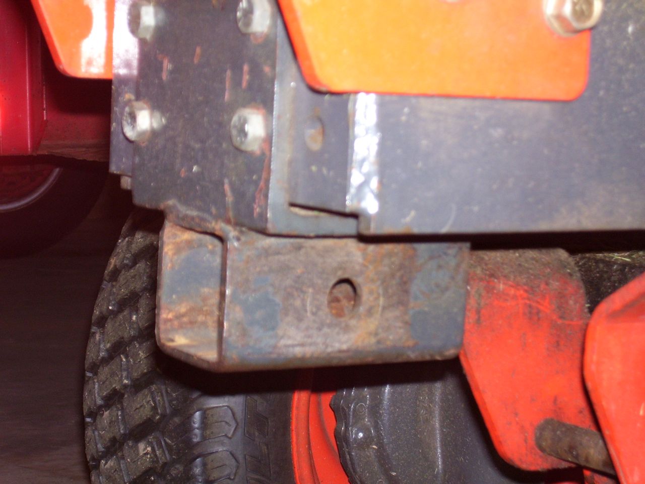

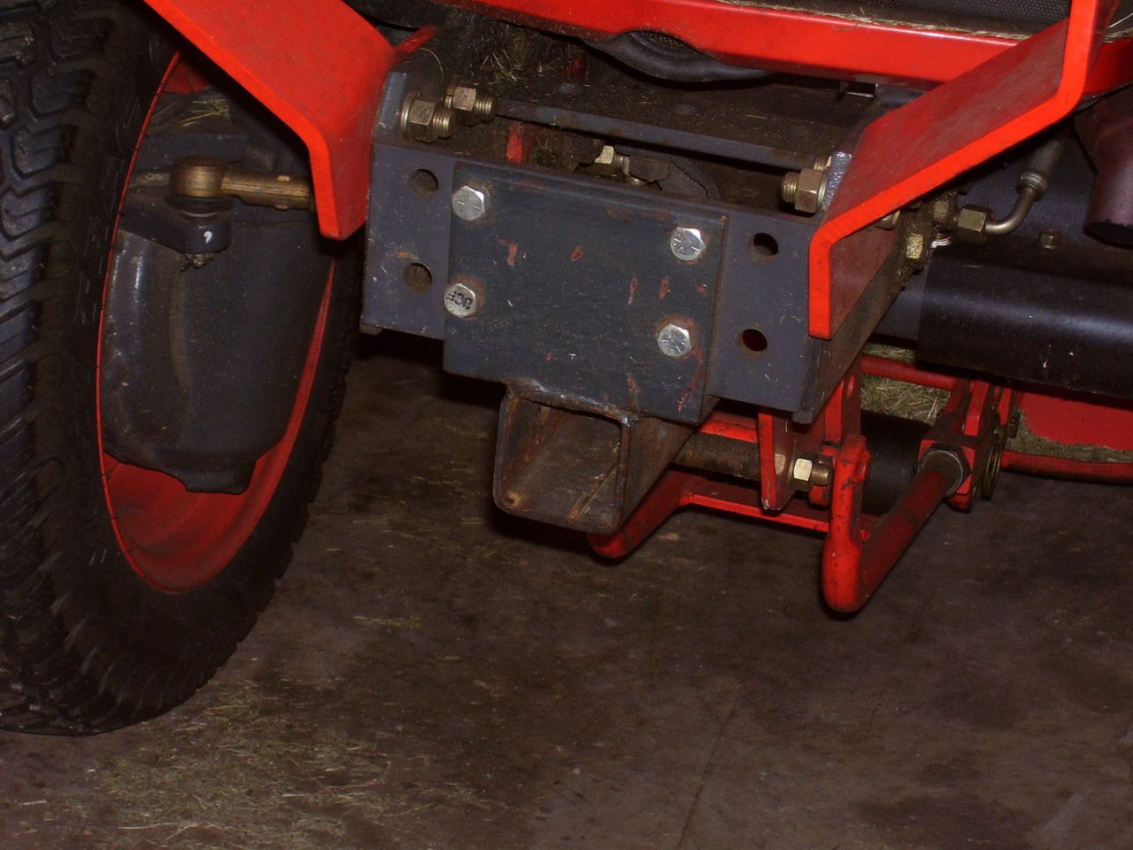

CortezEd, I have this on the front of my B3030. I welded a piece of angle to a scrap piece of 2 inch tubing, drilled 4 holes then used grade 8 bolts to attach it to the tractor. I feel it is quite strong and have used it to move my utility trailer around. If you decide to do something like this make sure the new hitch does not stick to far forward or it may interfere with the loader arms. Good luck! Stanley
Looks like a good solution being mounted right to the frame

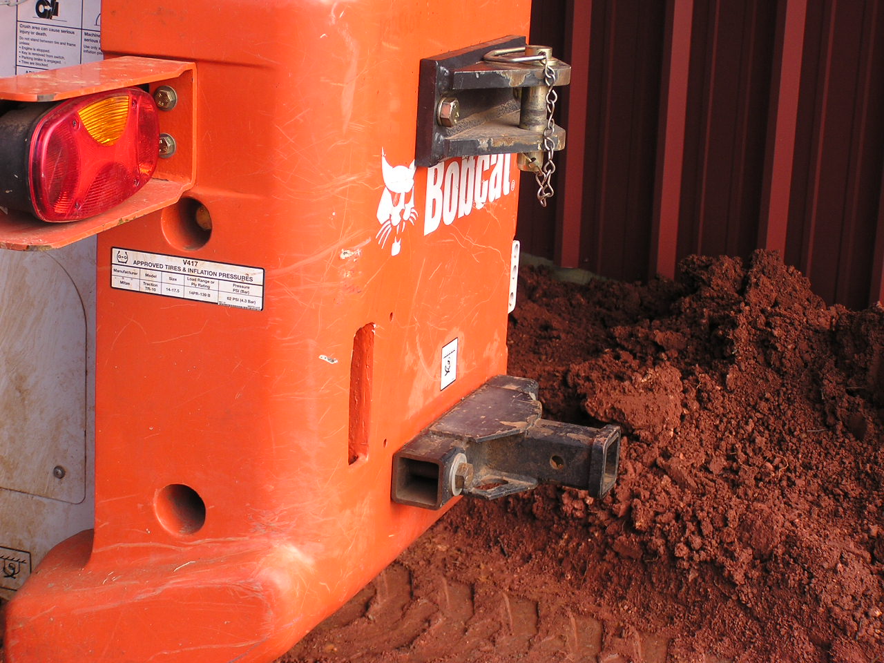

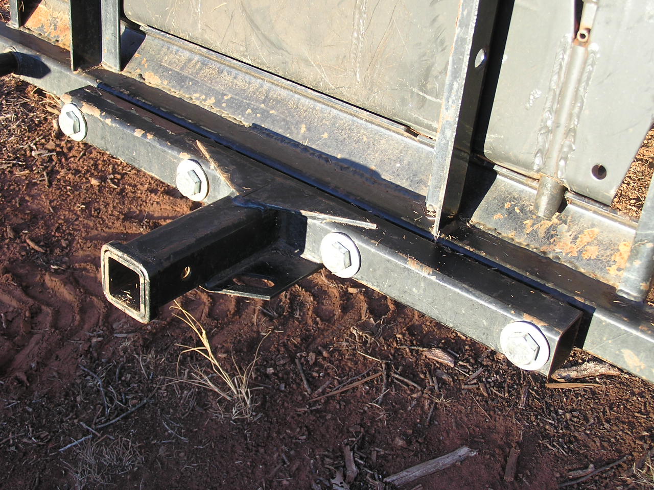

/ Front Trailer Hitch Receiver #12
Thanks xring100. I also have a receiver on the bucket too.
Wow that bucket has some Balls ;) I torched a hole through one of my forks. So i can put a ball on it or a clevis works great for lifting implements and other stuff

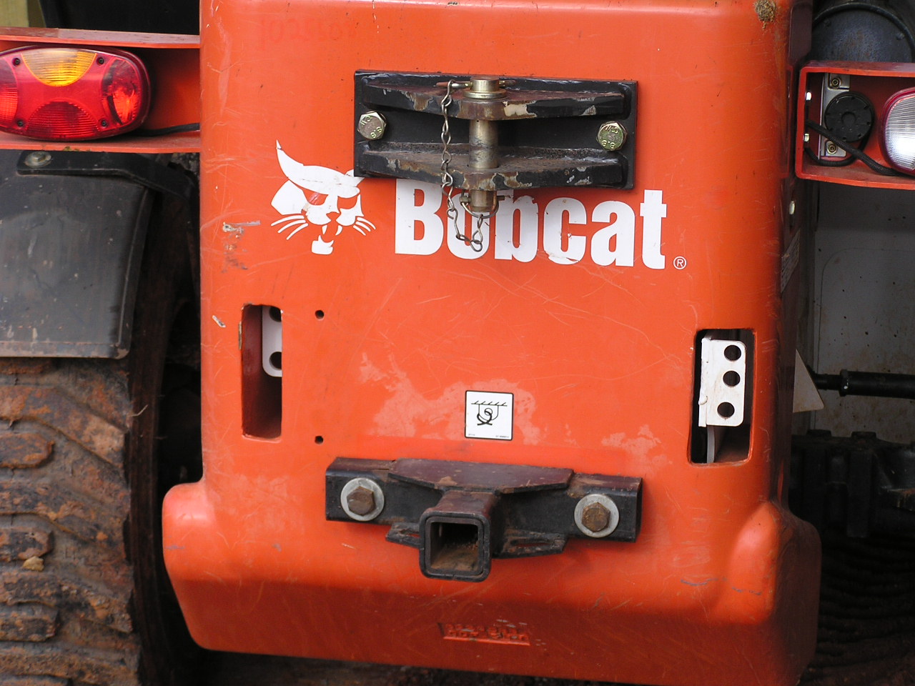

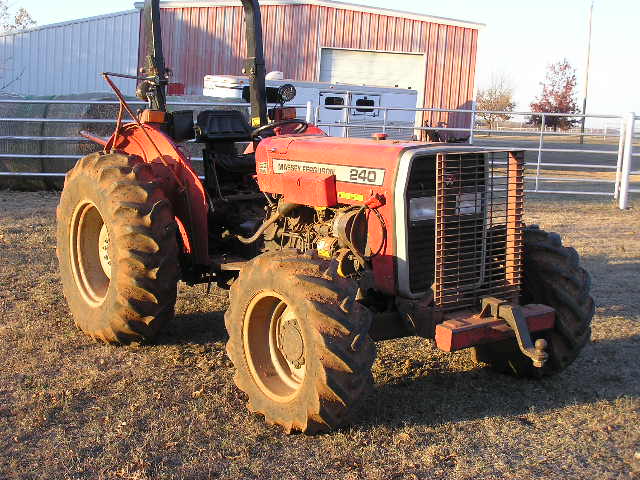

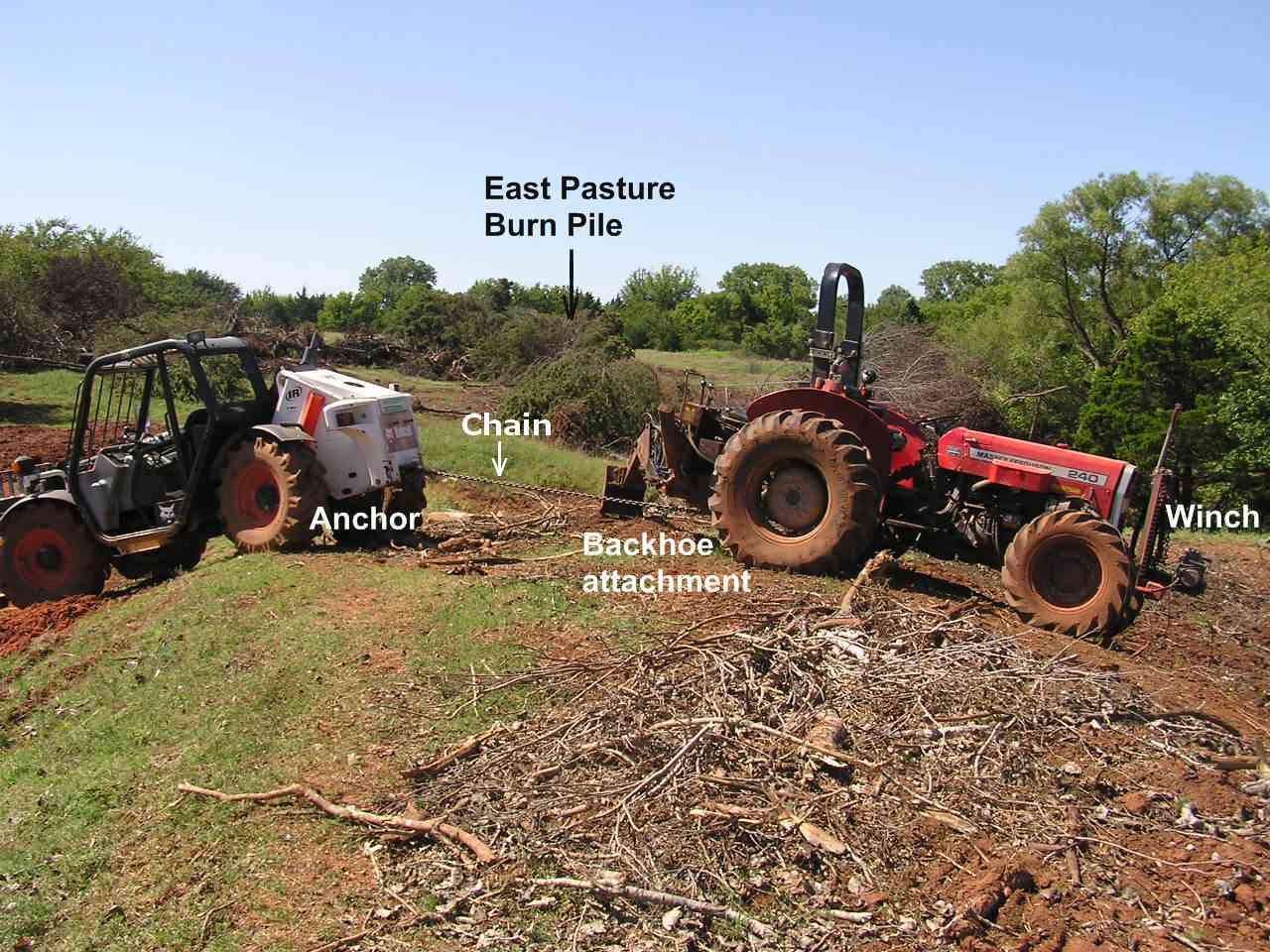

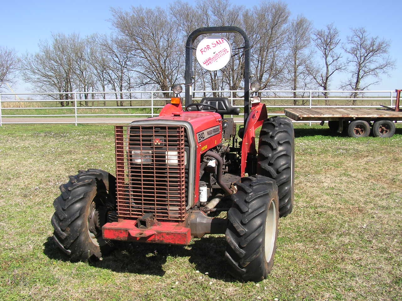

Yep, very handy. I added one to the weight that was on the MF240D when I bought it. Great for moving trailers.

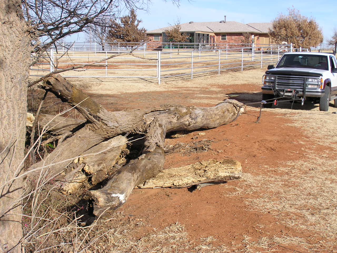

I had a Warn 8K winch on a receiver mount, for my truck.
Used it on the tractor also.
#15
I've used my Warn 9000 on my Hummer and it was quite useful. So what you've done is what I'm hoping to do Dennis. I wasn't sure if I was crazy... Thanks for the pictures. ---Ed
/ Front Trailer Hitch Receiver #16
No Ed, not a crazy idea!
This is my tractor now:
I moved the Pin hitch to the top threaded holes and put the receiver hitch on the bottom.
I can use the winch on the front or back now, but haven't needed to.
For the front I have a Speeco Ultra Fork with a receiver hitch added to move bumper pull trailers.
For gooseneck trailers, I bolt on a cut off receiver hitch.
For the horse trailer, I bolt it on the right, so I can see along the side of the trailer, while pushing it into the barn.
