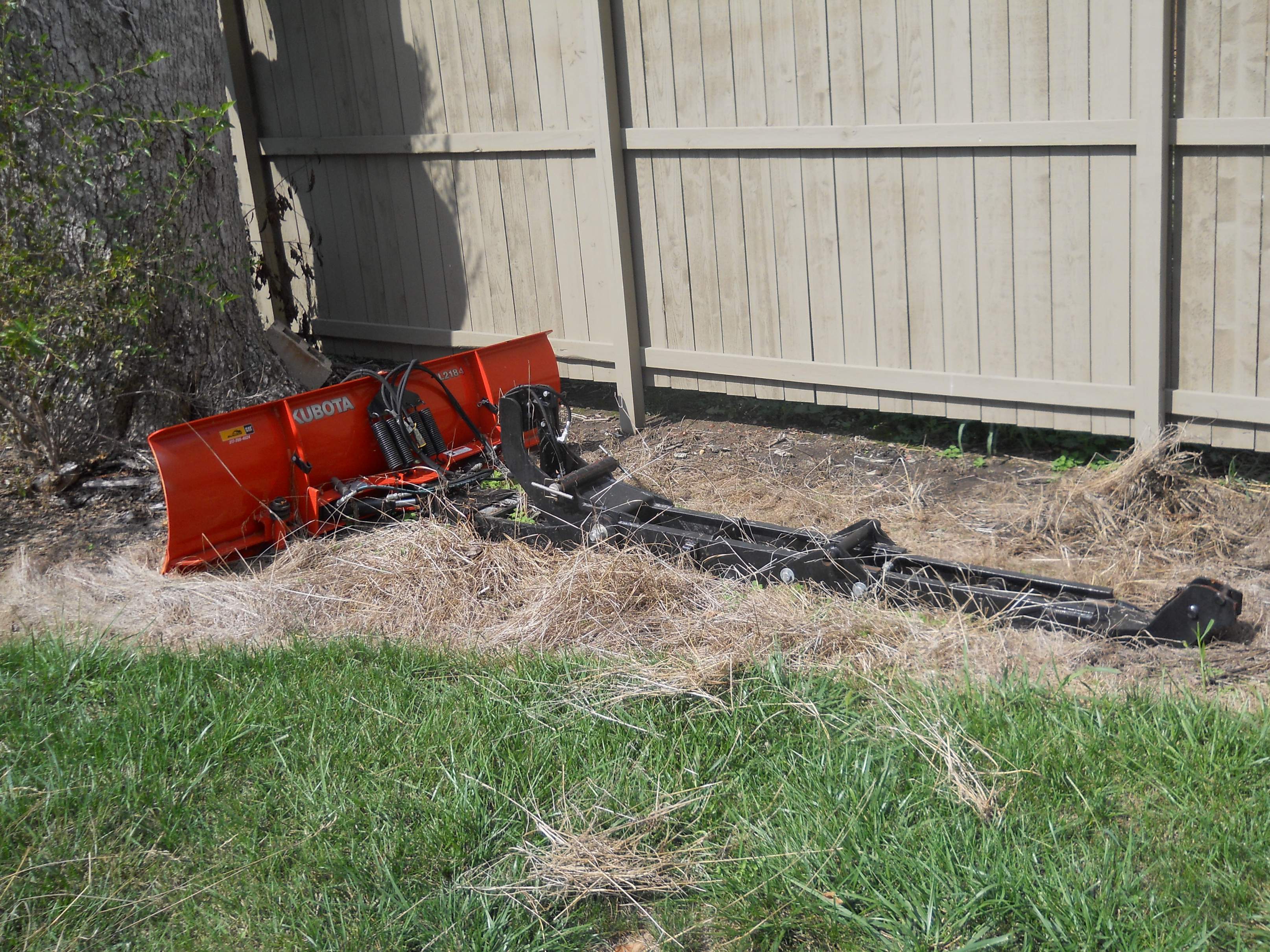

Anyone have a front snowthrower on an L3410? Kubota web page says it takes an L62HD, but it's not clear what else is required to install it. I assume it can use the loader valve, and it must require some kind of frame mount bracket. I'm wondering if it can fit on with the FEL assembly still in place. Also it's only 62" wide but the wheelbase is 66", seems odd. Any comments welcome, thanks.
/ Front Snowthrower on L3410 #2
Should need a sub-frame (quick hitch) like this. This sub-frame is required for front blade, snow blower, and broom. I cannot leave sub-frame on with FEL installed. Nose of sub-frame hits bucket. You should have same problem. Guy on here has L4240 but his clears, probably due to next size up loader. Philip.
