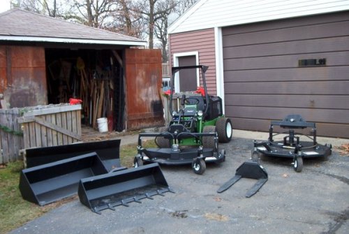

Our Power Trac machine comes standard with a proprietary quick attach system on the FEL.
ALL attachments go on the FEL and come from the factory with the female side of the QA. Takes 15 seconds to change a non-powered implement without getting out of the seat. 30 seconds for anything that requires power, because you have to hook up hoses...
