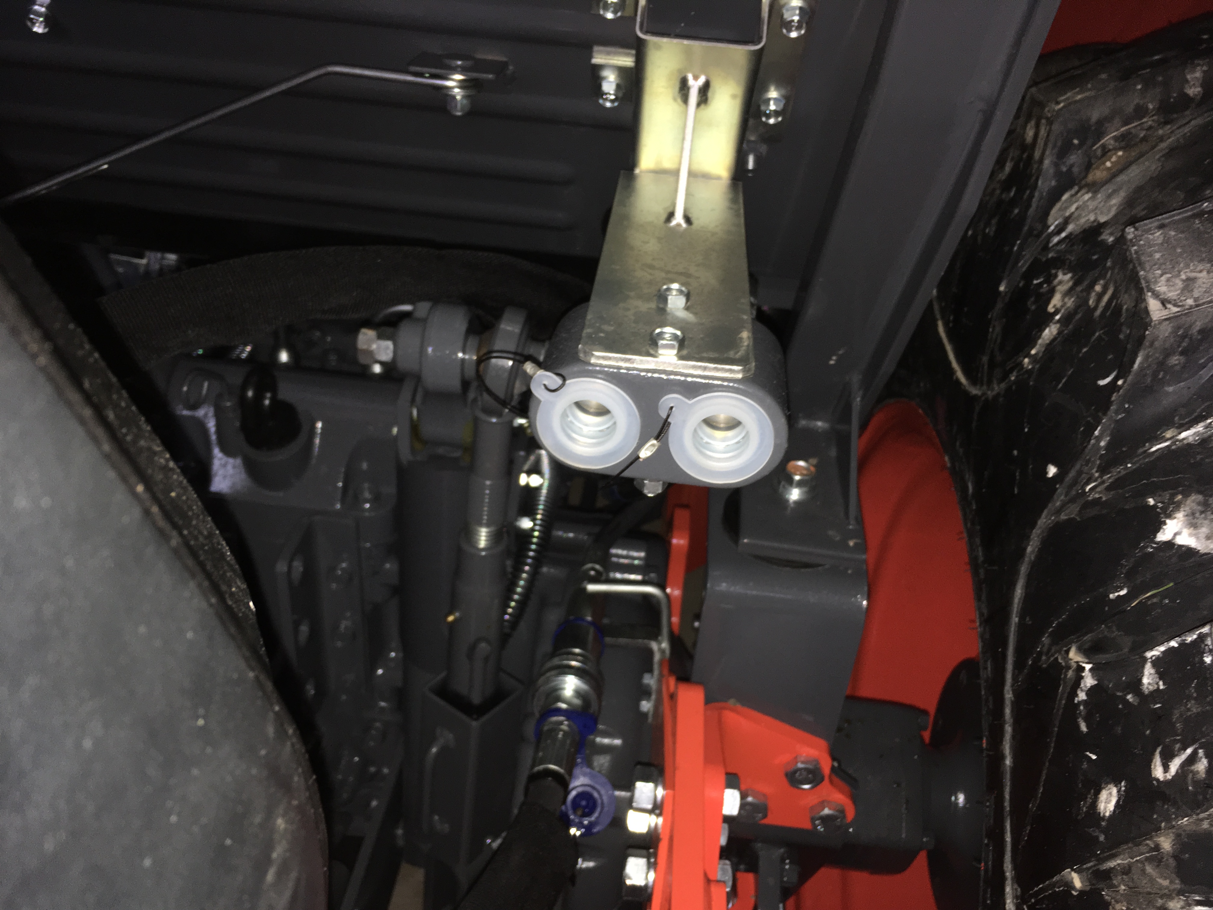

One more question, this one with pictures....
I know how to connect and disconnect the type of quick disconnect shown in this photo. You just pull/push back the knurled sleeve and the fitting pops apart.
I'm a bit confused on the ones in the following picture. I can push them together, but how do you get them back apart?
Thanks.

Yes, its perfect-I've sold several setups like that.
As to the remotes you pictured, they are called "breakaway" style, with them you just push in and then pull out quickly and sharply, the male nipple will pop right out.

If you have extra rear hydraulics, you can just run a long hose pair up front to run angle or other stuff. The OEM QD operate mostly like the standard ones, except they are mounted by the sleeve rather than the back of the fitting. Pull on the hose & the sleeve stays put & fitting moves causing the hose to pop free like moving the sleeve on standard fittings. Same for connecting. It's really nice & can be done 1 handed unlike standard fittings. Also likely to disconnect on its own properly if forgotten or an impliment falls off. I wouldn't trust it for routine use though as it might jam due to alignment issues. Always manually disconnect if possible.
