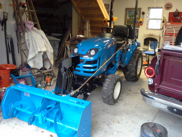

It's a 70 GMC short box step side- just finished it 6 months ago- my first attempt at restoration... earned a lot about what not to do... thanks for asking. Phil
Very cool! I'm looking for something very similar...wife wants an older, simpler run around truck. There's no shortage of projects she has for me, but that one I'd actually like :)
