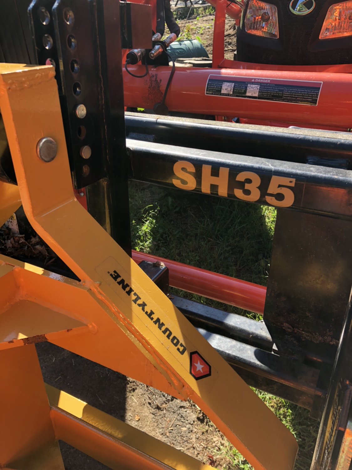

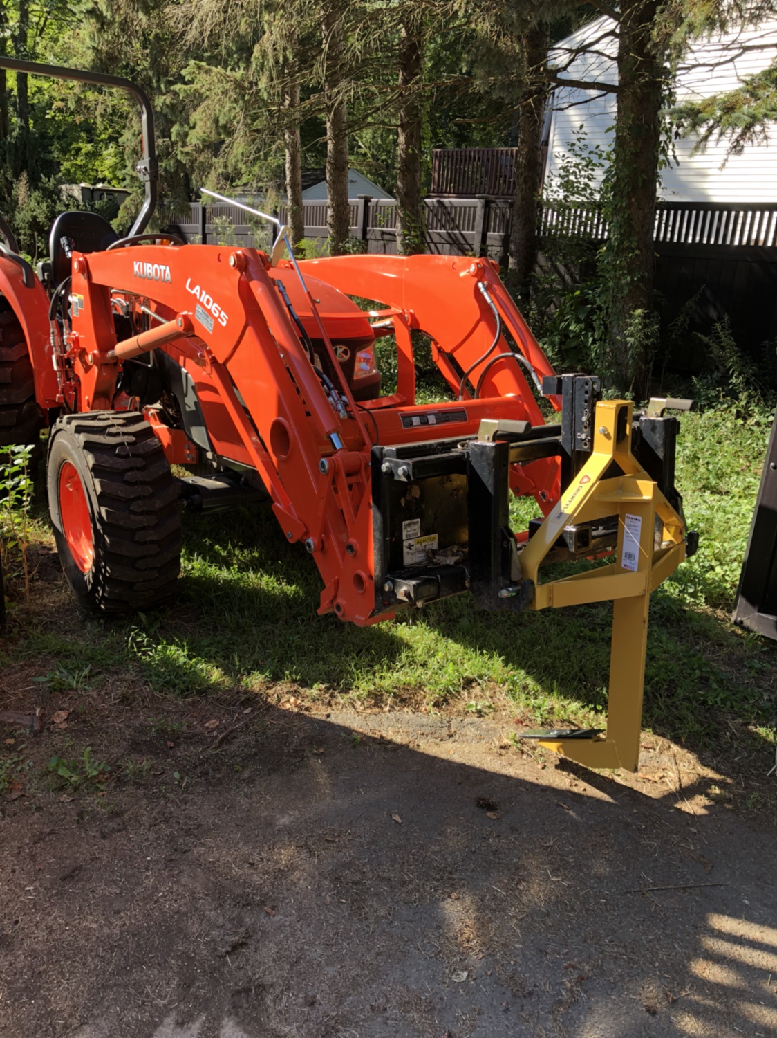

Wanted to open a few irrigation pipe trenches in a new lawn
Used a middle buster in my Landpride From Quick Attach to 3PT adapter. Worked well

You must be the Ginga Rogers of middle busters. Doing all that work going backwards.
Fred Astaire would be equally impressed.

A set of pallet forks could do the same job and be moreusefull later. You can also use them going forward.
   / Front Mounted Middle Buster
I have forks and I would not use them to dig. First they don’t dig well. Second doing so would be any easy way to damage my loader. I rarely use the front 3PT. In this case I had the rototiller on the rear and needed a quick trench. Usually I’d use a trencher or the middle buster on the rear of a smaller tractor
