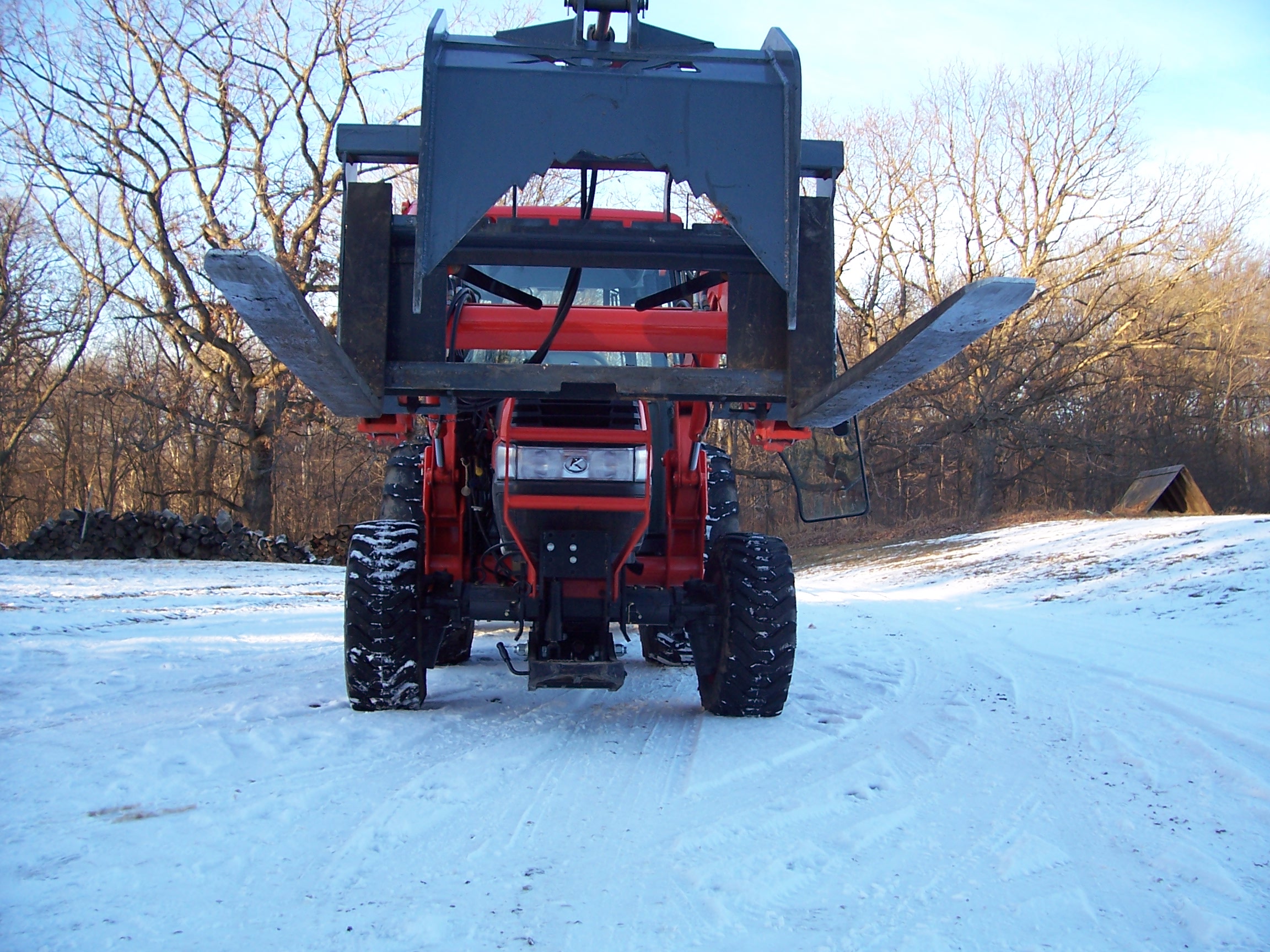

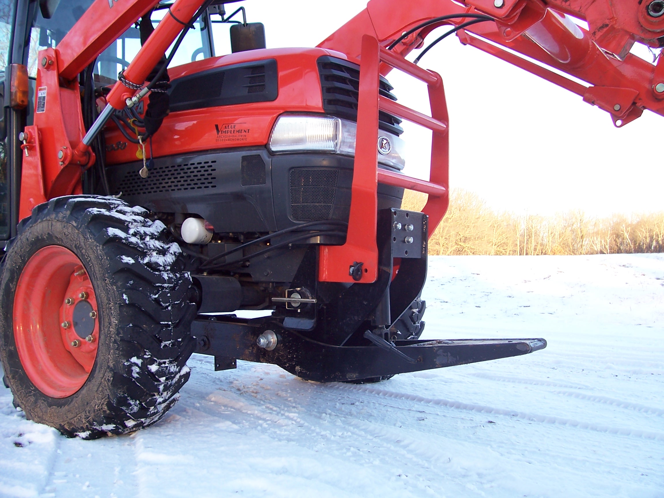

Hi Sparkle-I have a 5030HSTC with the sub frame for the blower and a blade.
It has a 5 point connect (2 pins on each side and a receiver for the front of the draw bar) and only takes a few minutes to install/remove after you have done it a few times.Haven't used the blower yet but it looks as good as the ones I have had before.Hasn't been too much of a problem with it on doing loader work but gets in the way sorting logs with the grapple.I have never beeh stuck because of it but it's an issue if you get stuck with it on.I always take it off when I'm working in the woods.Seems to be a good setup so far- the blade and the blower go on and off in minutes.I'll try to get some pictures when the rain quits.

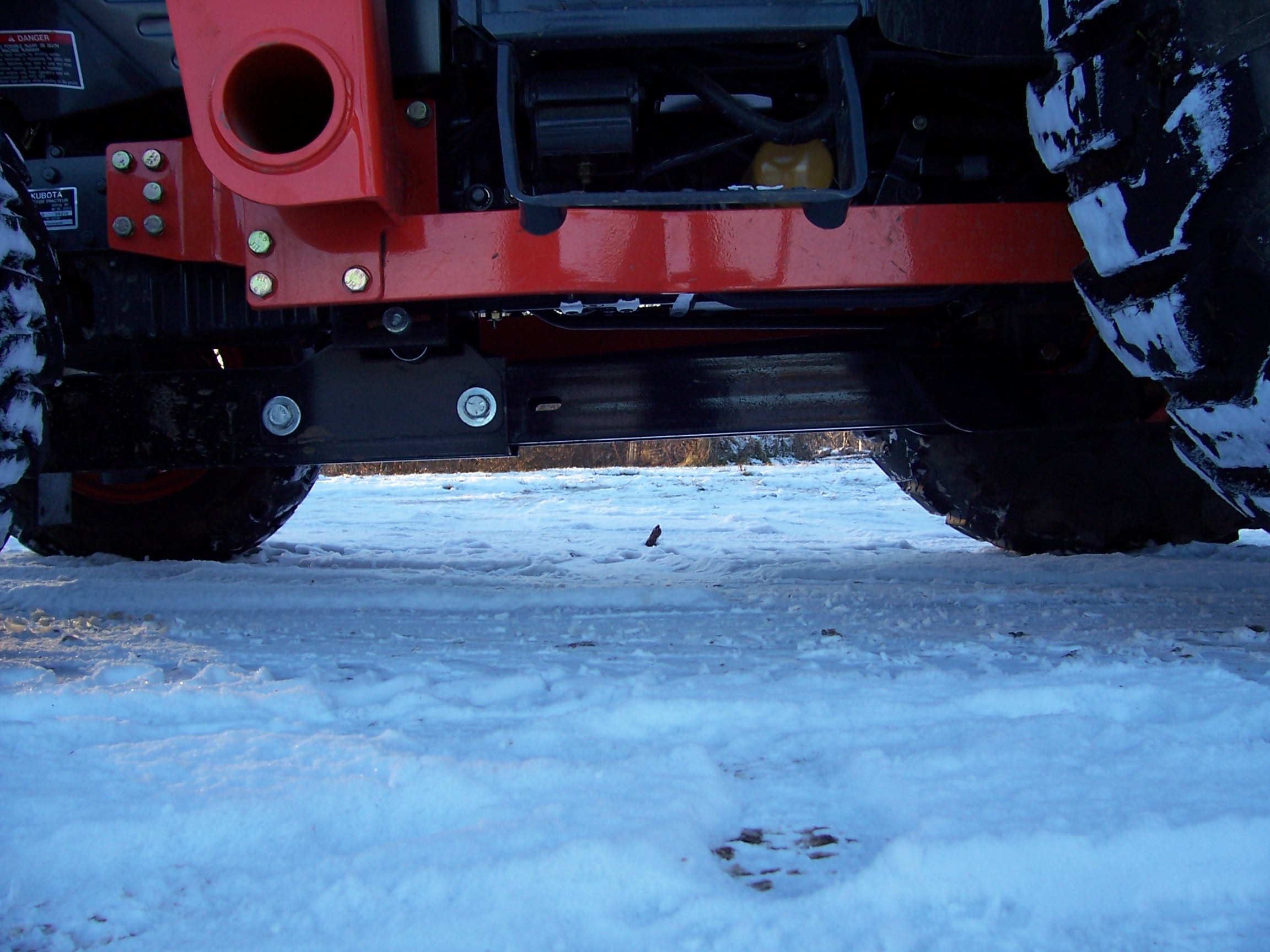

Would you also know the clearance with the sub frame on?
I alsoknow that Erskine has a simular set up. Did you look into that when you decided? If so why did yoy prefer the Kubota?
Thanks a lot again!
/ Front mount snowblower questions #6

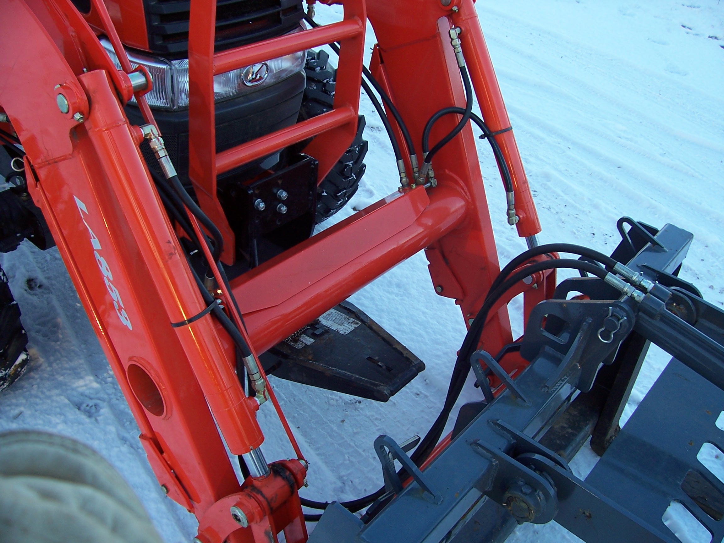

The sub frame is heavy but you use the cylinder on it to lift or lower when you take it off or on.I take mine off a lot and only takes about 5 minutes.
It gives you about 7" clearance when on.I didn't look at any other options when I bought it because we have a good dealer and I got a good price on the whole package.I will attempt to attach some pictures with this post......

Thanks Bill, the pictures are very helpfull! Could you also confirm that there is full freedom of movement with the bucket on? Then it looks in my case I can leave the subframe on all winter long.
Also I have a double valve for the loader, is there a third one required, (angle of the chute) or can that be done manually?
/ Front mount snowblower questions #9
Hey Sparkle-I think the last picture shows the clearance with the loader all the way down.The sub frame never gets in the way with the bucket on.The loader has to come off when using the blower or blade.The hydraulics for the front mount epuipment plug into the loader spools.Then you use the joy stick for up/down and left/right for the blade and the blower is up/down and chute swing l/r.I use a linear actuator for the deflector.I am installing a third function valve for the grapple (instead of one of the remotes) and I will wire the blower actuator to the switch on the new joy stick.The Kubota blowers come with a manual defector and their electric version is over 500$.Hope all this helps.
