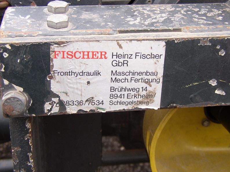

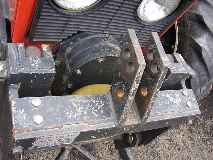

When you use rear attachment, PTO have to turn clockwise (right). If you will use belt and pulleys with shaft under tractor belly, front PTO will turn counter clockwise, looking from front side (left). This is normal turn direction for front mounted attachments and 1000 rpm PTO, BUT YOU NEED OPPOSITE (clockwise - right) DIRECTION FOR USE rear mouted attachments on front side. This means that you will need, anyway, one set of gears on one side to change PTO turn direction.
Some front PTO manufacturers offer double shaft drive: 1000 rpm counter clockwise, and 540 clockwise. Look here
BTW, on picture of front PTO attached is aftermarket setup of CCW 1000 rpm. Zetor's original front PTO is clockwise - nonstandard.

Do you have any info on who manufactures that after market set up shown on the Zetor??
Thanks
Bob
   / Front Mount Snowblower decision (I hope) #14
Hello Bob,
I don't know lot American or Canadian manufacturers. Only this one. Here in Europe we have several. I sent you link for HYDRAC Austria. This one on Zetor picture is from Germany.
