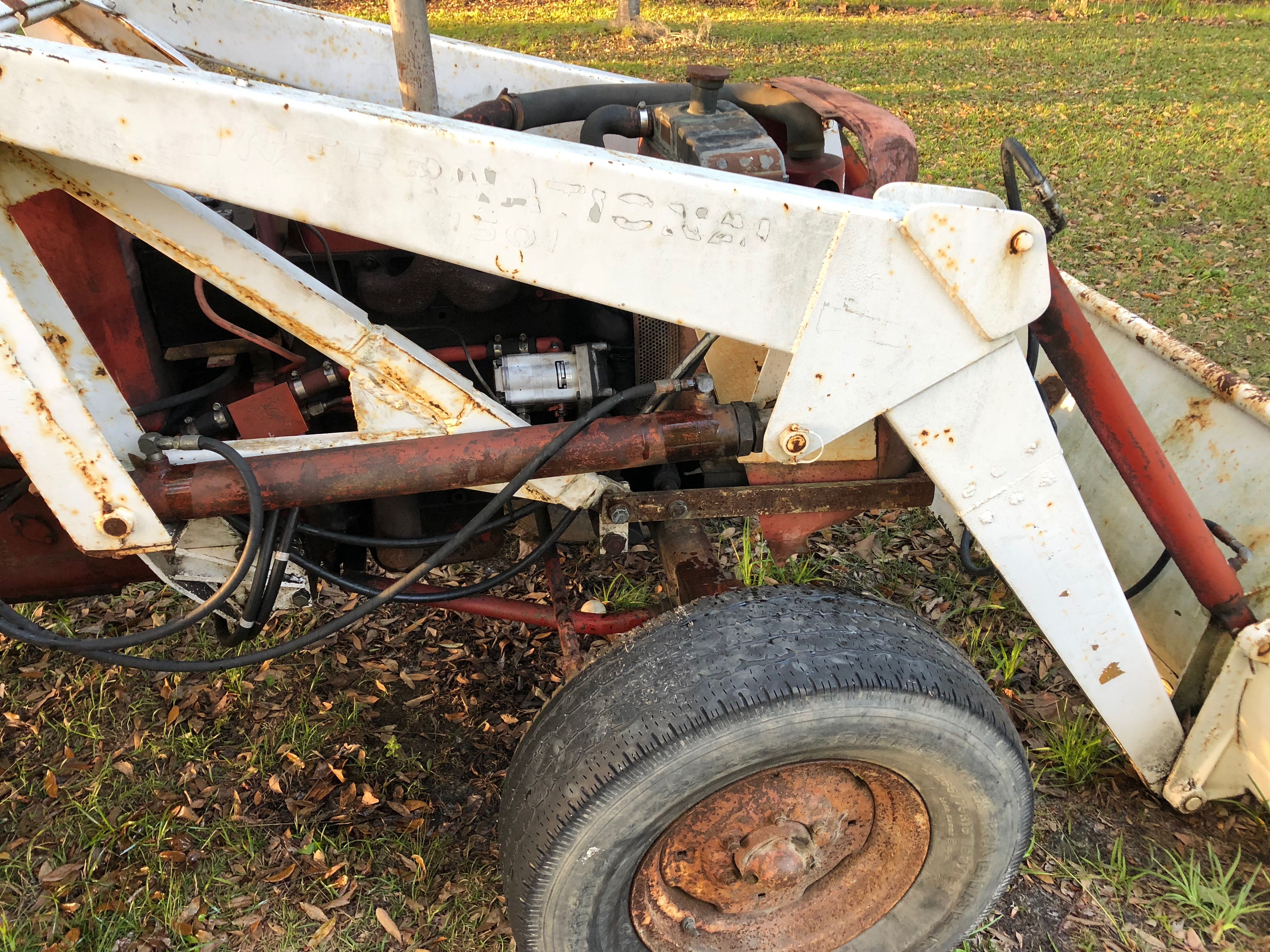

Hey Everyone, new member here, I need some help with one of my tractors so I figured I'd give it a shot here.
I just picked up an older IH 444 (Europe version, maybe 1970ish) with a IH 1501 loader on it from one of my family members. The loader wasn't working and since I don't have too much experience with hydraulics I decided to remove the pump and bring it to a place to inspect it and they told me it was bad. This tractor does not have the front mounted pump, it has a dual pump that runs the rear hydraulics and the power steering and tee's off the rear supply line to feed the control valve for the loader. I ordered an aftermarket one from Ebay (Dynamatic Limited UK C11.4/8.2L05699) and installed it on the tractor. The power steering works and the rear lift arms work but the loader still didn't work......
Since I drained the fluid while replacing the pump I put some fresh fluid in the hydraulic reservoir and the transmission, I used that Traveller premium fluid that meet the IHB6 and new MS-1209 spec. I removed the line connected to the control valve (Zexel 37213) that's teed off the rear supply line and the hydraulic fluid was coming out with some pressure. It appeared whiter/foamy and thicker than the typical hydraulic fluid, not sure if it was the air that was making it whiter/foamy....So I assume this means the control valve is getting fluid from the pump? I loosened a few fittings on the cylinders and used the control valve and the fluid would come out the fittings, not really spray out just drain out. I read on this forum about removing the rear caps on the control valve so I did that and everything looked clean and normal. I'm pretty sure the control has a float option if that makes any difference. I even tapped the control valve a few times with a hammer to see if maybe something was stuck in there but the FEL does not move at all
So I'm at a loss as to what to look at next. If you have any suggestions at all I'd love to hear them.

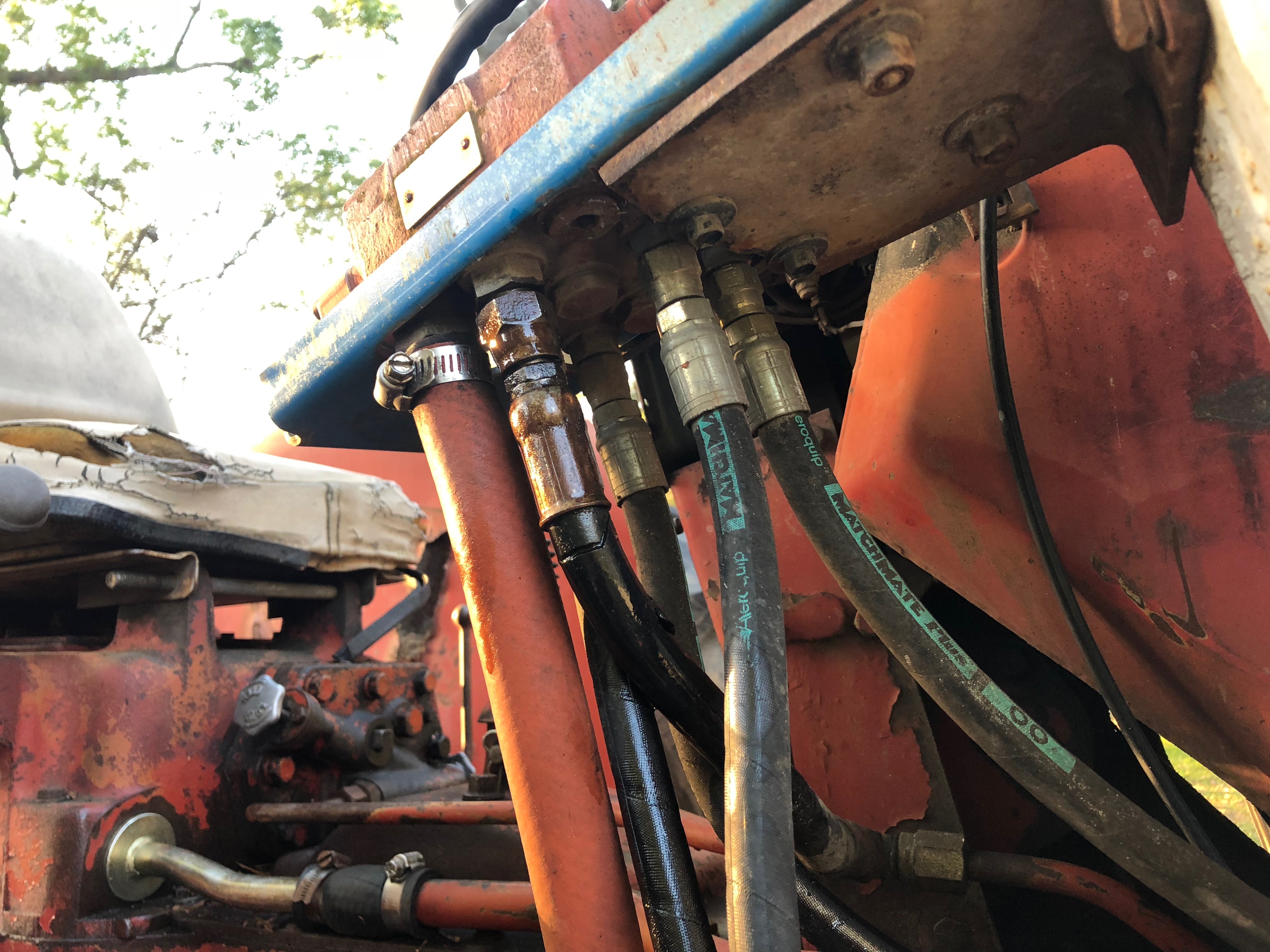

What helps people who are trying to help you are pictures of all your connections.

The existing valve has 6 lines connected to it. 4 that go to the cylinders, 1 that's from the Teed line, and the thick orange one that comes from the tanks. The pump is rated about 9 gpm.
Regarding your comment about you cannot just TEE off a supply line, this may be absolutely correct but since this was a family members for years I've been around it a handful of times and have seen the loader work as is.

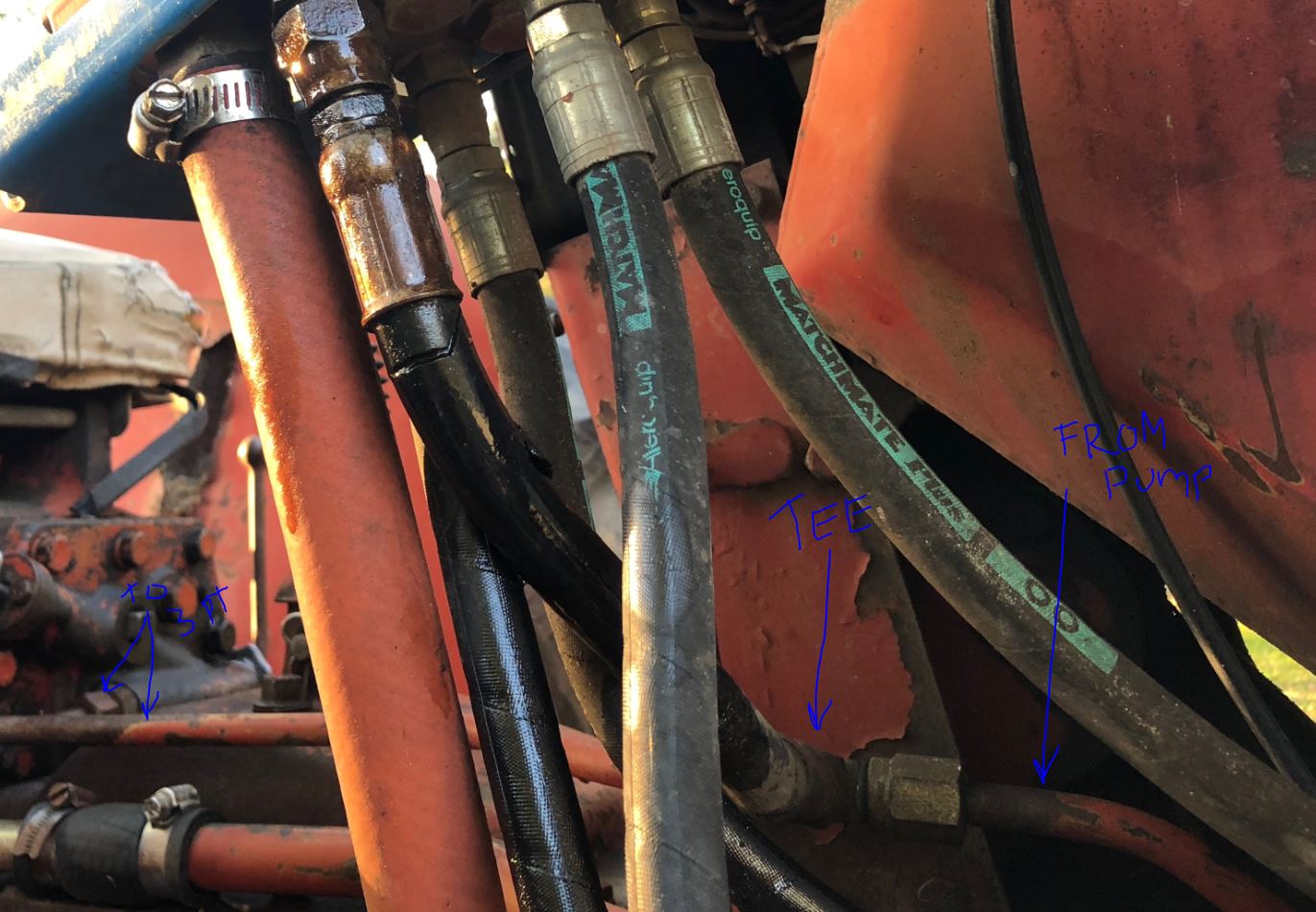

The red line is a low pressure return to the tank from the FEL valve.
Step 1 is to go to the Tee and remove the 3 pt from it and either connect the two remaining hoses together or plug the 3 pt outlet on the Tee which will send all pressure to the FEL
If the FEL now works we are on the way to a solution.

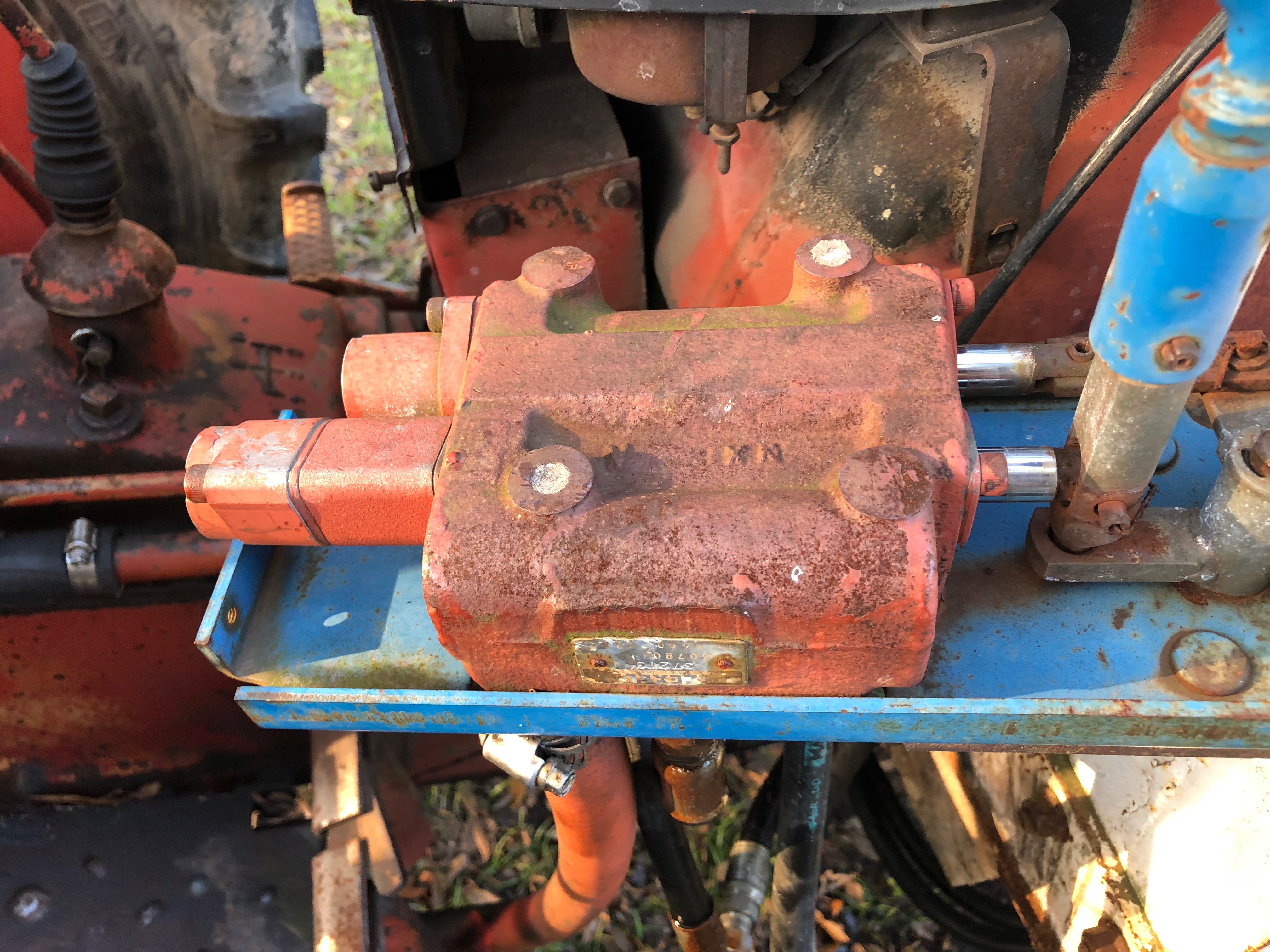

See if there is a lever on the left side by the seat, if so move it. That might make the loader work but not the 3pt.
/ Front Loader Not Moving at All. #9
Leejohn's comment made me take a closer look at the owner's photos.
Does this valve change anything such as make the loader work when turned the opposite way and what does the lettering say.
Is this the TEE?
/ Front Loader Not Moving at All. #12
That what I use. Remember they dont make anything , they just have reputable manufacturers brand stuff. Only reason I mentioned it was the age of the tractor. Alot of old stuff and heavy equipment use 303 fluid. If you notice they put it on sale all the time.
/ Front Loader Not Moving at All. #13
I can't see how that can work the way it is plumbed. Putting a tee in the pressure line of an open center system will only operate the function that requires the least pressure to operate, in other words the flow goes the path of least resistance. If you put a load on the 3-point, will the loader work? The way this is plumbed, I can't see how the 3-point can lift a load either, but if you can make the 3-point load greater than the loader, then the loader should work. The proper way to plumb that would be with a power beyond loader valve. Also, there appears to be no pressure relief valve on that loader valve.
/ Front Loader Not Moving at All. #14
The ones with the hose clamps are probably just the low pressure return lines. I don't see how you can T a pressure line to run two items because when not in use those items are just dumping the fluid to the return so no pressure.
