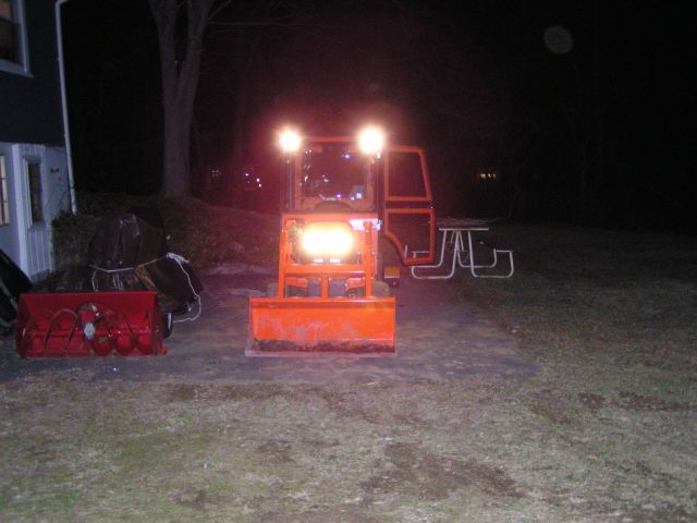

As I'm sure you all know, the headlights on the BX are useless with a fel. /forums/images/graemlins/frown.gif I'm not sure what they were thinking when they designed the headlights on this tractor /forums/images/graemlins/crazy.gif but I saw an opportunity to address the problem and I must say it works excellent.
The Curtis cab made this real easy since it has holes already drilled for mounting top lights but I didn't want to pay their prices so I went to good ole Walmart and for $20 I got a set of rectangular driving lights (55 watt halogen). The lights mounted perfectly through the pre-drilled holes and tucked underneath the lip of the cab top so they are not exposed to tree branches etc. The lights aimed perfectly at about 25' in front of the tractor and you can't even tell the factory headlights are on with the top lights going. The only time the bucket blocks these lights at all is when it's way up and you usually won't be moving much when that is the case. Here's a picture of it all light up.

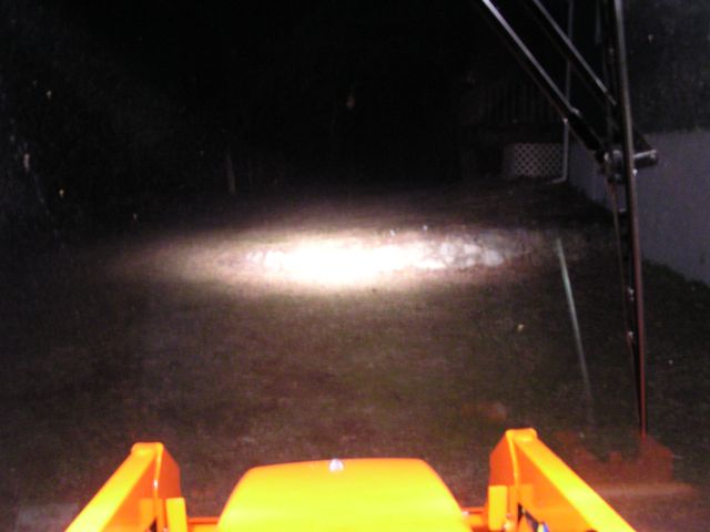

And here's a picture of what you can see from inside the cab with the lights on.
I'll post more pictures of the set up including some close-ups tomorrow when it's light out again.

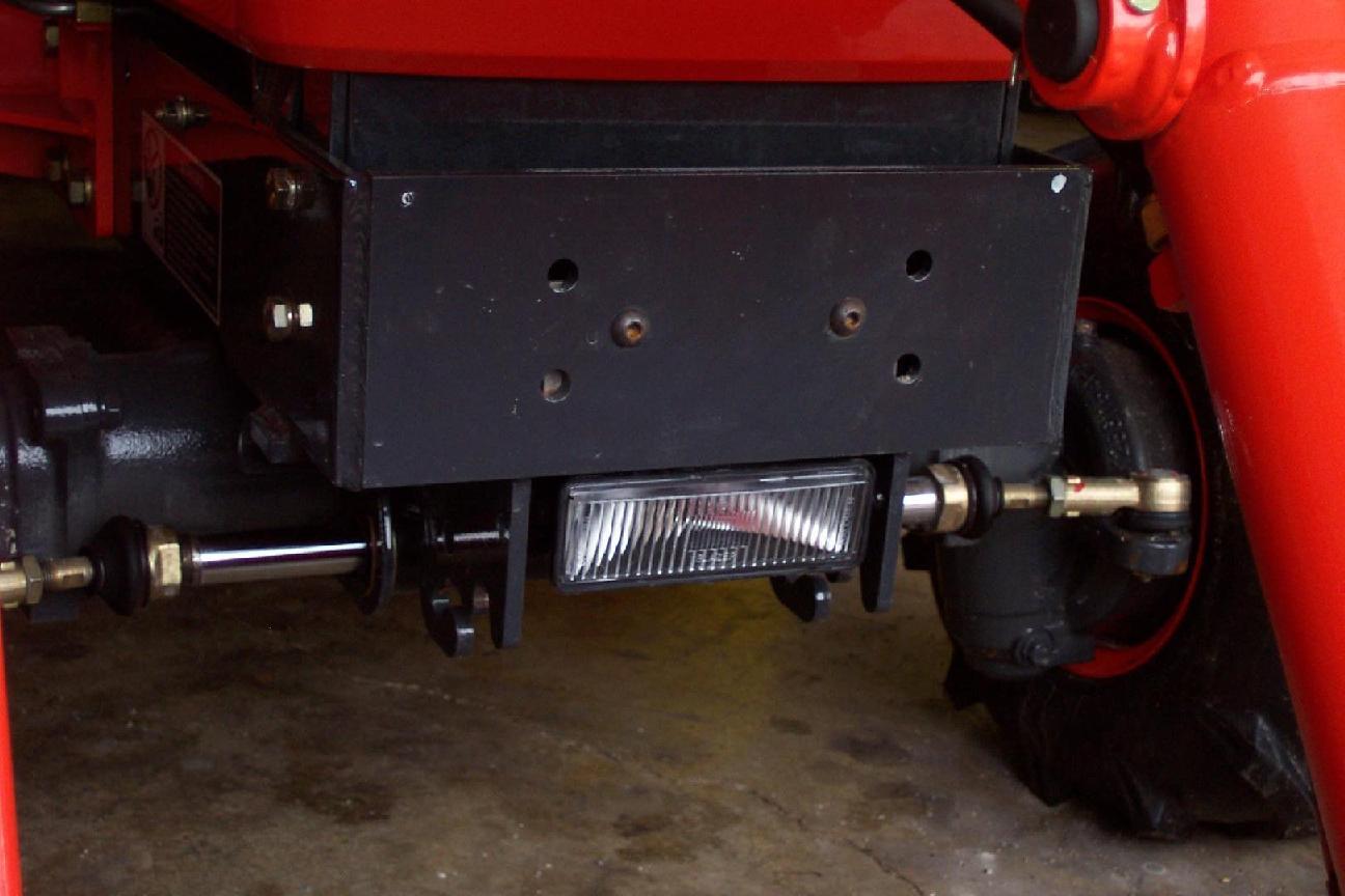

I thought the same way about the factory lights and added one in this manner.

That's a pretty fair alternative for someone who doesn't have a cab.

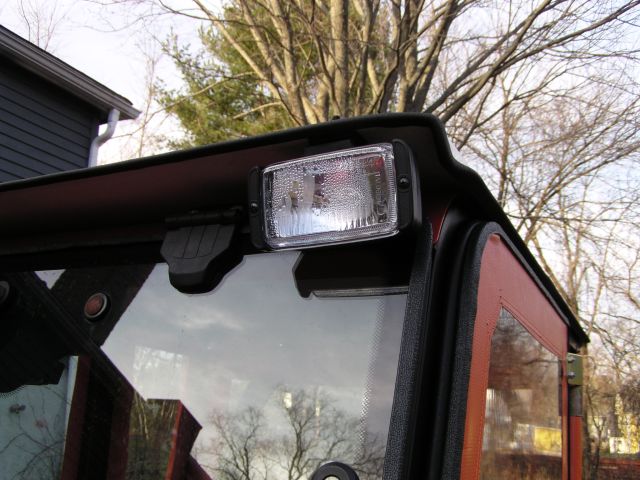

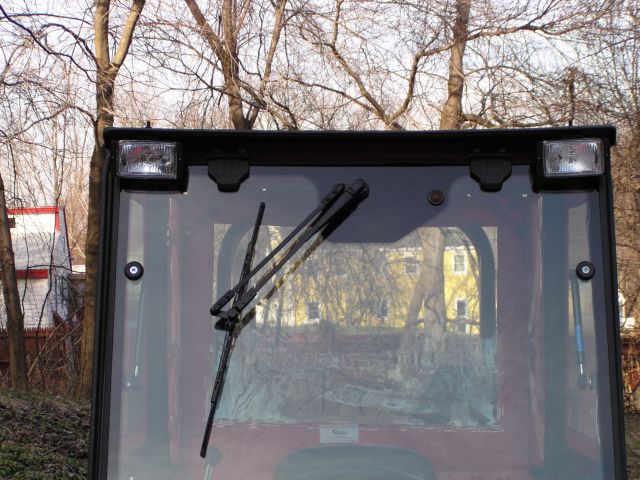

Here's a close up of my cab mounted lights.

And closer...

And one more showing the pull switch installation.

   / Front lights for BX2200
#12
Having this light down low enables me to see not only in front of the bucket with it raised more than 6 inches, but also right behind the bucket if I am using to scoop and I can see if I get too deep and getting into the turf. For power I just piggy backed off of the input side of the switch for the front lights. Then cut a hole next to the switch for the turn signals and placed a rocker switch there.
