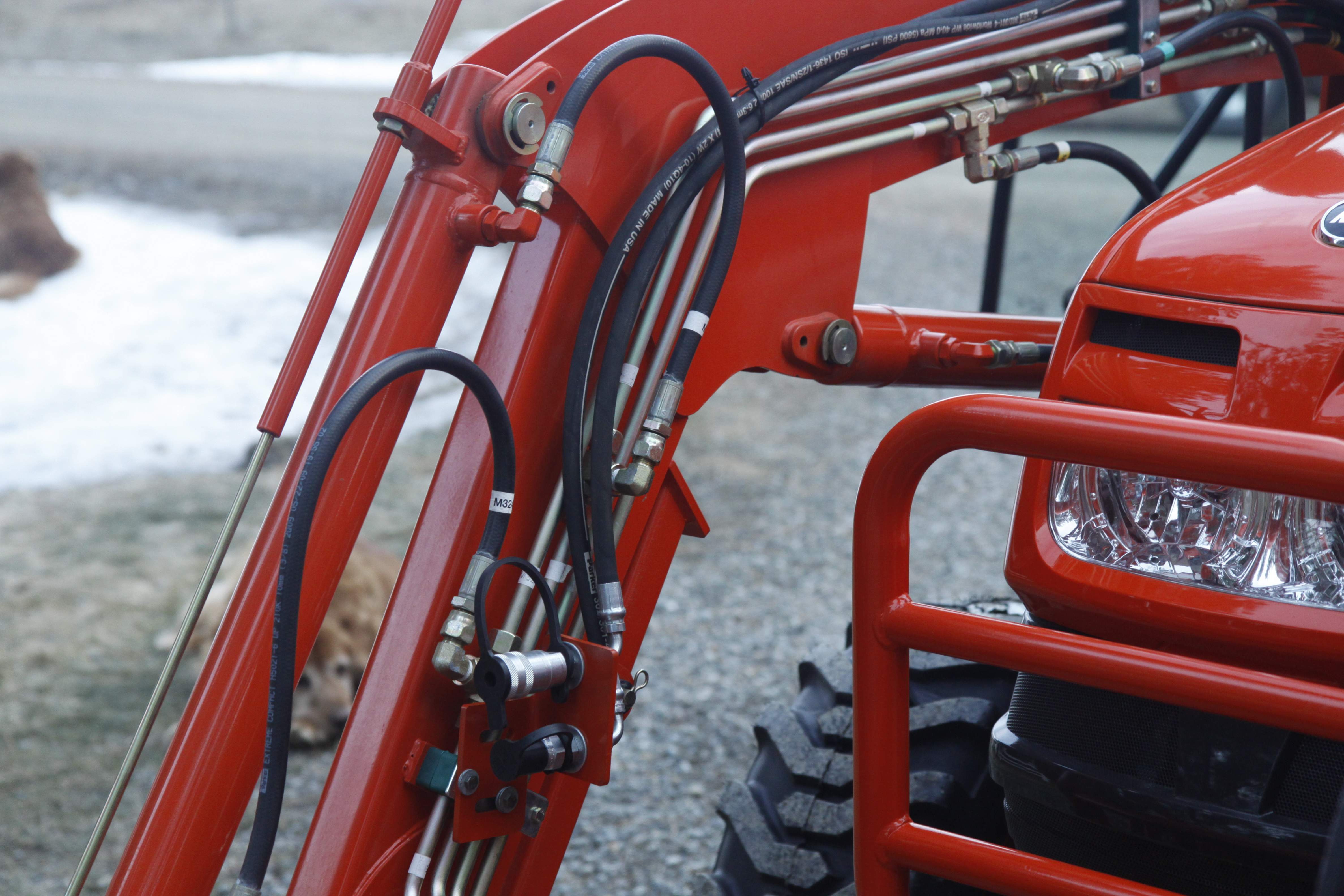

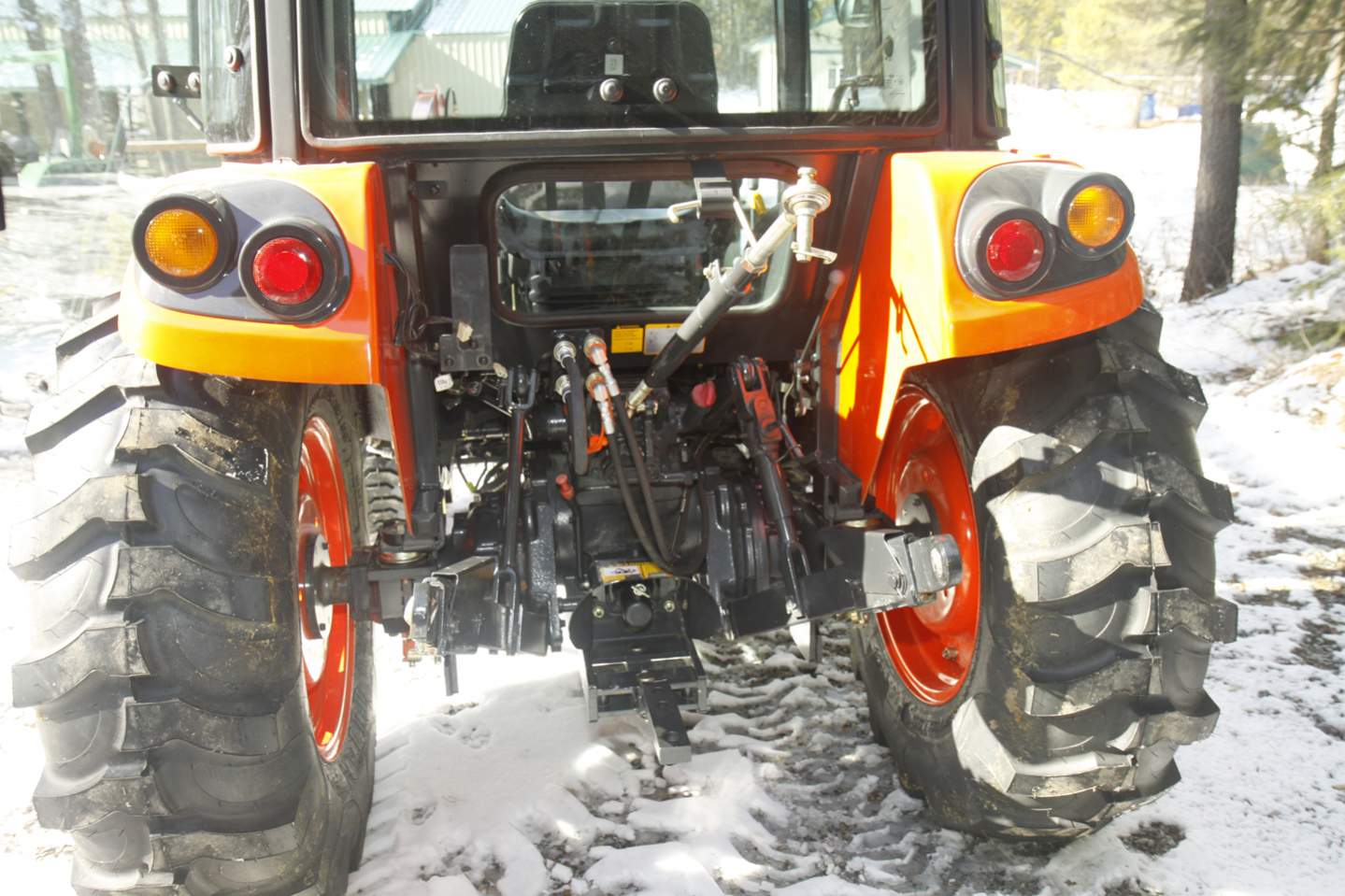

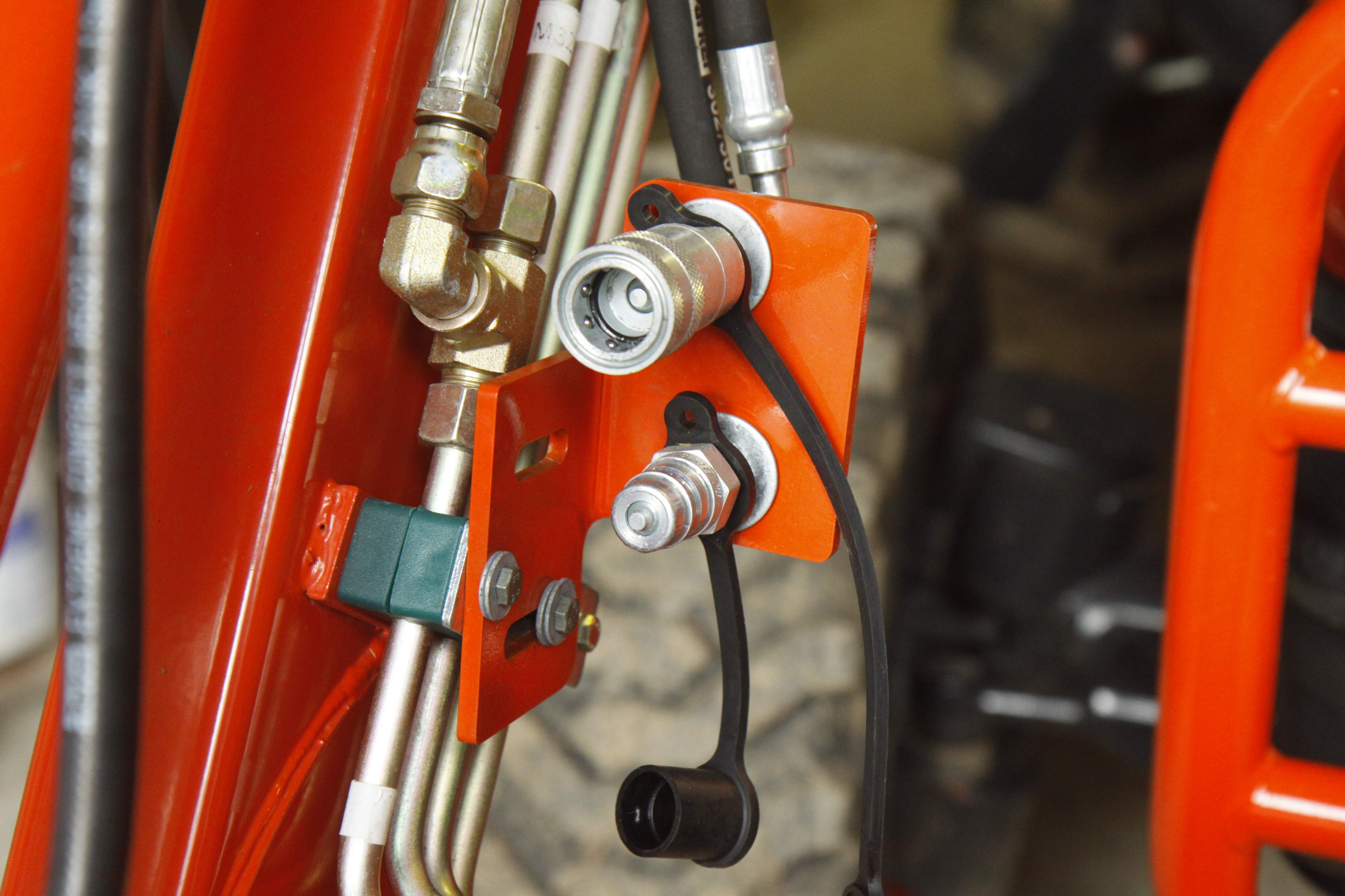

i had it done to my Kioti. They ran lines under the tractor from the rear remotes and terminated it at a set of pioneer couplers up front. Its not an LS, but here are some pics. I have to cut 3 sets of zip ties to remove the loader, but since ill hardly ever need to remove it, who cares. I was thinking about having a mid set of couplers added so i wouldnt have to remove the entire thing....maybe this summer. Well see. He charges me 350-400 (cant really remember exactly) for parts and labor. A real 3rd valve was nearly a grand.
I may have to modify mine to be like yours with a male and a female coupler at the bulkhead instead of the 2 females. Nice: no possibility of getting the lines crossed that way.
/ Front Hydraulic lines #9
this is the first time ive seen this done, and im wondering....why doesnt everyone do it that way. better than color coordinated covers.
/ Front Hydraulic lines #10
About the only disadvantage I can see is the female ends are generally about twice as expensive, so having male ends on all you implements would be a little cheaper. But the convenience should outweigh the price difference.
