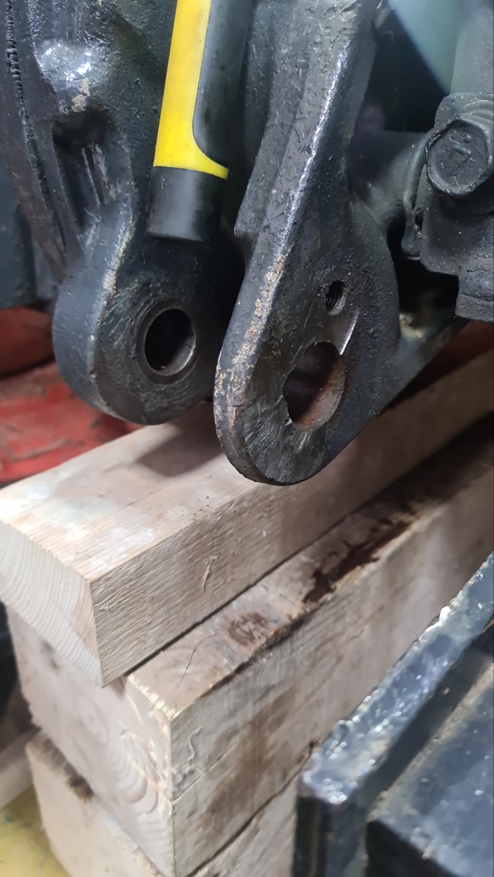

That backhoe, without a subframe, could break your L3200 tractor... crack the rear housing or crack it at the bell housing. I gave away my Long 1199 backhoe because it was way more powerful than what my tractor could handle. My hoe on a 6,000 pound bulldozer; stripped out all six top-link bolts.
My guess, is that your tractor will be dragged around pretty easily. I did not see any out riggers on the backhoe either, outrigger are used to stabilize the tractor. Are you thinking of building some?
Also are you planning to build a subframe for the backhoe? It could be done to help protect the tractor. The subframe would be what the backhoe mounts to, to protect the lower 3 point arms from breaking off (weak points). I assume you have a Front End Loader on the L3200? The subframe ties FEL and the rear of the tractor together to give more support.
I did mount a heavy duty top plate to protect my top link when I was looking to mount my backhoe... I'll post photo of it (if I can find it) but basically it's a metal plate that was bent over the top cover of the transmission case, so not only do you have the back of the case bolted, the top is also giving support...

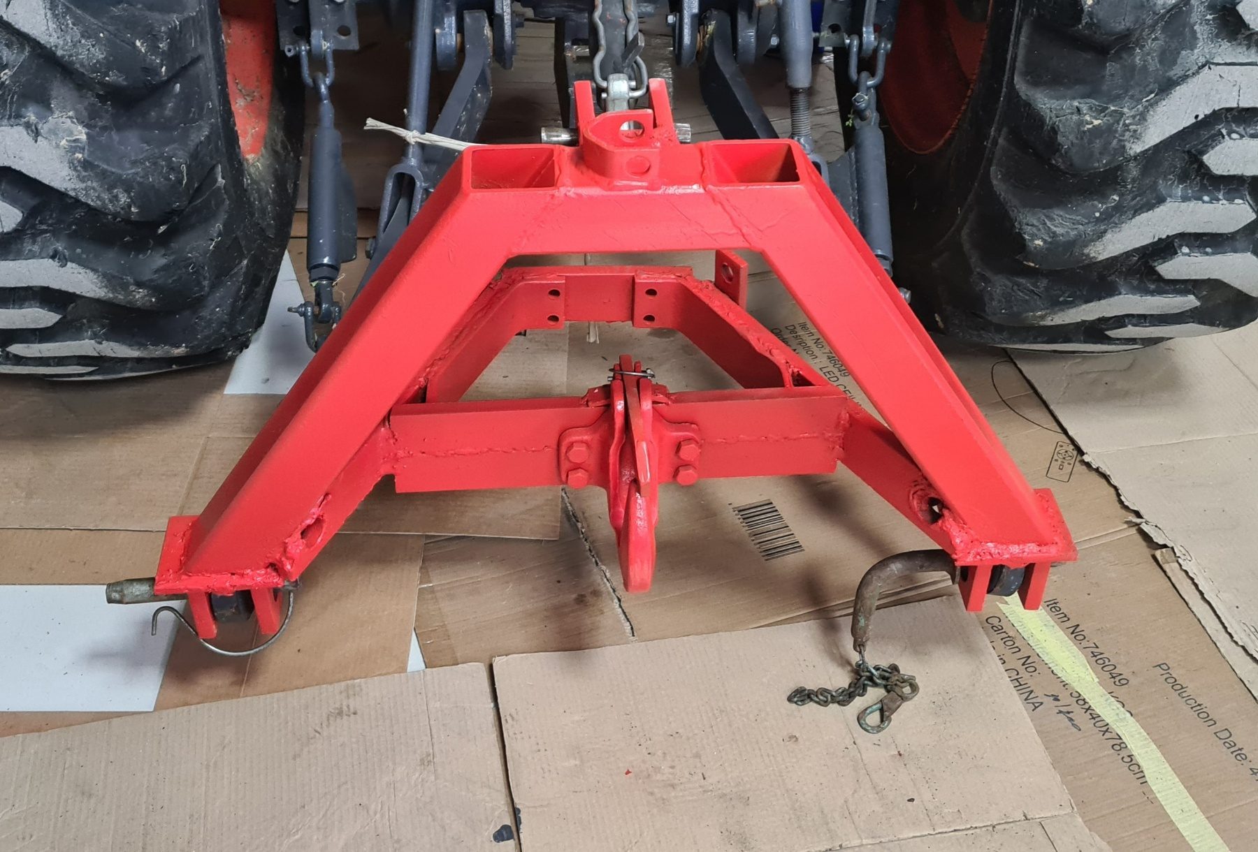

No problem, what I don't know is how to set up your dump trailer since they (normally) use a single action cylinder (vs. everything that uses Double Action cylinder). Which, single action is power up and gravity pushes it down.
I don't know if you need a special valve body or if the one you have would work fine for that??? Does anyone know? I guess you could use a double acting (power moves in both directions) for your dump trailer....
My old flare box wagon with a dump cylinder is single action. To lower I detent the valve into float.

MDAIII Avdo and Hamza; do you know what this means? Some valves, not all, have another position for detent. Normally, you push the valve handle forward, it extends the rod cylinder but if you push the valve handle more forward (sometimes beyond a ball lock) the valve goes into what's call Detent. It quickly allows the pressurize oil to return to the tank. Sometimes, this is also called fast dump or quick dump. See if your valve has this feature, it's nice to have.
Also, yet another warning... if you are pulling the dump trailer with the tractor, there is not any down pressure on the 3 point hitch (if you attach the trailer to the 3 point arms via a draw bar). If you load the rear of the trailer first, the front of the trailer could pop up. Likewise, when you dump all that weight will pop up the front of the trailer. Just chain the 3 point arms down to the draw bar.

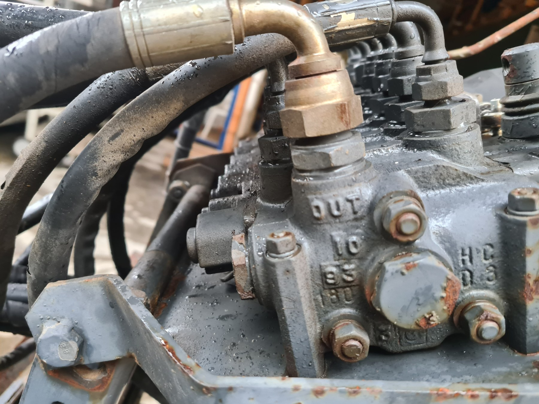

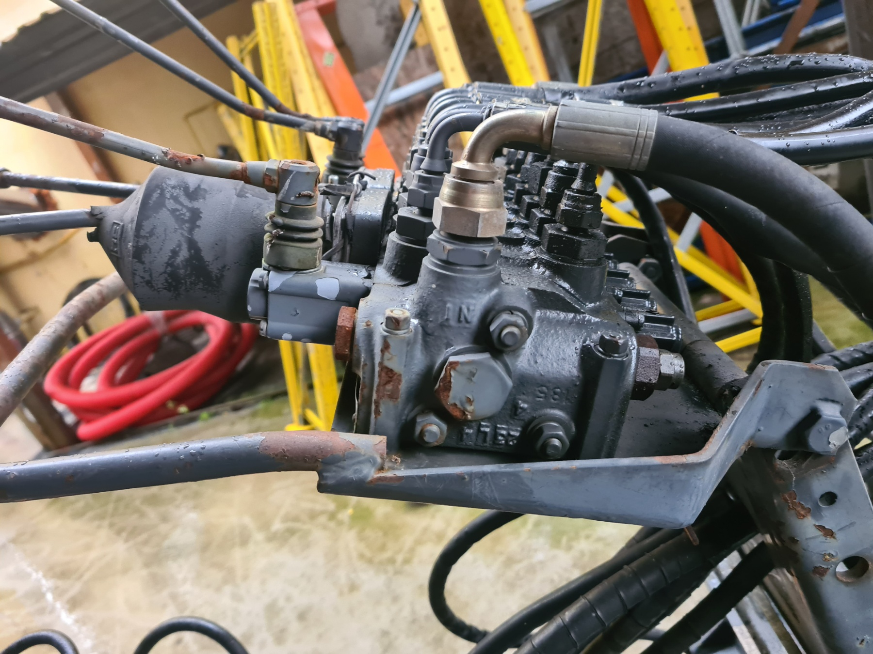

I have a backhoe there is a two pipe lines on it one gets the hydraulic to it and second gets the fluid back to tractor ?
Im woried about second line that geting back fluid where do i connect it on high pressure return or on the low presure return ?
When everything is working properly think of your cylinder as a syringe with a seal keeping the chambers on either side apart. The non pressurized fluid end has to be open or you will be creating vacuum/pressure with it as hydraulics move the piston and it will not work properly. Like moving a syringe back and forth, then plug the end with your finger and it moves a little before beginning to resist.
You can leave the end in open air but from the above, it’s obviously drawing in air, dirt, grit into the cylinder and that’s not good for seals and when they don’t do their job and the cylinder starts leaking fluid past the piston, it’s going to squirt out the open end of the cylinder. A line, even a small plastic one on the “dead” end of the cylinder back to the reservoir but above any hydraulic fluid, will not only keep the air drawn into the “dead” end clean but when the cylinder piston seal fails some day, the fluid will just cycle through it vs make a mess.

But another problem we connected it today and it dont work... we were traying on lower RPM there are litle bit of movment on opening and closing bucket but nothing...
Did i miss something ??
Is it possible that there is no enough pressure? Oil? Oil flow ?
I dont know we will try tomorow again until we make it 😁

The gear / manual transmission has a flow rate of 7.4 gallon per minute (HST is 6.2 GPM) which is slow but should have moved it. Looking at the video, when the backhoe valves are moved, tractor sounded like it was going into bypass mode...

Are they using a Closed System??? Like John Deere...
I looked here: Tractors antonio carraro
But no mention if it's open center or closed center... You could swap out the controls to match your tractor.

I honestly don't know... and with that carraro, the valves and exits were also made later, and we didn't ask because here (Bosnia), whoever we asked, mostly no one needs an external valve like a backhoe, and if it does have one, it's factory-made or it has already been imported from the EU like that. What bothers me now is that maybe we should have clicked on the return of high pressure because here it seems that the way to lose pressure towards the tank is open.
And I'm personally worried now about hanging on 3 points and suffering the heat and force on it... those pictures you posted before show very well what happens. All the time I think about how to solve the hanging differently

This 3rd video shows maybe it works on a single cylinder, the same return hose goes back through the low pressure inlet.
Tomorrow we will try this on the clip for the trailer and post pictures or a video. I understand this with a way of thinking, and honestly, this is the worst solution I've seen on this L3200...just as if the tractor was not intended for trailers at all (and maybe it wasn't). In other words, the hanging points are very bad, and if you go to 3 points, it's even worse.

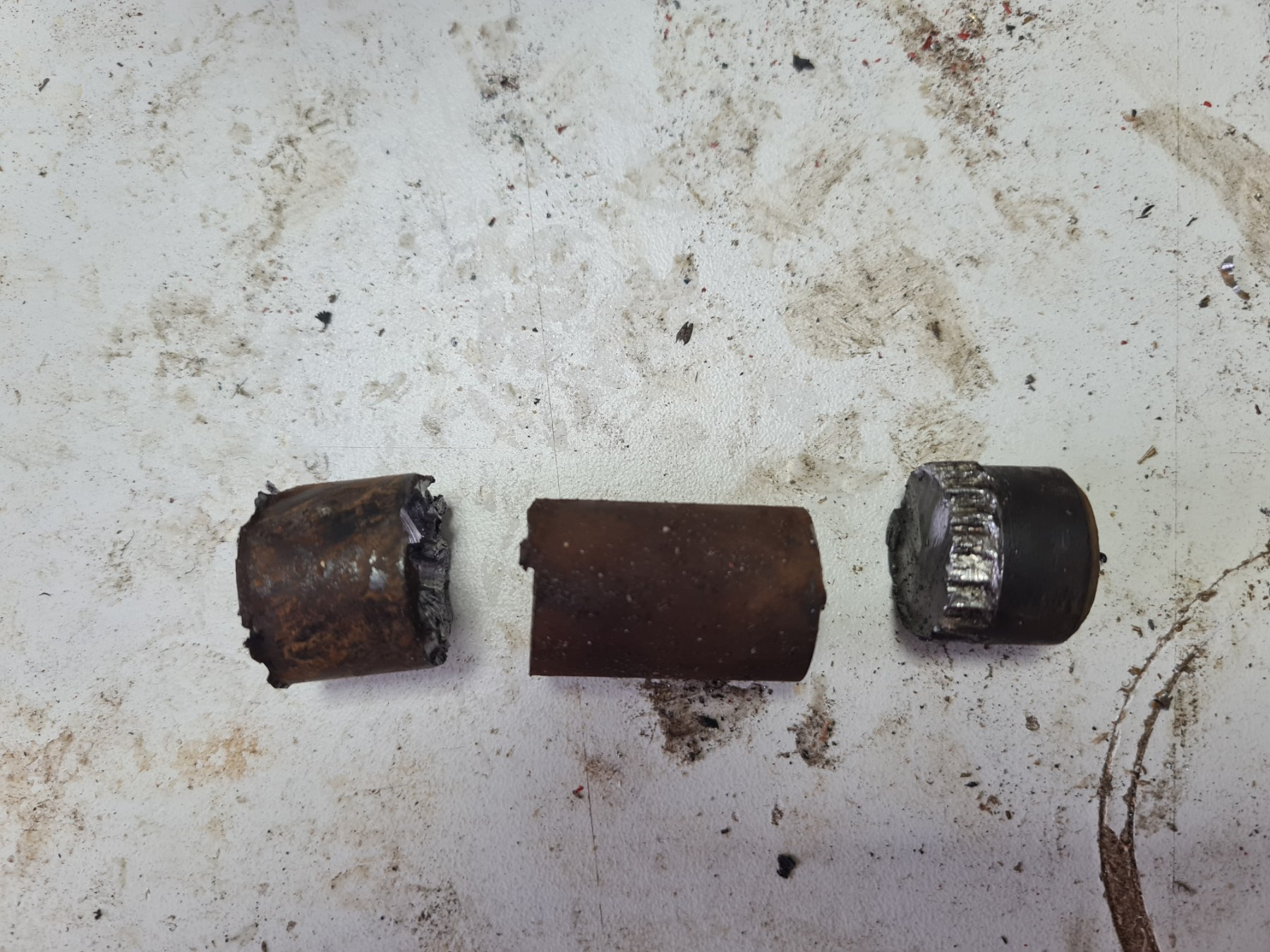

Especially since the attachment of the "arm" of the tractor suffers all the force and at the same time there is no grease gun on this tractor..... Here is an example of what it looks like in the end. It took us 5 hours to take it down without causing major damage
