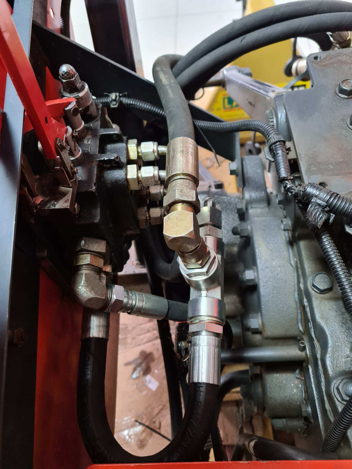

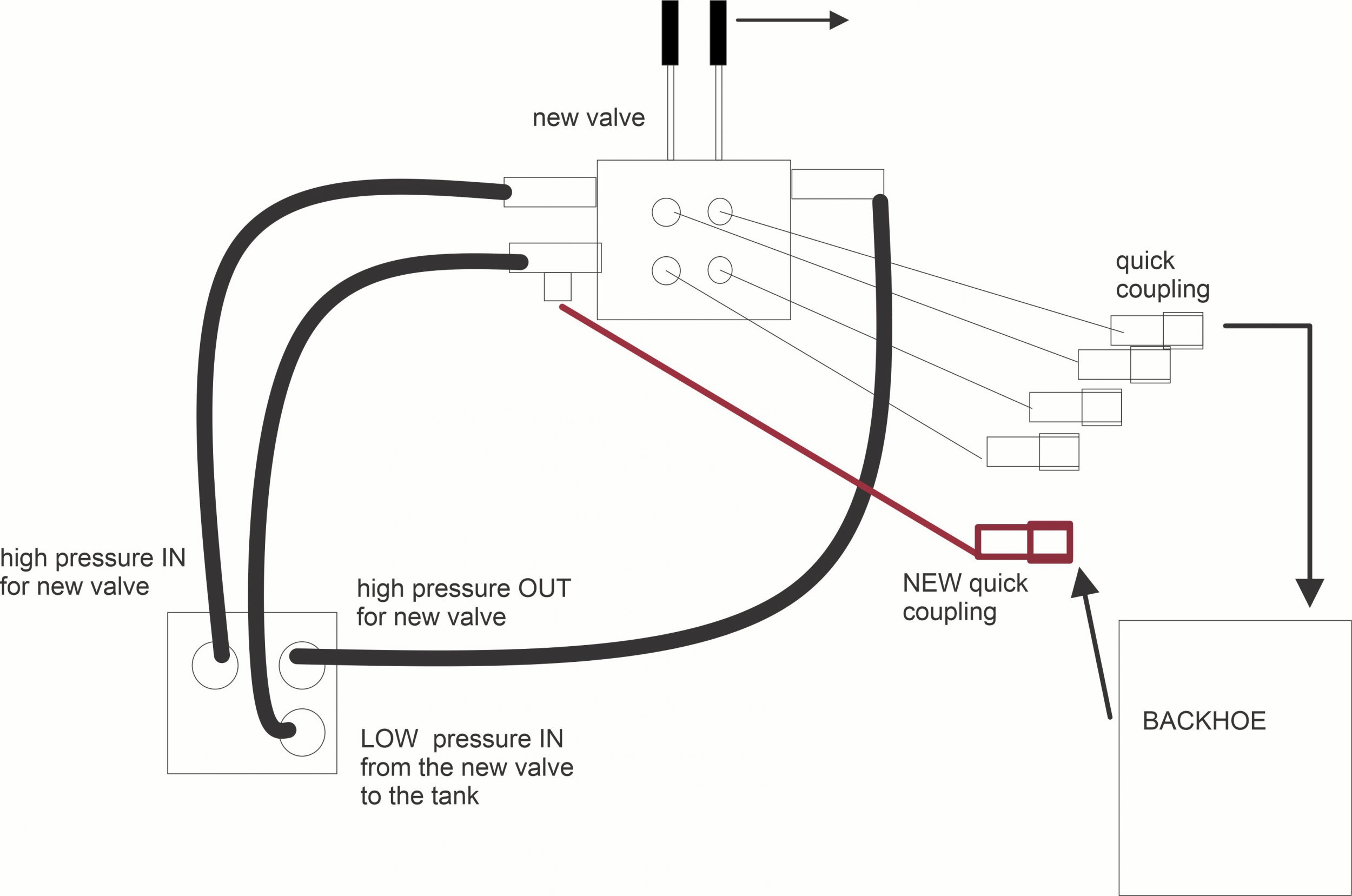

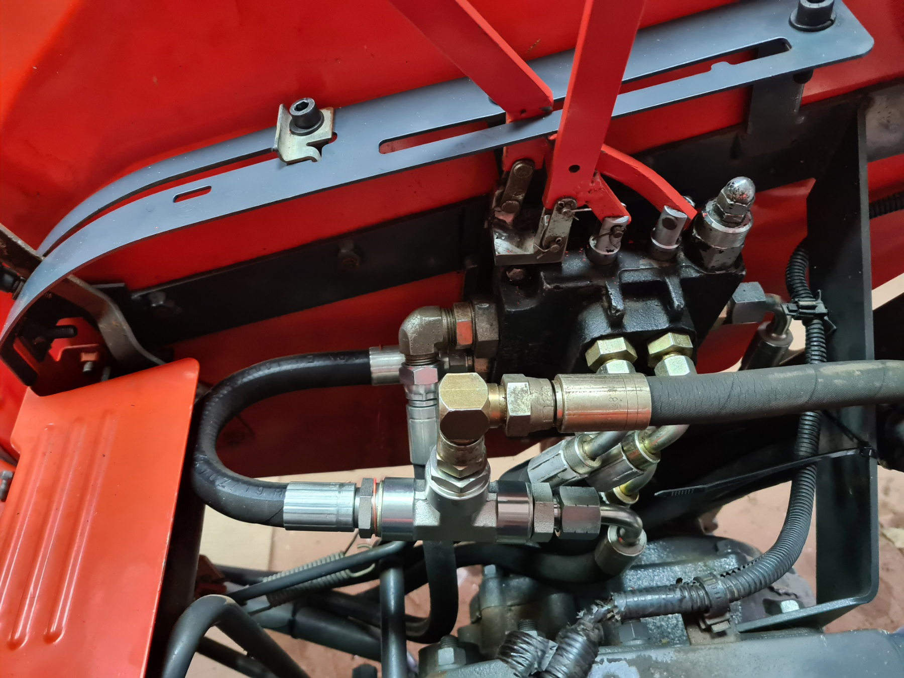

By some logic we put in a T piece and made an extra inlet in the LOW pressure inlet (to the tank) hopefully that's ok. With one way of the cylinder for the trailer, we think that the same hose will return the oil through the LOW pressure outlet, when pressing the handle to the other side. Now from the T exit we made a new quick coupling, which in this case is the RETURN from the ditch. With the fact that the handle of the NEW valve must be turned on in order to give pressure to the backhoe. All this is logic, we are not sure how accurate it is..... Hamza's father ......sorry for my bad english

In my case, since I'm using a double acting cylinder as single acting, I only run one hose from the remotes to the cylinder. The non used port of the cylinder has a breather. It can't be plugged.
In Hamza's case with the backhoe, he can simply plug the backhoe to the new remotes (nice and clean install btw) and hold the lever with a bungee cord or fabricate some kind of holder for the lever.
The only thing to keep in mind, is to make sure in whatever direction the lever is pushed, the fluid must enter the backhoe valve using through the P port of the backhoe valve, because there is the risk of feeding the backhoe using the Tank port which is a bad thing.

I understand so i need to connect backhoe on high pressure OUT and higH presure IN not LOW PRESURE OUT ?
The father post the scheme up you can see there how we connected it right now
We connected it on LOW pressure out !!!
Not correct ???

This is a good way and the safest way to do it. Pressure out of the remotes to the backhoe and a direct Tank route from the backhoe to the tank/transmission of the tractor. Mark the quick disconnects so you can't accidentally swap them and you're good to go.
For the dump trailer. What happens with a single hose cylinder is that, when you're lowering the dump trailer, you push the lever the other way and you're now pressurizing the other port on the remote you didn't use to the relief pressure until the dump trailer is all the way down. This tends to put extra heat in the system, however, it's usually a short duration so it's not an huge deal, specially if you keep the engine at idle so it pushes less flow through the relief valve.
For the dump trailer only - Since you're already have a quick disconnect directly to the Tank, you can have a short hose made with quick disconnects that will connect the non used remote directly to the tank so you don't push fluid at max pressure through the relief when lowering the trailer.

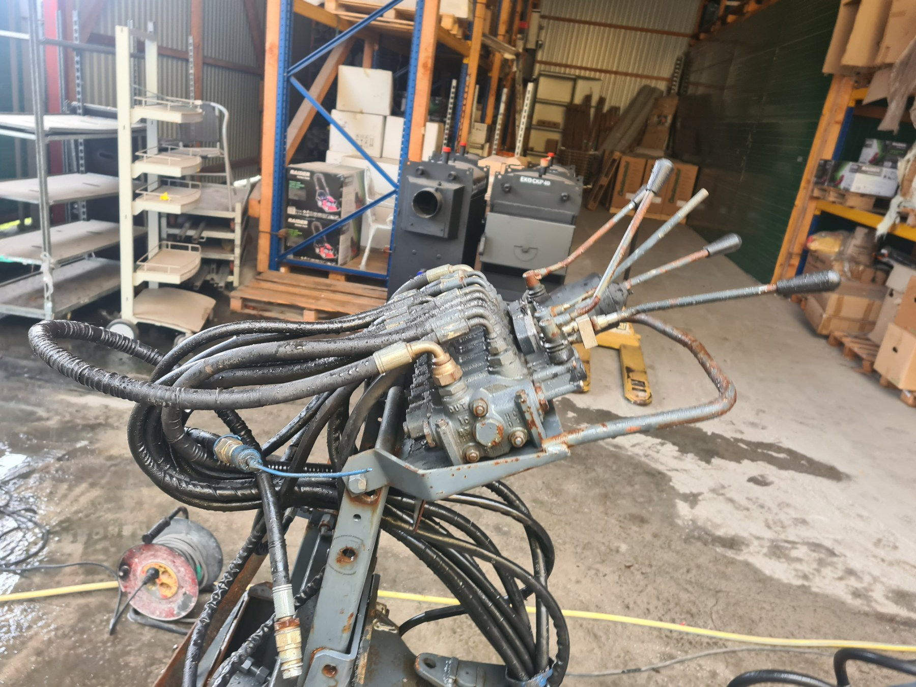

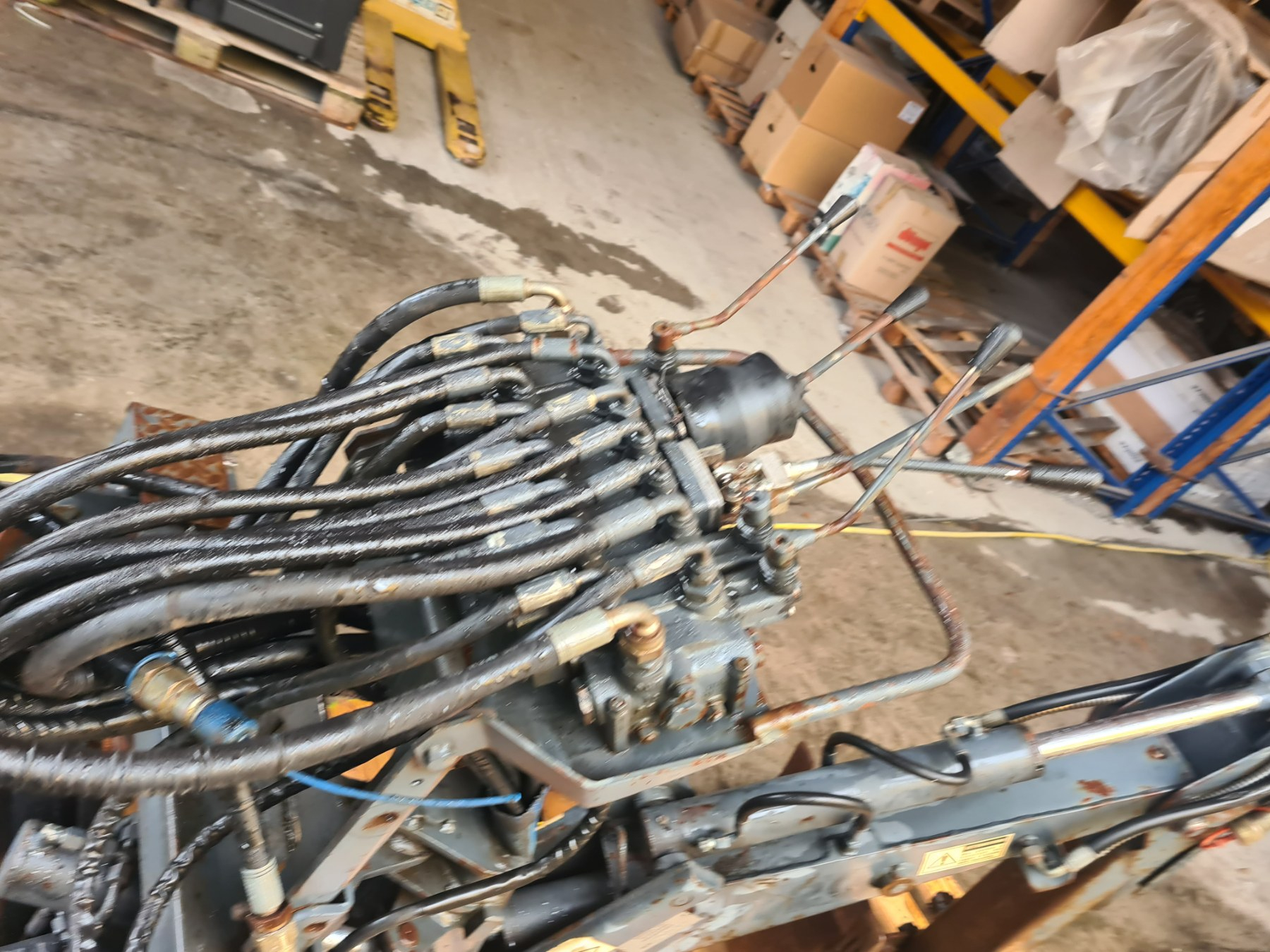

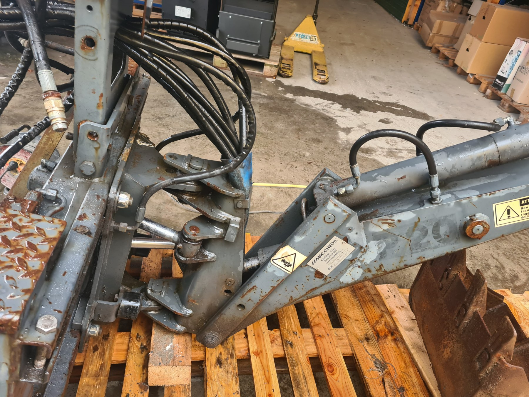

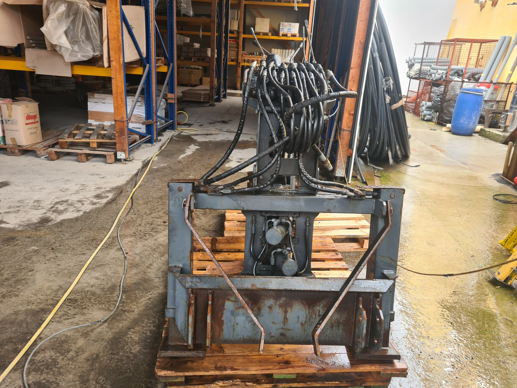

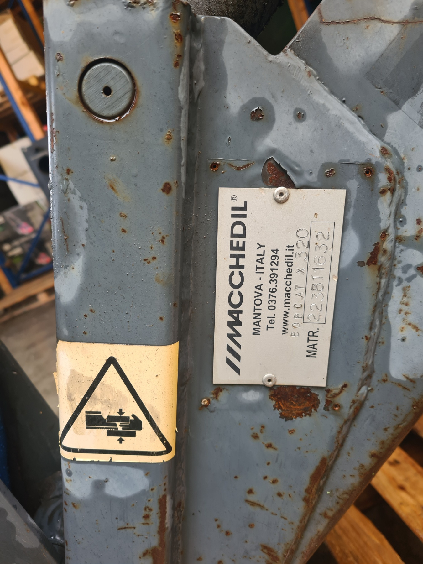

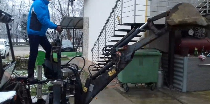

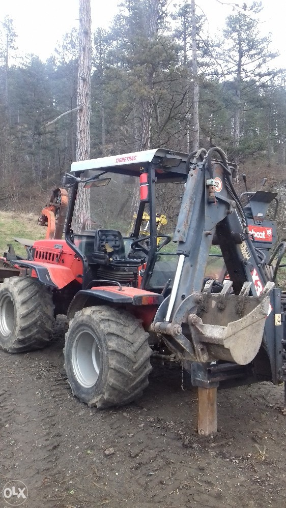

I will attach pictures here of my backhoe
*Bobcat X320*
Little background story
"I bought it used the previus owner used it on antonio carraro *he also needed to hold lever on valve to use it* we tried it while we were buying it and it worked well it has 2 hoses that need to connect to the tractor. When we bougt it we didnt know that this fluid return can be a problem so we didnt ask him how did he solve that but he was using diferent tractor i think he culdn't help as anyways... because antonio carraro has difrent hydraulic sistem.

Read the markings on the valve. I can see on the 4rd picture that it's marked with Out. That should be your return. I would like to see a picture from the other side to make sure that's indeed the Pressure In.

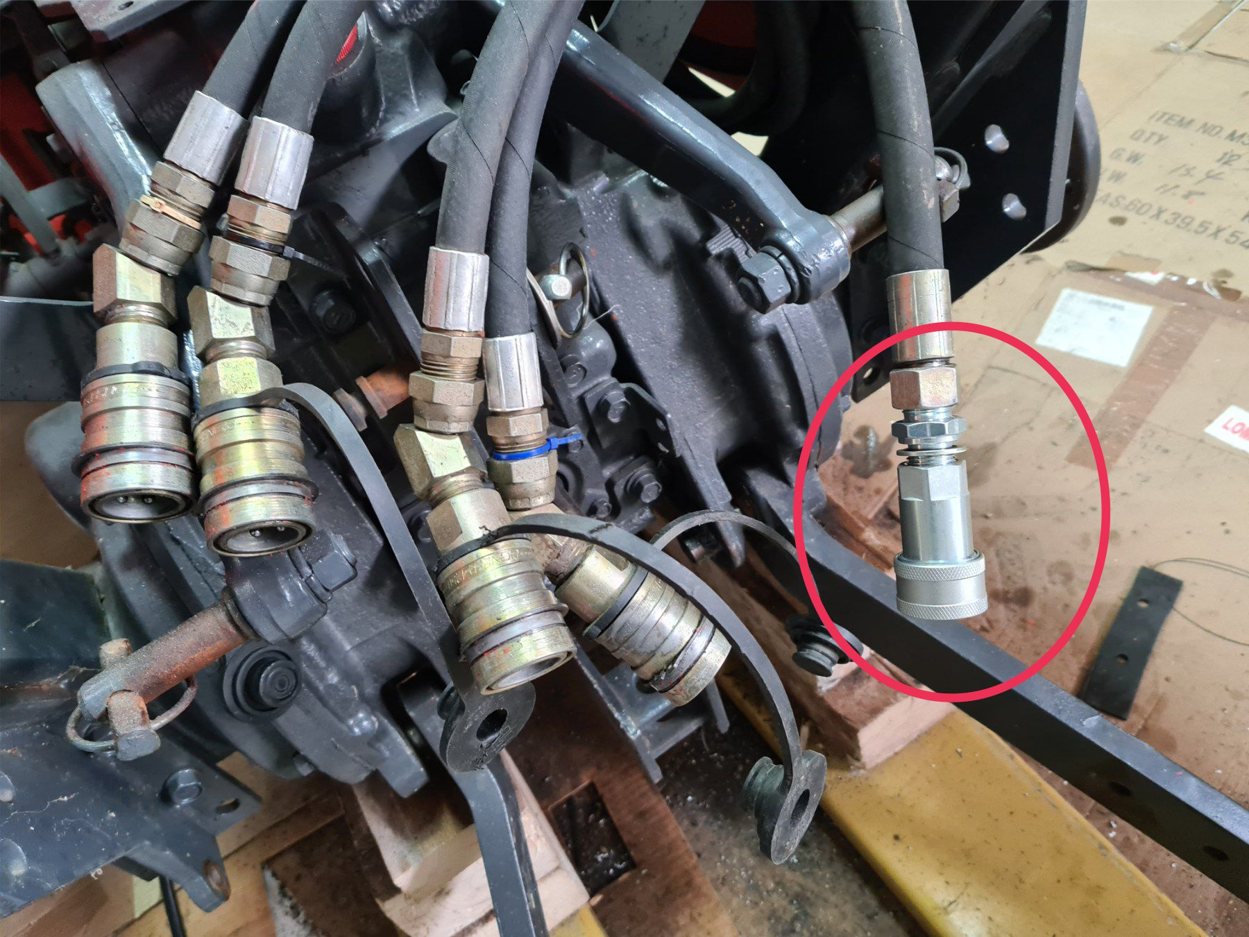

You are sure about this red section that i marked in red ?
Im not taking youre opinion into question but i want to double check it
Because im affraid to damage something like " making huge pressure in oil tank and making boublles in it"
You are saying that i need to connect to low presure return not on high presure return am i correct ?

Follow your Dad's diagram on post #21. That will work perfectly fine for the backhoe.
